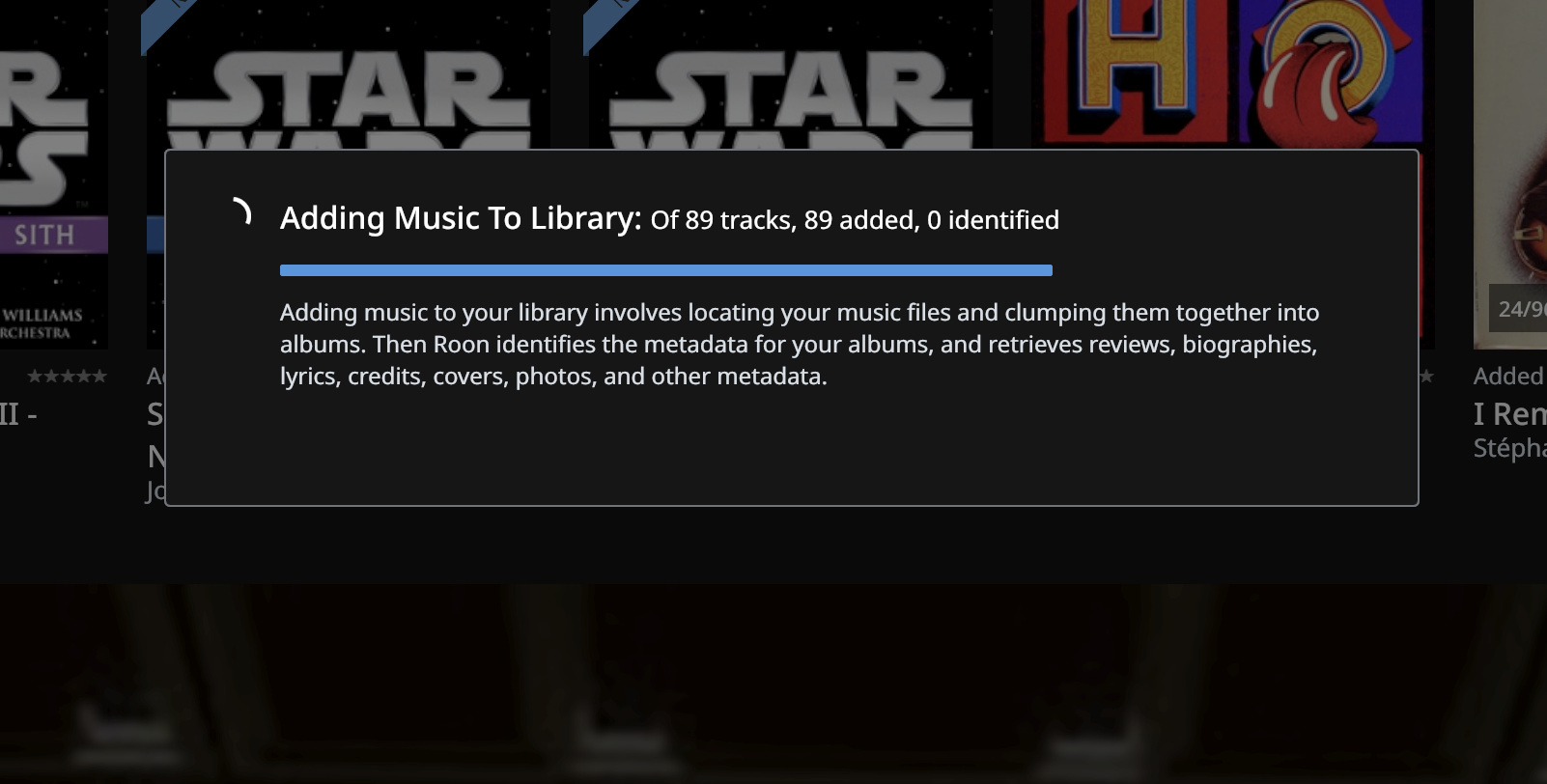

After adding 5 albums into my WD 8tb USB attached drive wired to Nucleus a few things:
Spinning icon in upper right of Roon app when opened shows what I’ve attached. The 89 files represent all that are on the 5 albums. Strangely, when I open and play any of these there are no issues playing. And the screen each album shows album art, proper listing of tracks, correct queue of tracks, etc. However, if I attempt to edit any album, not just the ones added, and say, identify the album I get blank entries and if I do any searching I get no apparent hits (seems to suggest a bogus internet issue).

Going beyond simply rebooting the suspect Eero, I restarted the whole Eero network (I have 5 Eero WAP devices). That seems to have done the trick. “About” now shows no problem with correct version/update, as does Account info. However I’m making no progress on album identification, which was the last bit running when this all began to happen:
Is there something wrong with your servers or is there anything I should alter on my end to either speed up or force completion of this task?
