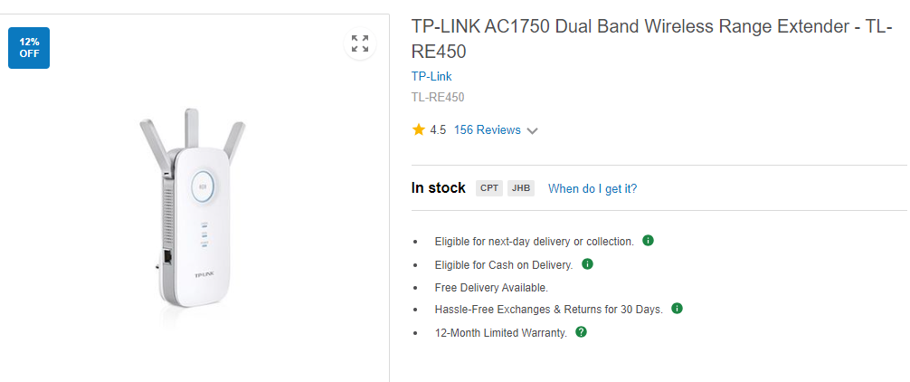

Another option might be a wireless bridge, which connects to your wifi wirelessly and has an Ethernet output that connects to the Hegel. Like this:
If you have a mesh wifi, then devices like that may be available specifically for your mesh brand.

The Nucleus sits under the Hub/router which is the opposite end of the room from the Hegel.I will look into the Wireless bridge, could be the answer.Thanks

Do you have a Wi Fi extender with an Ethernet connection, as a test you can plug it in near the amp and run a short Ethernet cable I have used this before now to achieve this . Bottom line a cable will b more reliable in the long run
HI Mike
I did wonder about that, but wasn’t sure if it would work
Thanks
