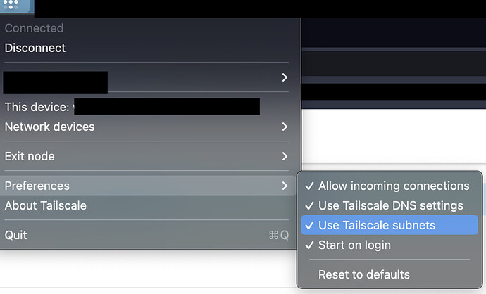

Also, realizing that toggling “Use Tailscale subnets” seems to be the best way to get Roon to see my audio zone, rather than disconnect/reconnect.
