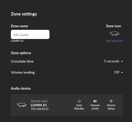

Switching on the Crossfade time causes “Tidal media is loading slowly…”
Has anybody experienced the same?
I have never had the problem with Tidal data flow speed, not with Tidal app, Moon app, Lumin app nor Roon – until switching on the Crossfade time to any value from 1 to 10.

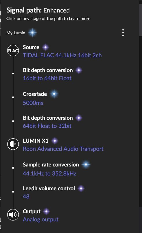

After that all MQA tracks (not FLAC files) will be interrupted in first 5 - 6 seconds, saying: “Tidal media is loading slowly…”. With Crossfade time setting to ON accompanies Bit depth conversion from 16 to 64 bit and from 64 down to transport device suitable 32 bit. I like the sound that this creates. All filters are disabled.
Can it be the bug in processing chain? The bit depth conversion shouldn’t affect data flow speed from outside, just processor load, isn’t it?
Processing speed in my case is around 30x.
