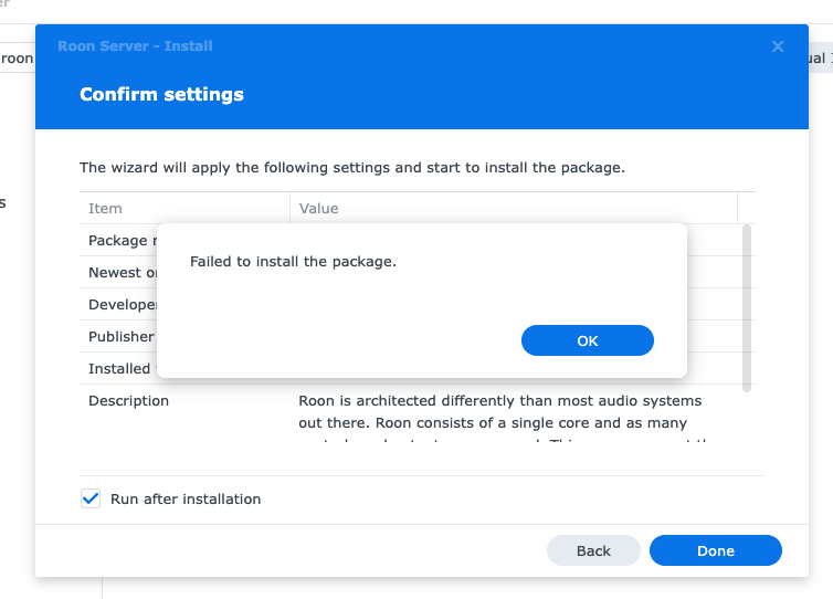

Any luck there? I’ve got the same issue.

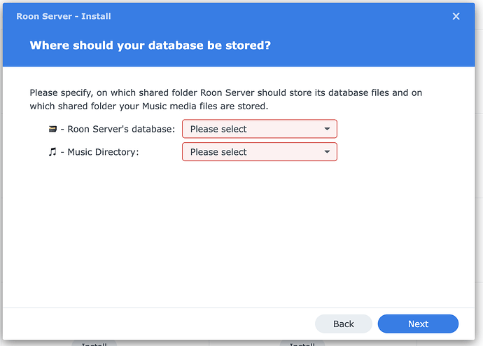

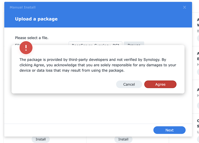

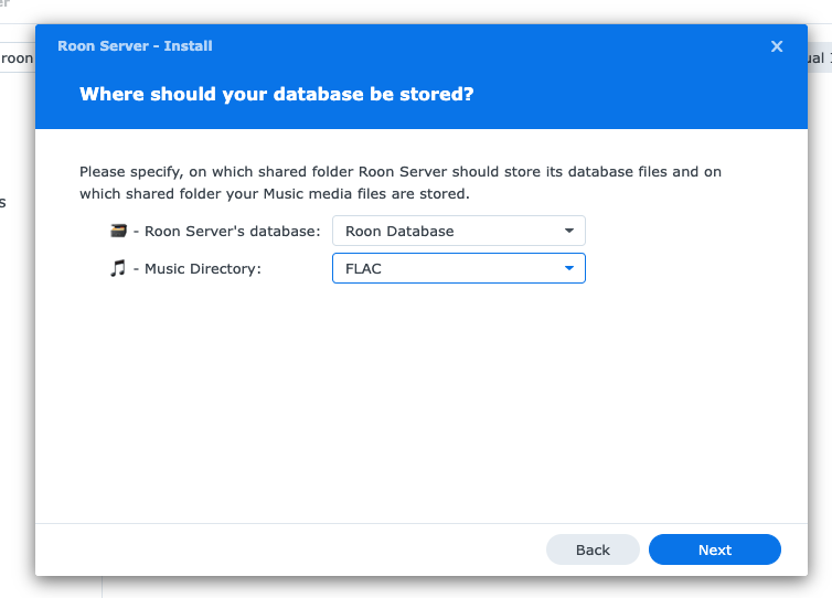

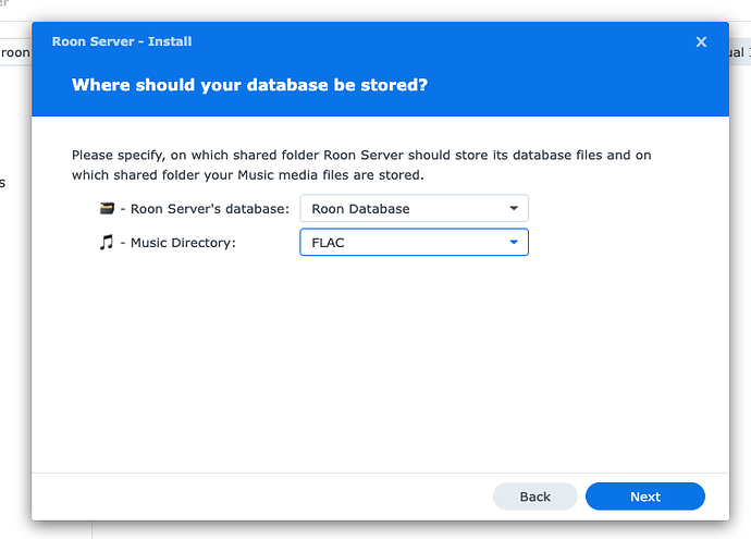

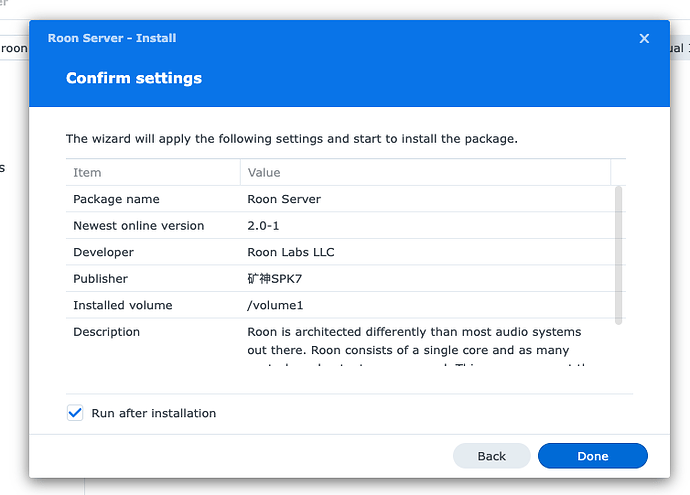

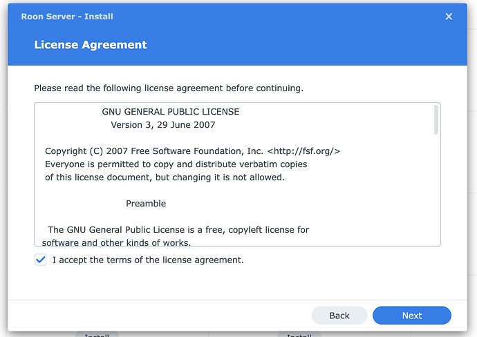

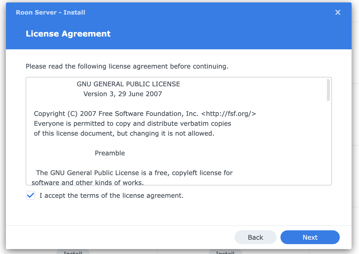

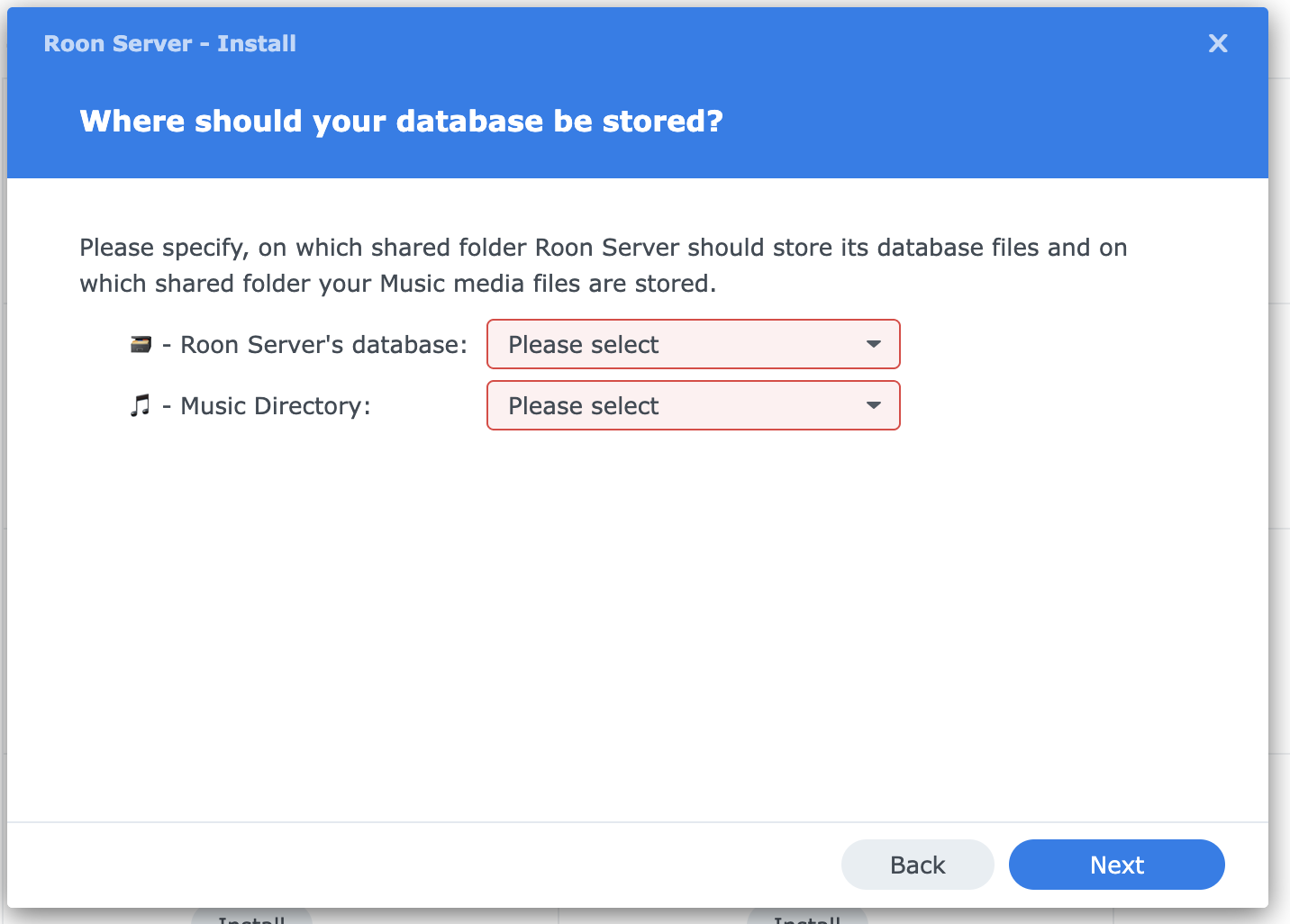

Process seems to work OK for me on DSM 7.3 at least up to this point:

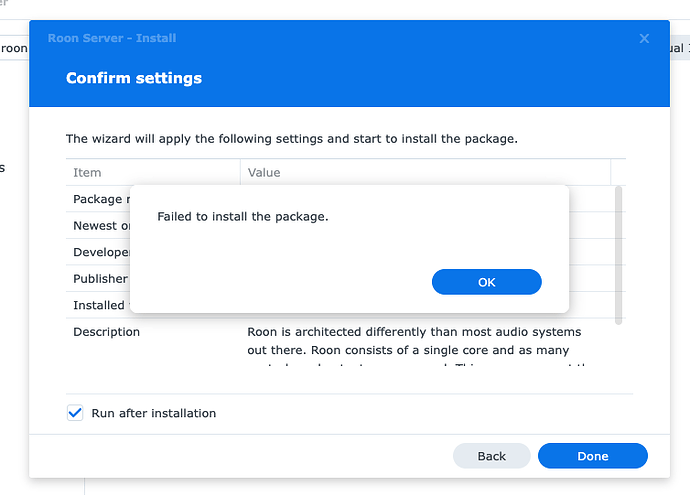

No problems getting that far. Once I have selected the directories and go to install it just says ā€˜installation failed’. Tried online and manual install too.
