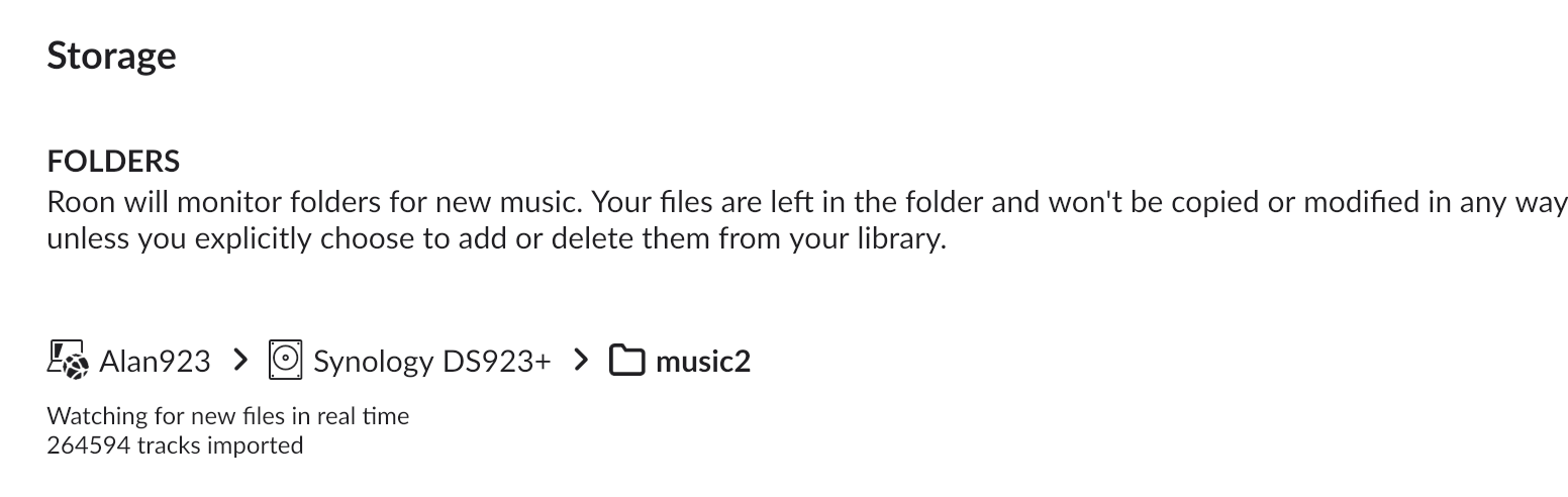

Can you share a screenshot of your Roon Settings → Storage view? Perhaps these are tracks or items you have added to your library and since removed but the stale links still exist? I’d also double-check the number listed in your Roon Settings → Library → Clean Up Library.
I believe your figures are correct, on the odd time I managed to get Roon to come on (deleted server, re downloaded, same happened) the numbers are similar to this. However I have no idea why I am suddenly seeing this many ‘tracks’, as stated above Roon is pointed to a music library of only 260 ripped CDs and is also connected to Tidal.

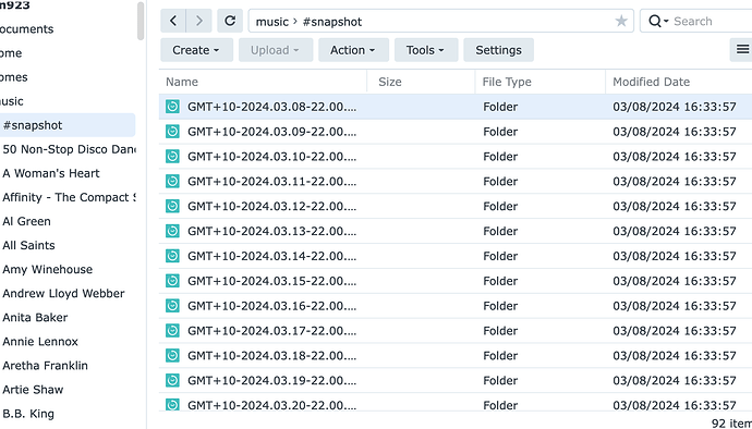

Next I looked at my music folder on Synology and noticed it was doing frequent snapshots, with around 90 in the folder.
I moved the music to a new folder, deleted the old one with the snapshots and pointed Roon at the new folder.

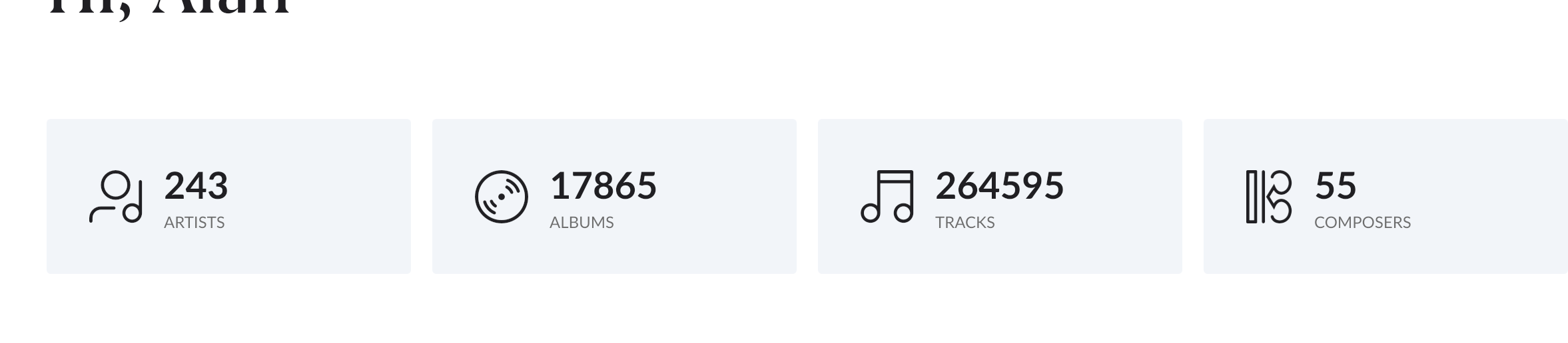

Things are a little better (not back to normal but better) but to my surprise Roon looking at the new folder with 260 CDs still reports that I have 264K tracks, and the number of albums has gone up by 1000 since the other day!

Fingers crossed, I think I may have sorted this by switching to a new music folder with snapshots turned off. Since then Roon has been chuntering through, the numbers of albums and tracks slowly decreasing. Takes a while to sort itself out but currently looking MUCH better. Thanks everyone who chipped in!
Lesson: my music folder in Synology had ‘snapshots’ activated. This generated all those extra tracks (copies) and ground Roon to a halt.
