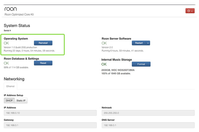

When did you install ROCK on the NUC and did the NUC still use BIOS mode at the time or UEFI mode? Because currently the Tailscale support is only for the UEFI-mode installs.
In other words, what’s the Roon OS version and build number of your ROCK?

That’s the Roon Server version, I meant the Roon OS version:

My mistake:
Version 2.1 (build 271) production

Sounds good, because build 271 was only deployed to UEFI-mode installations:
I am showing this on Rock screen

However, it is only avaliable on RoonOS 271. If, when you visit the WebUI page, it reports RoonOS version of 259 then you likely have your NUC configured for Bios boot and not UEFI boot in which case RoonOS will not update further and Tailscale is unavailable at this time. Try ‘reinstalling’. If it updates then build 271 you are good to go. If not, you mu
Once you are running RoonOS 271, you should see a Tailscale section on the WebUI age.
