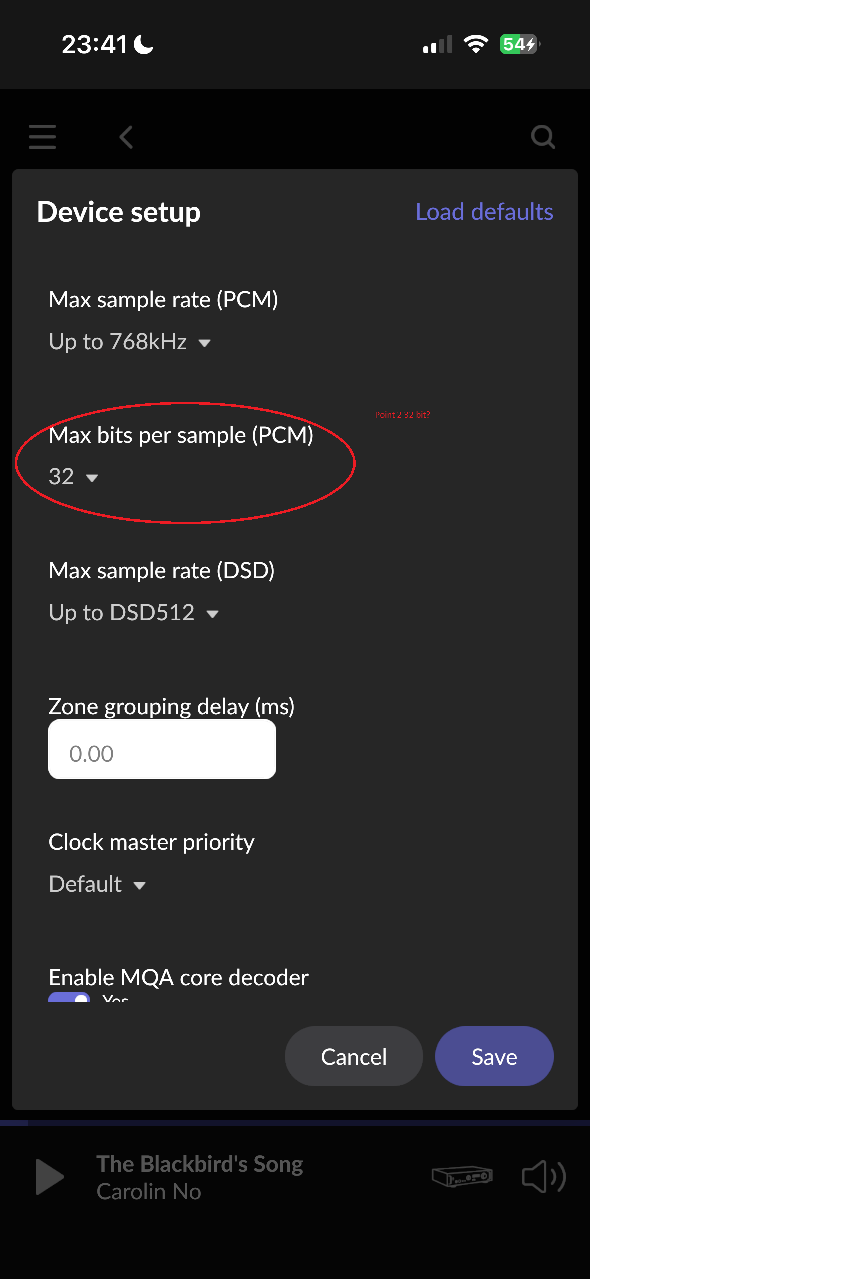

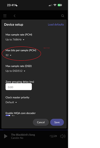

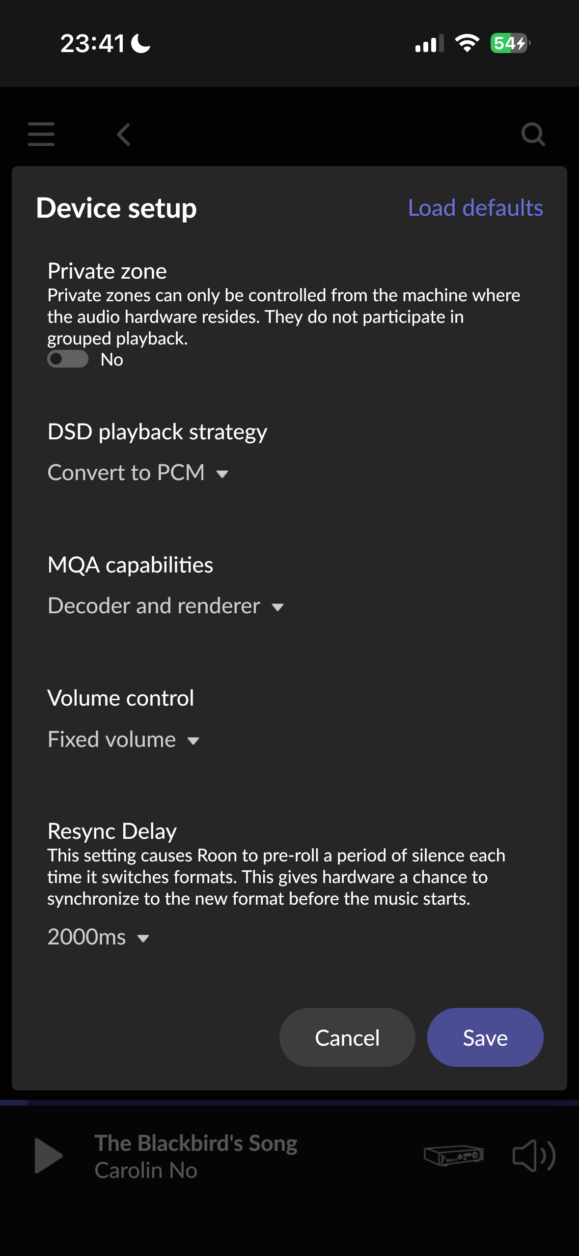

  2. I only have "Max bits per sample (PCM) in advanced settings ->32bit See screen shot.
    Volume is tested with fixed, variable, no difference. Activated Head room management, sound stopped (playing 44,1/16 via usb).
  3. Resync delay tested from 500 - 2000mS no difference. see screens shot
  4. Teac as a roon ready works perfect, no problem at all.
  5. I have tested Native, DoP, DSD and convert to PCM. DAC and SOtM stops communicating and needs to be restarted when using DoP and native. see screens shot

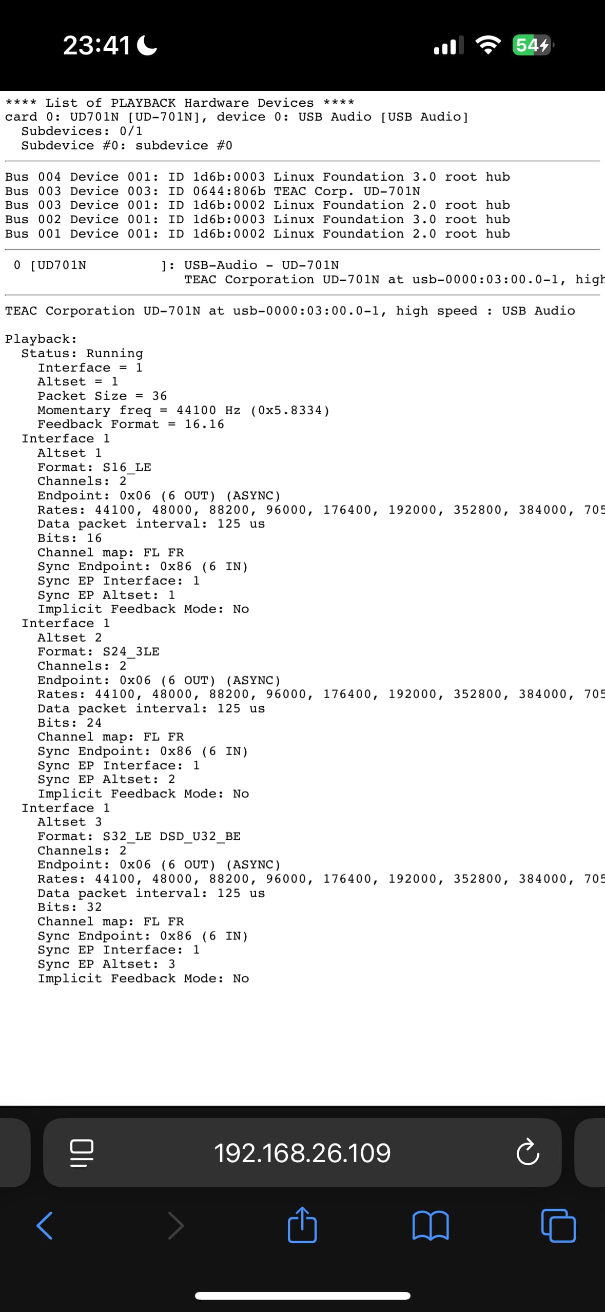

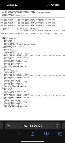

I have added screenshot from DAC page in SOtM, if it gives you more information.

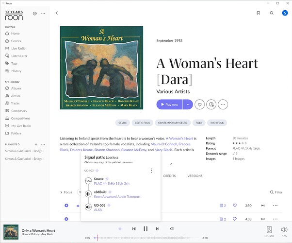

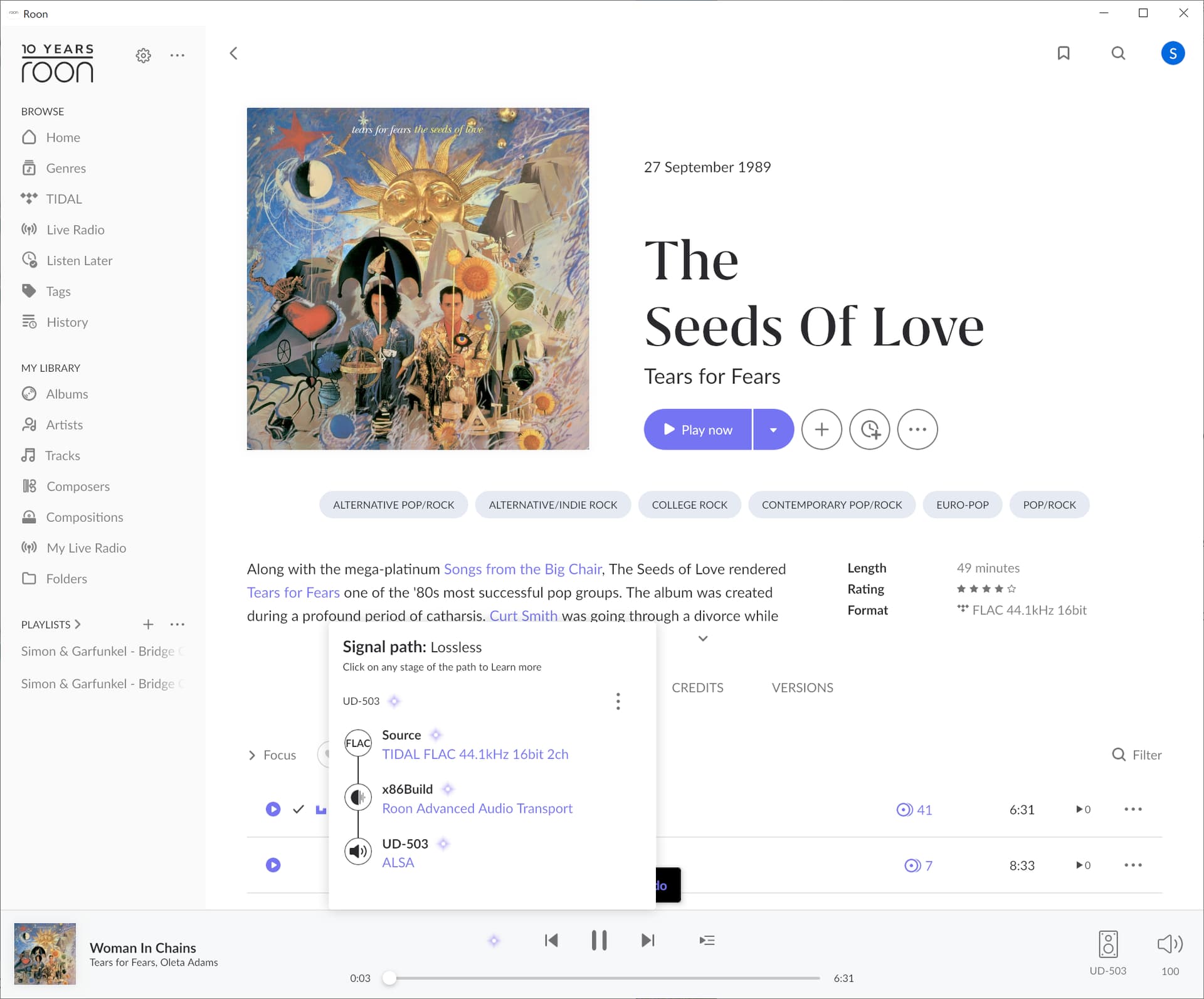

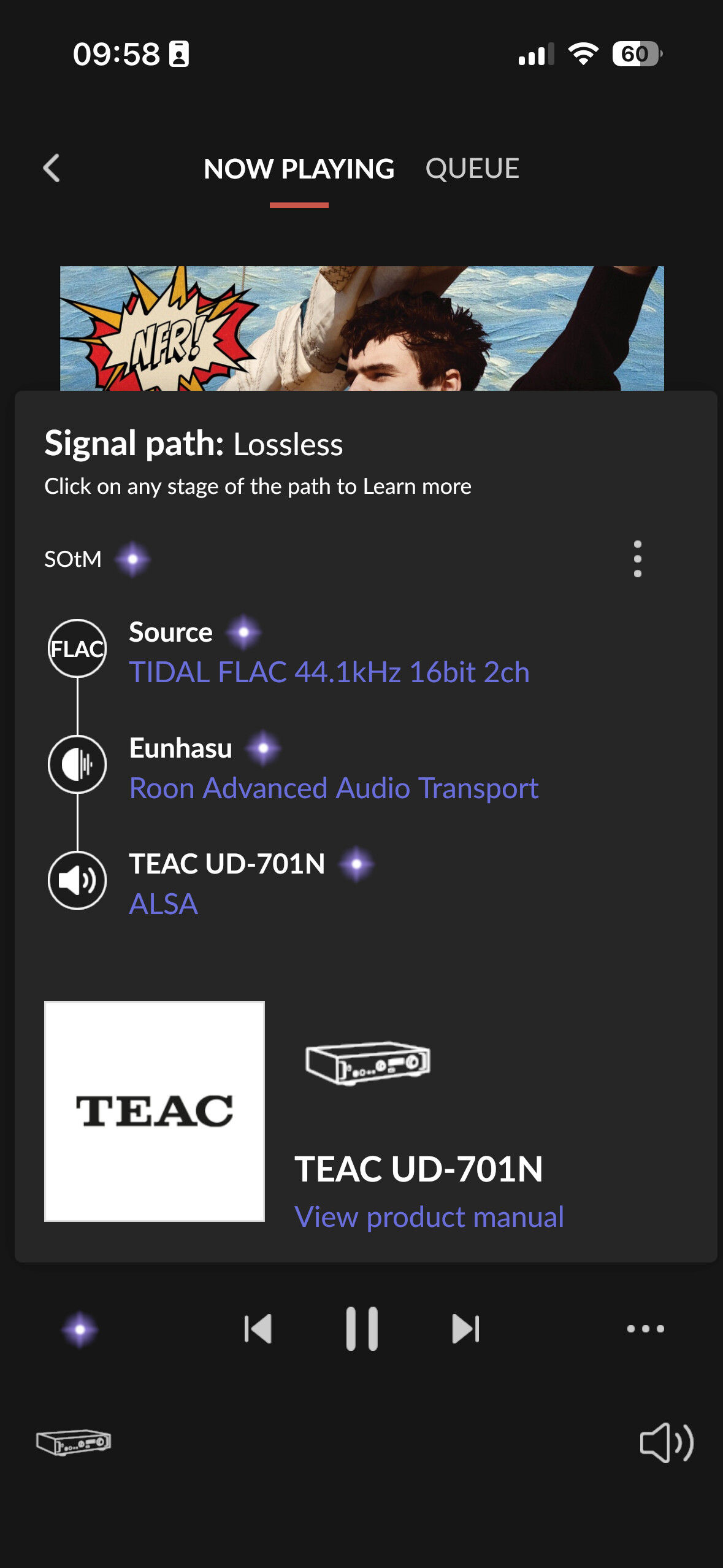

When we run Roon on our Eunhasu server and play 44.1kHz/16bit audio files, the screen looks like the following.
The upper image is when playing a local file, and the lower image is when playing via TIDAL.
In both cases, the signal is passed through directly as Roon Advanced Audio Transport without any conversion.
This test was done using a Teac UD-503 DAC.
It seems the issue lies in some kind of format change in the middle, so it’s worth checking the DSP settings or anything that might alter the signal path.
Also, when we look at the DAC information, it shows that this DAC supports S24_3LE as the highest bit depth.
That means in the audio settings, it would be more appropriate to set the bit depth to 24-bit instead of 32-bit.

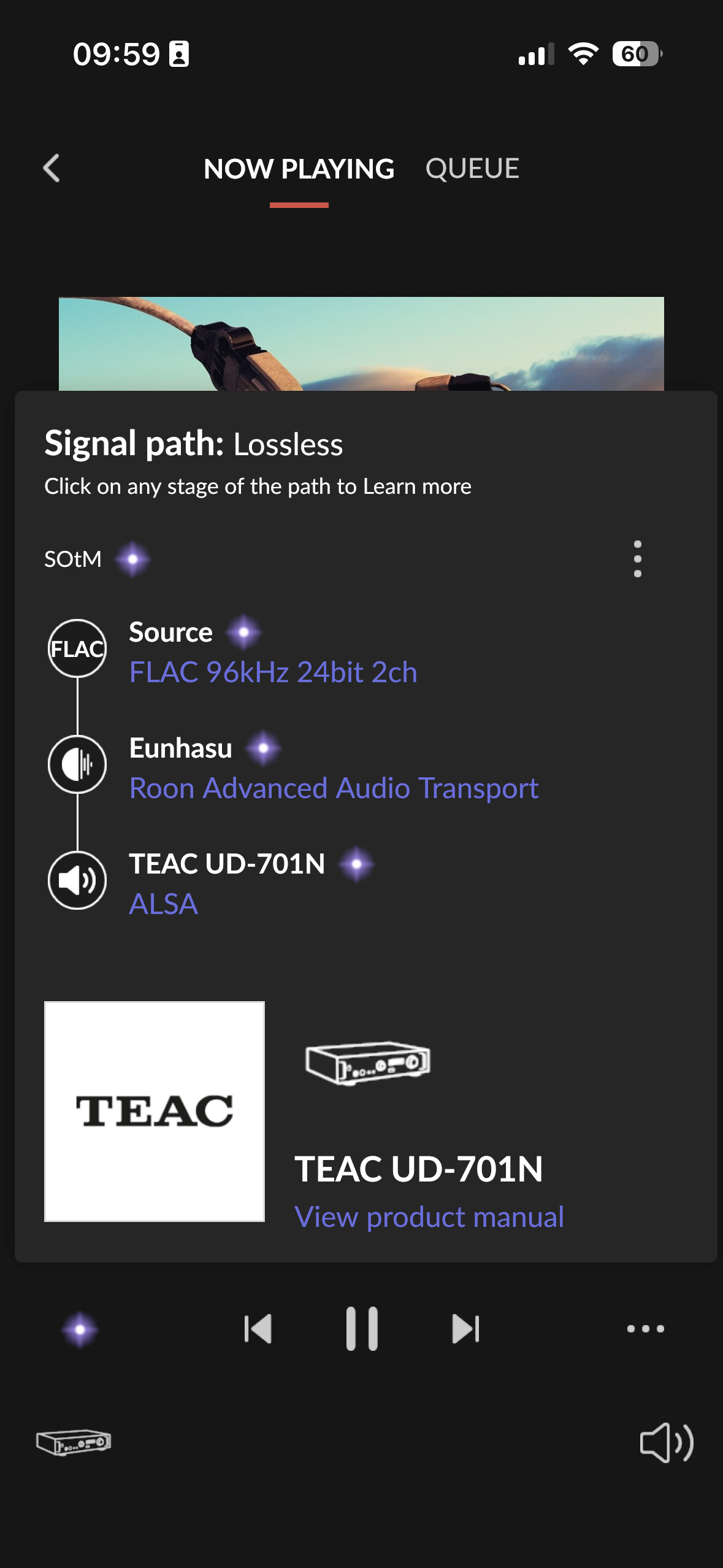

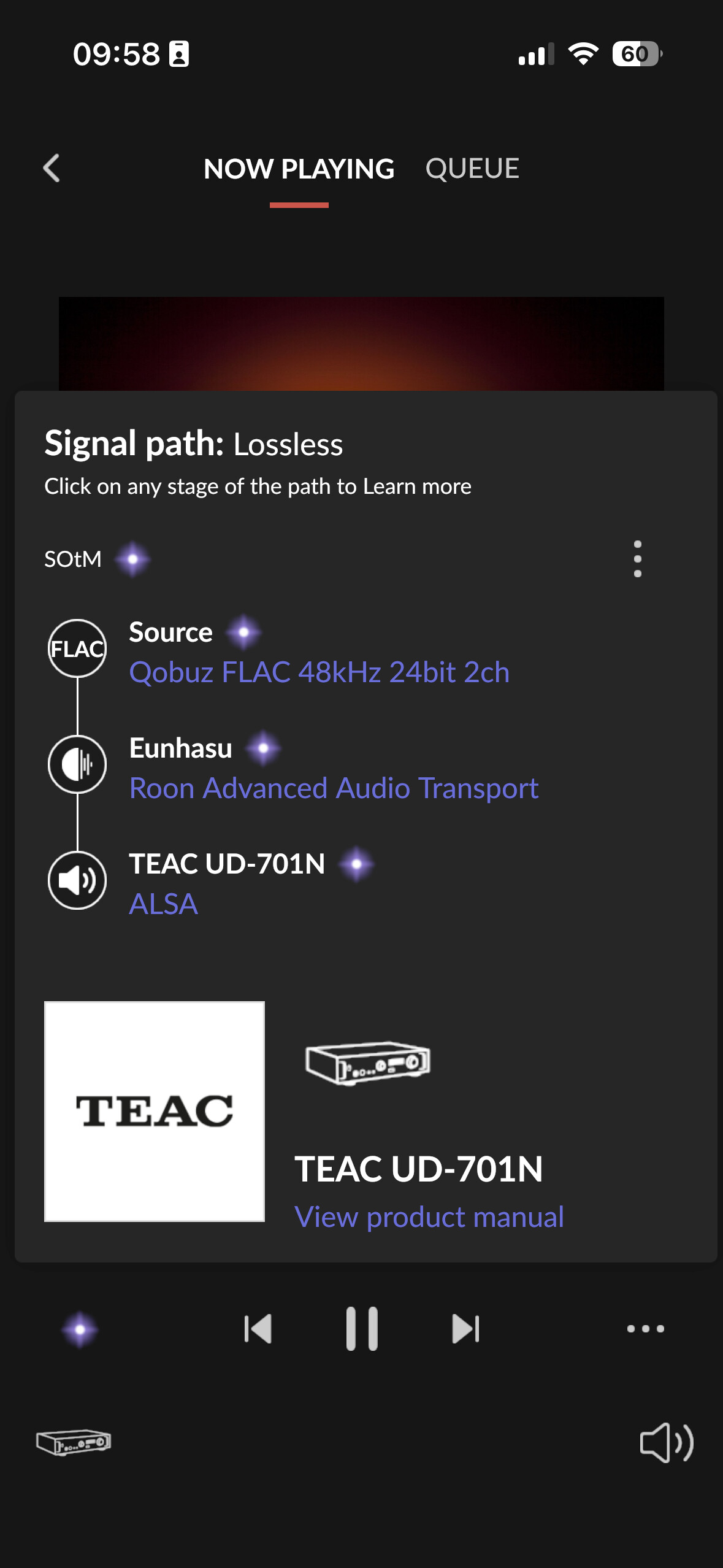

I have tested 24-bits in roon configuration and played the following.
Played 44.1/16 from Qobus → sound
Played 48/24 from Tidal → no sound
And 96/24 from harddrive installed in SOtM. → no sound

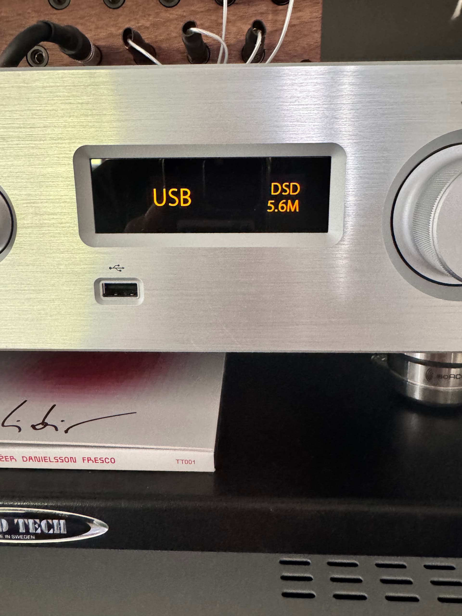

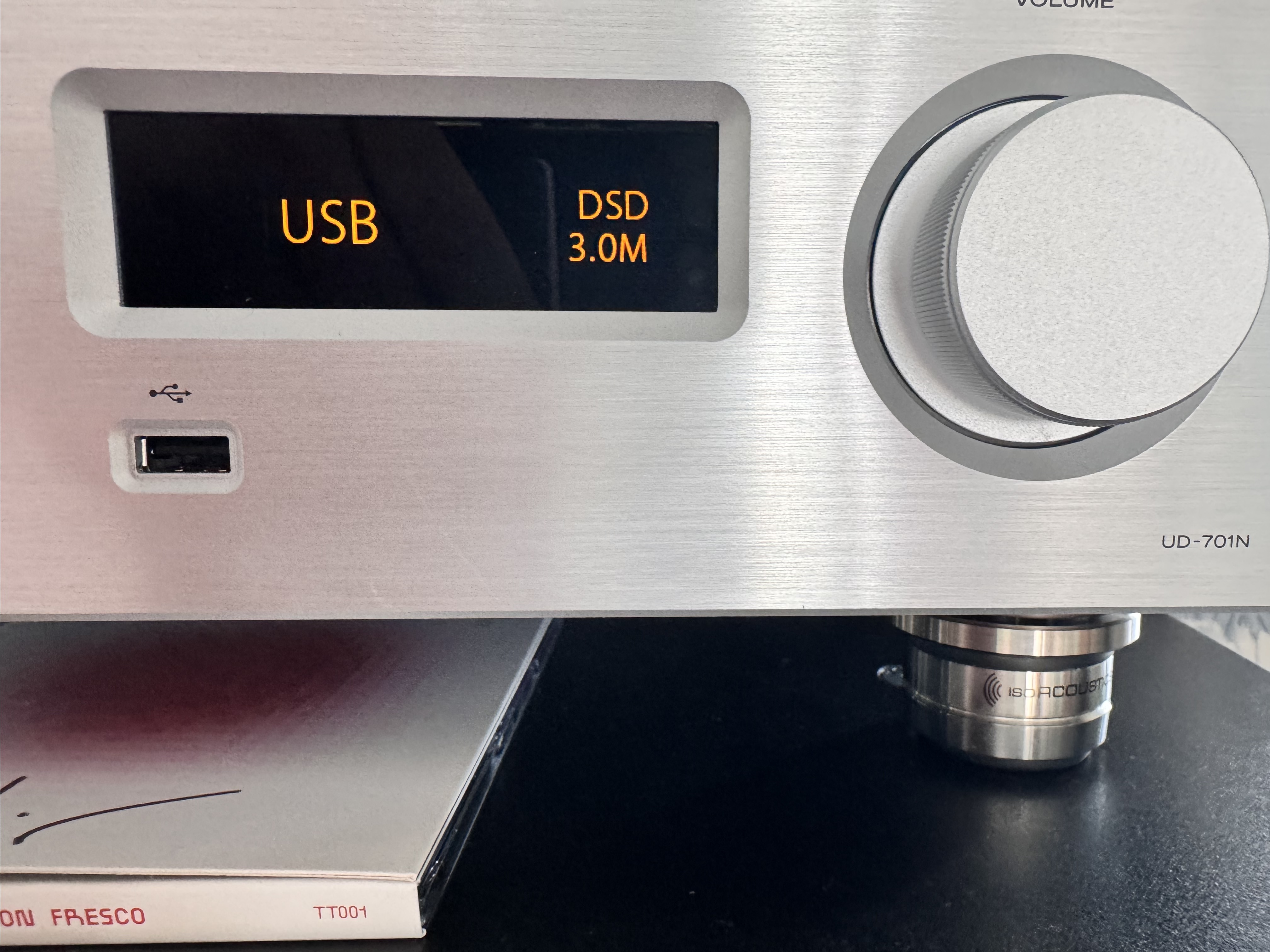

When playing from harddrive the teac show DSD 3.0M ?!?!

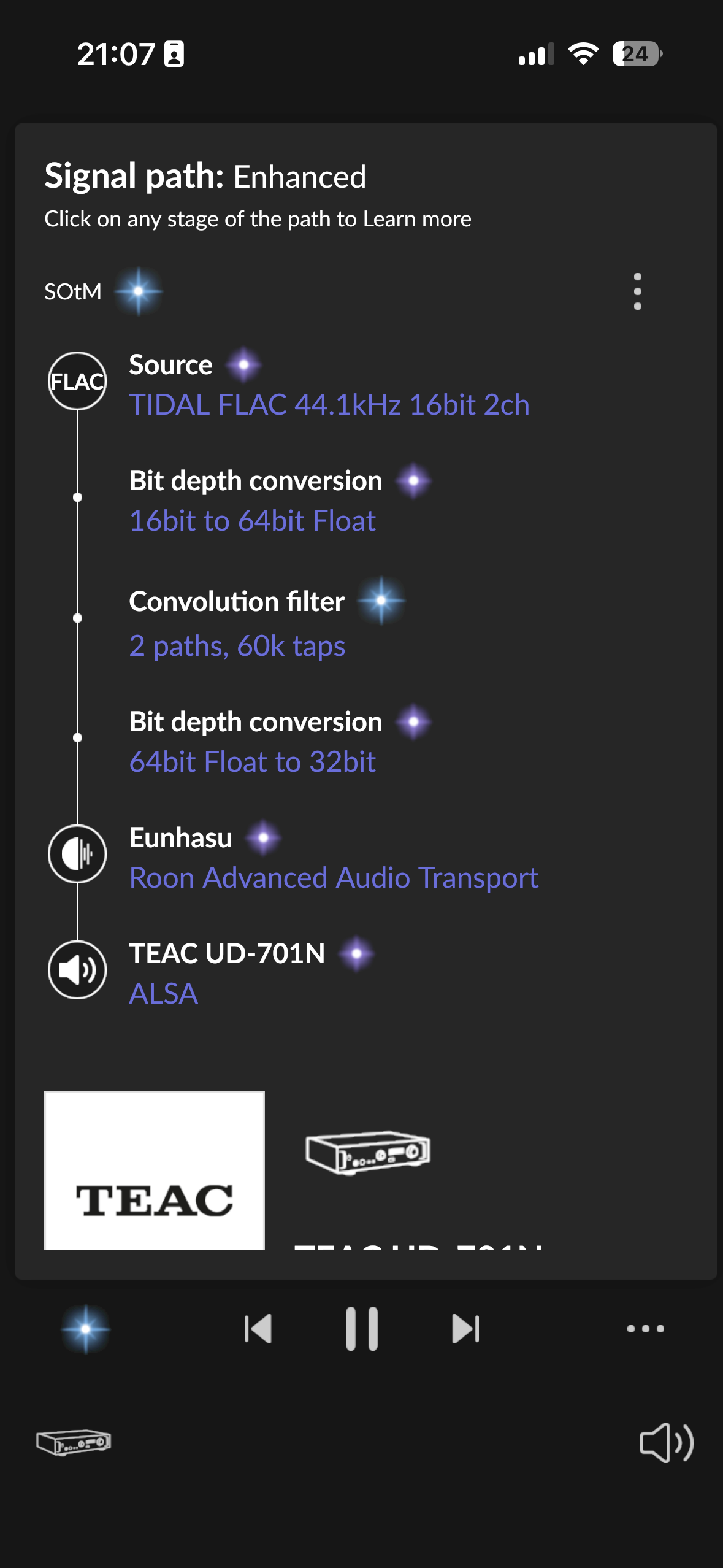

Pictures of signal path added.

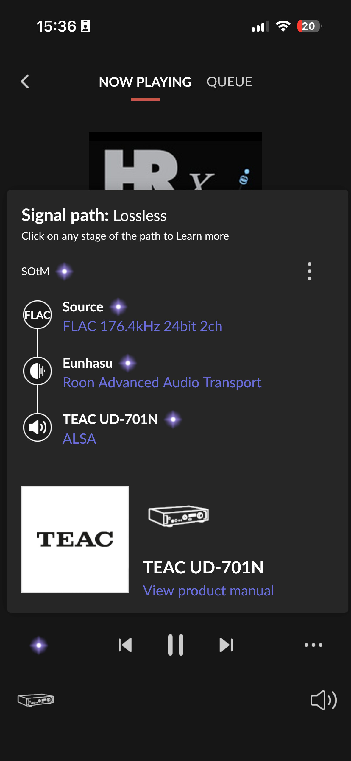

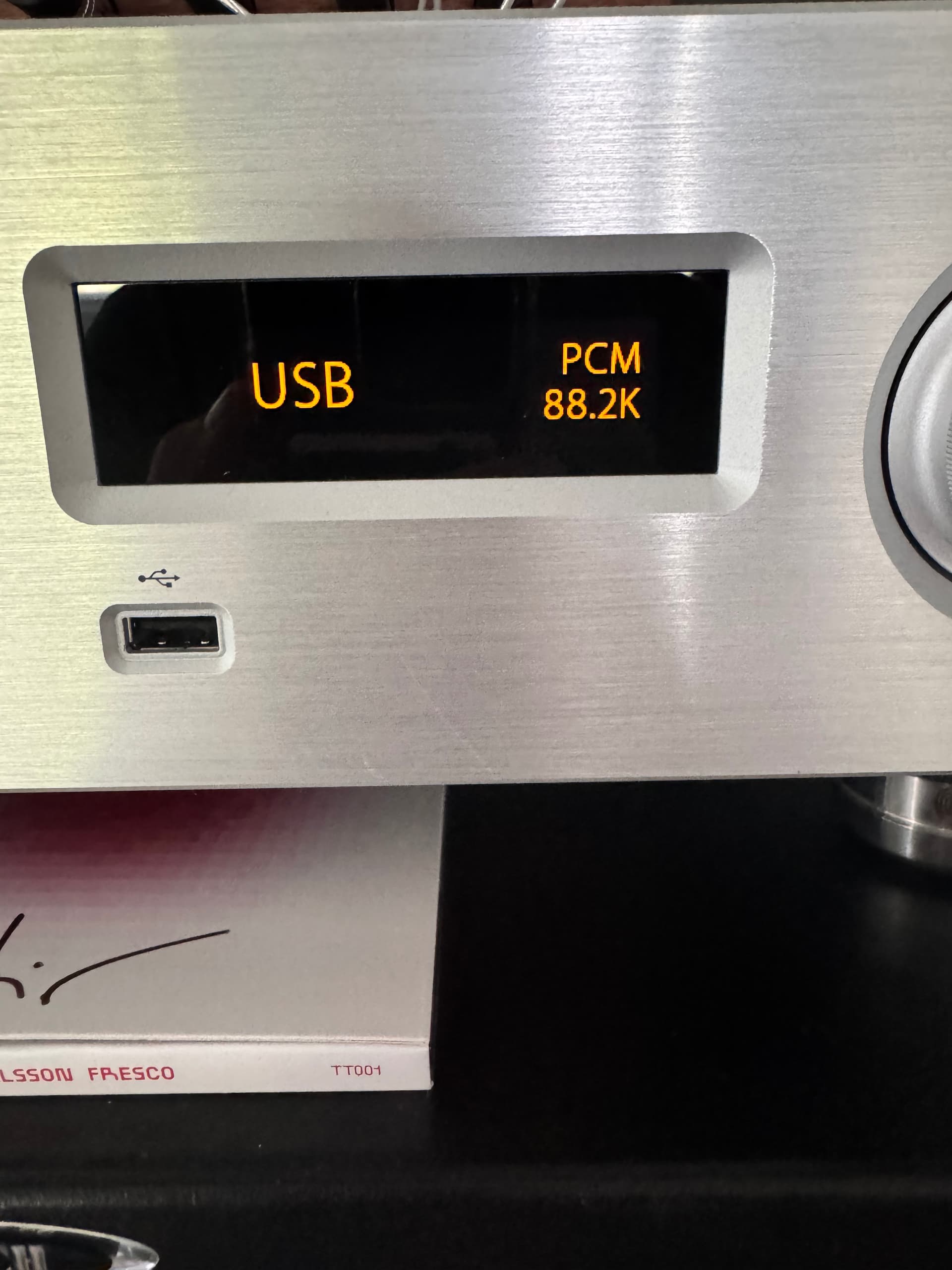

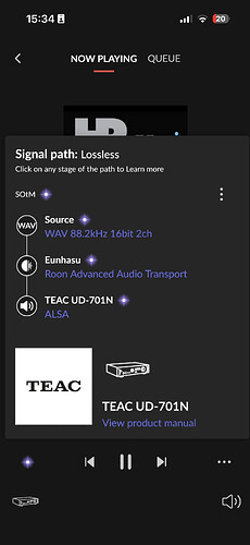

I have now tested the following:
88.2/16 works fine. Se picture of signal path and display of teac. I also activated convolution filter with same track, does not work. Teac shows DSD2.8 wit convolution filter active.
176.4/24 does not work. Se pictures,teac show DSD5.6. Tested same track also with convolution filter, same result, not working.
