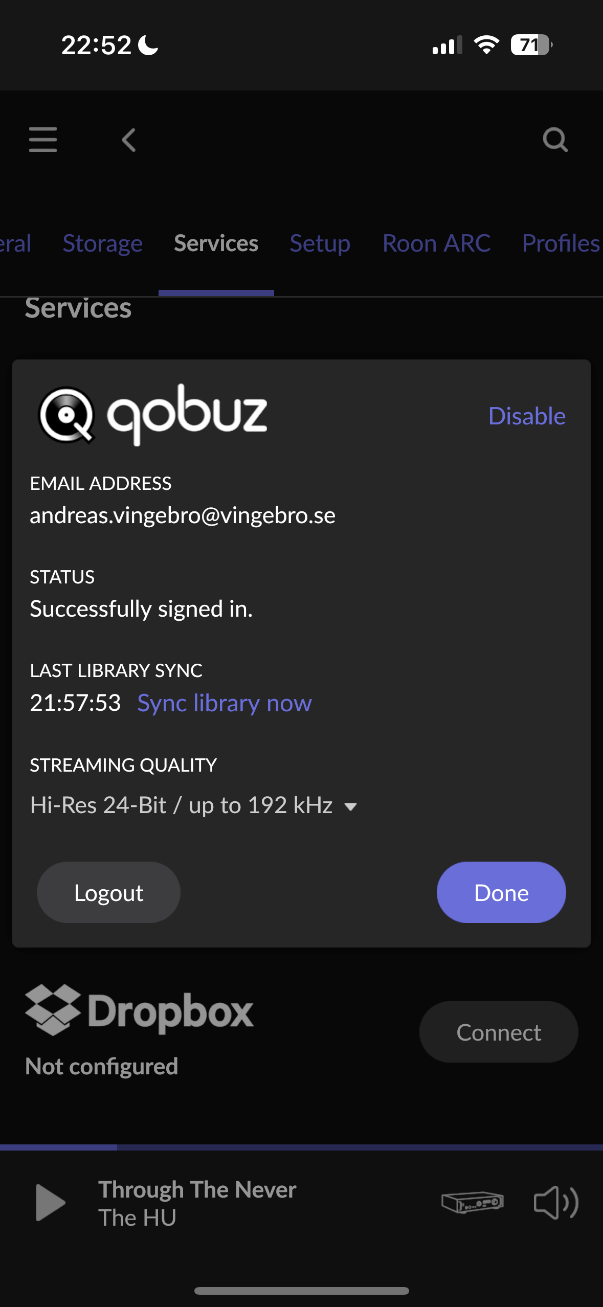

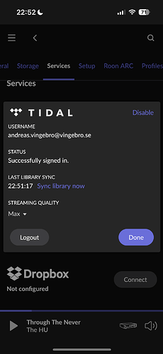

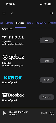

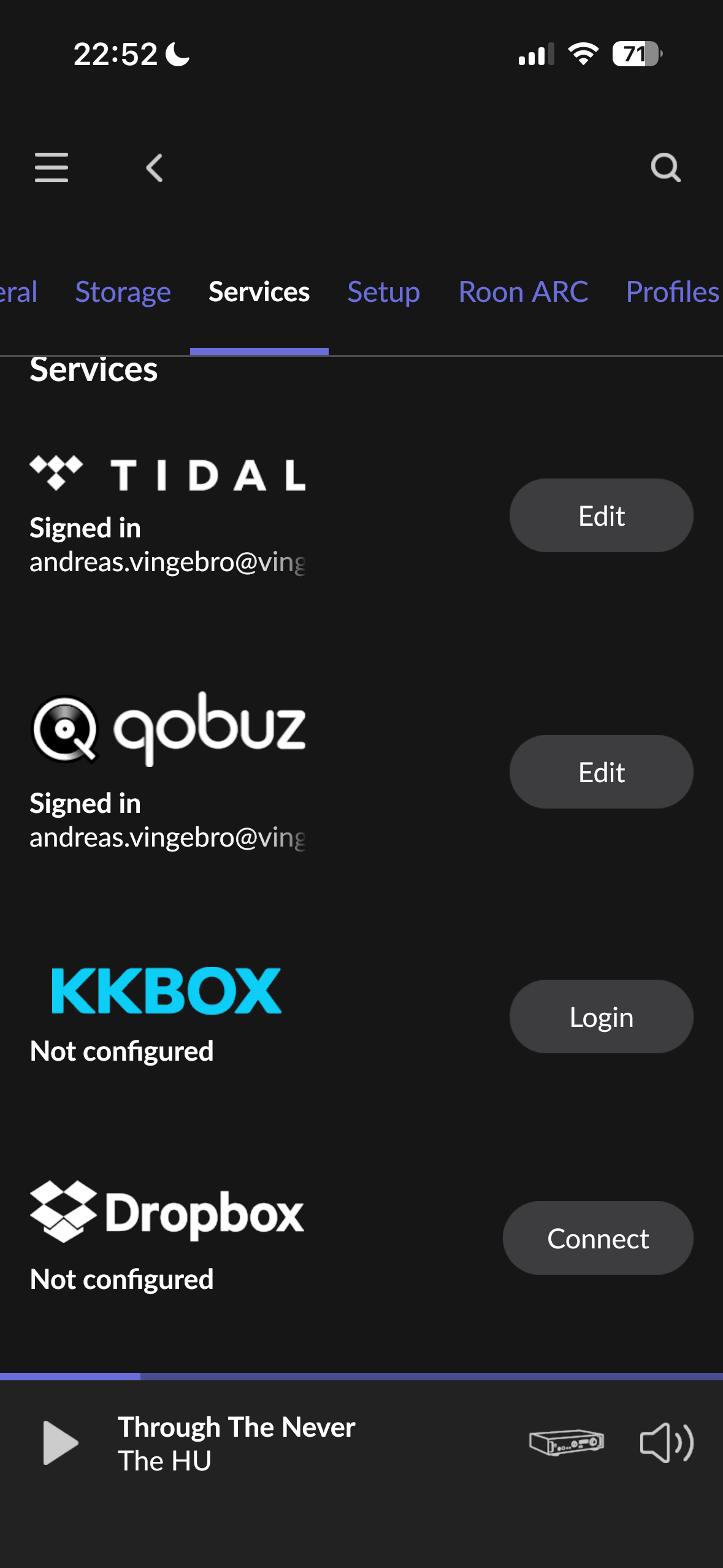

Can you also head into your Roon Settings>Services>Tidal>Edit and review your streaming quality settings?
Thank you! :folded_hands:
Hello Benjamin

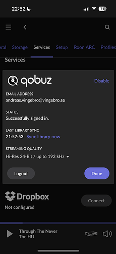

Interesting notice in diagnostic. I’m only using Roon with both Tidal and Qobus. I have Tidal installed in my Mercedes but should not be active at the same time.
Of course I tried different setups, Qobus connect, DLNA etc etc
But for having music at all I’m using the Teac as a Roon ready client. I have take screenshots and if there is any thing else you want me to test or if you need to connect via team viewer or similar, let me know.

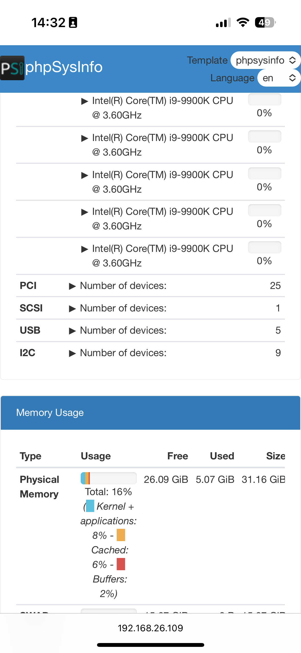

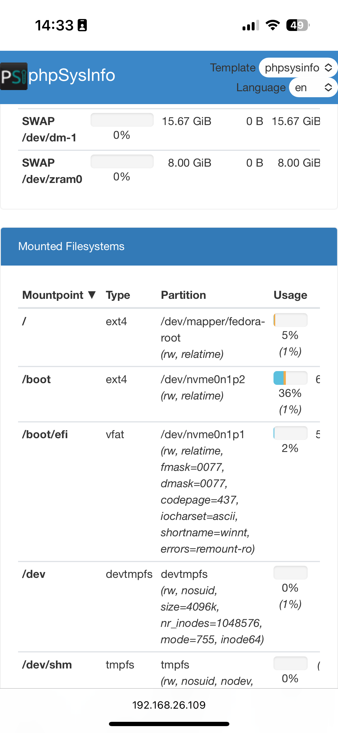

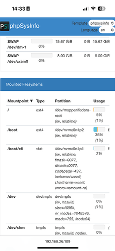

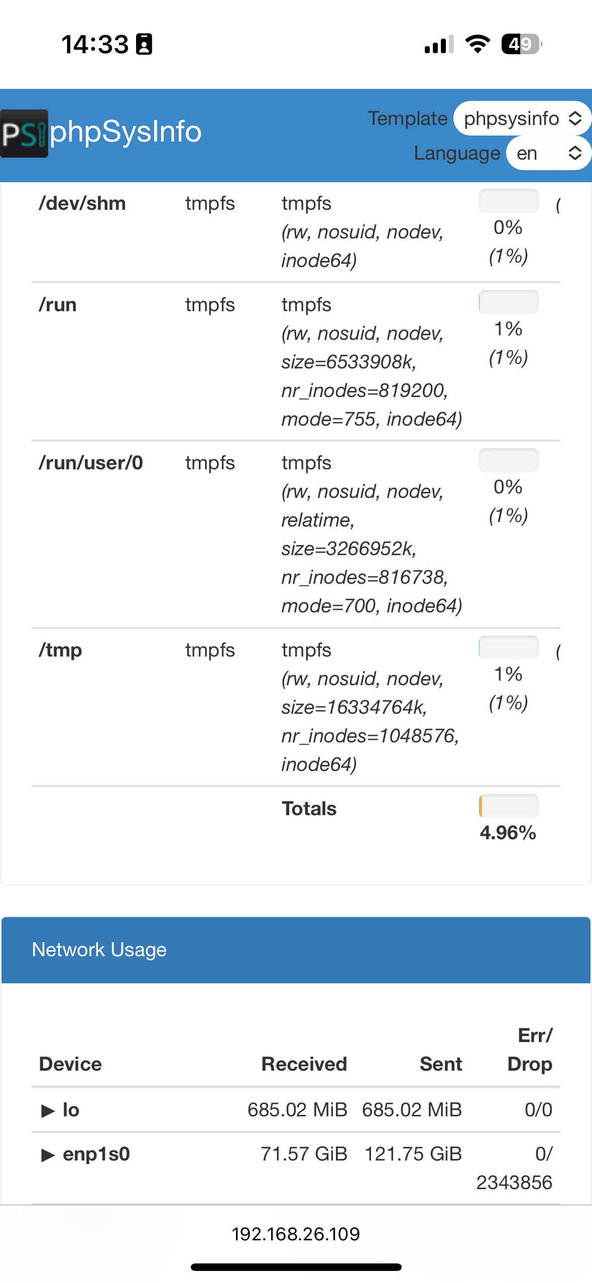

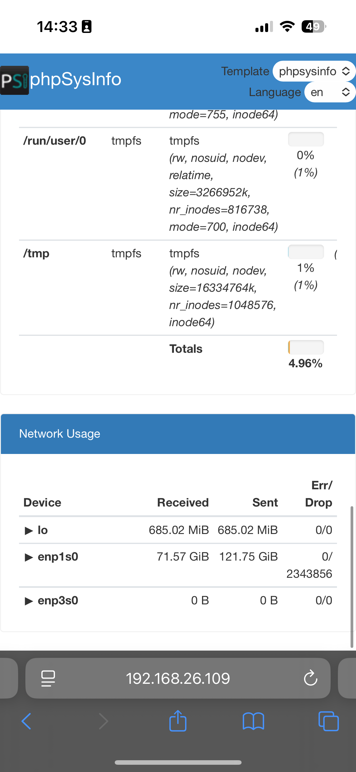

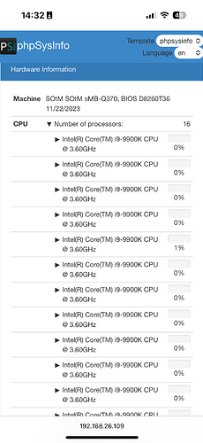

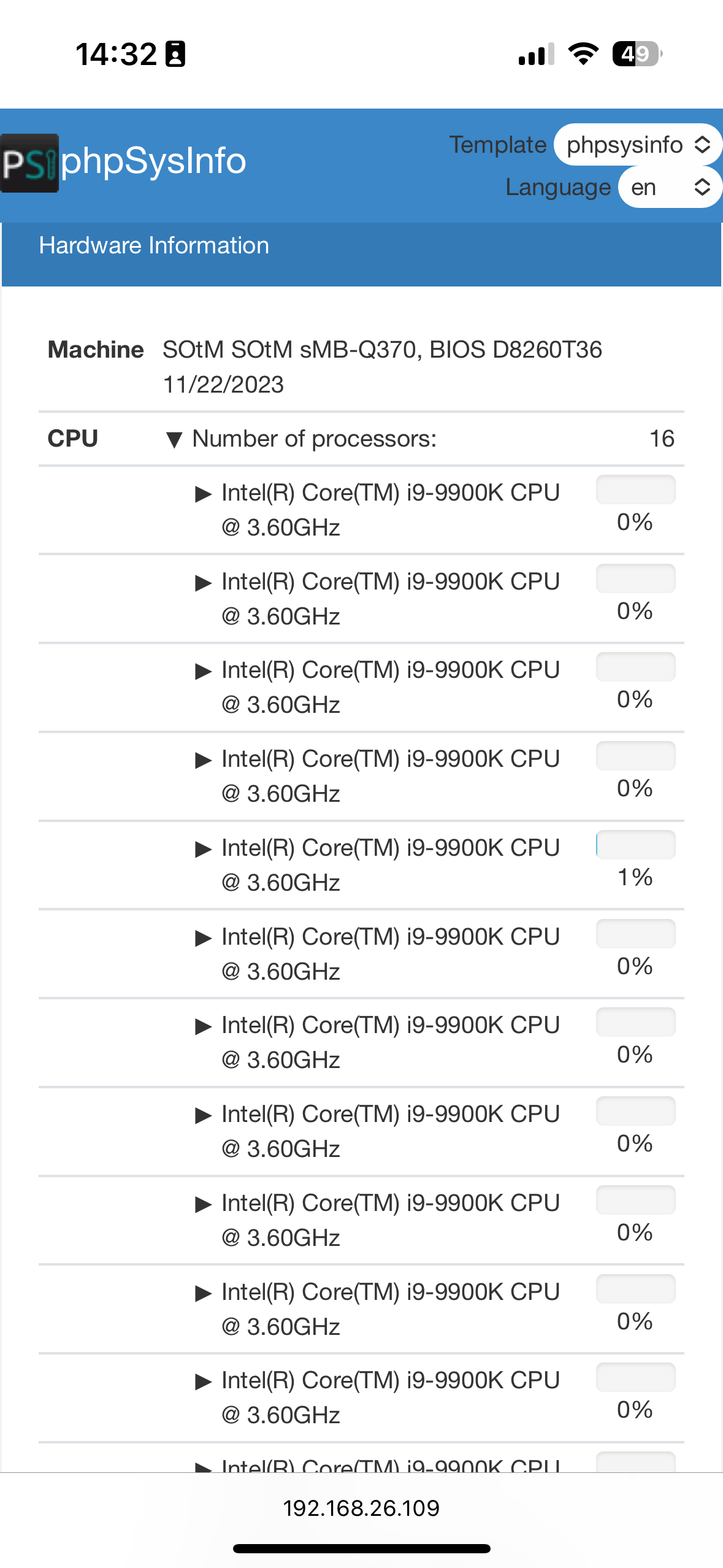

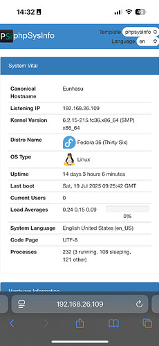

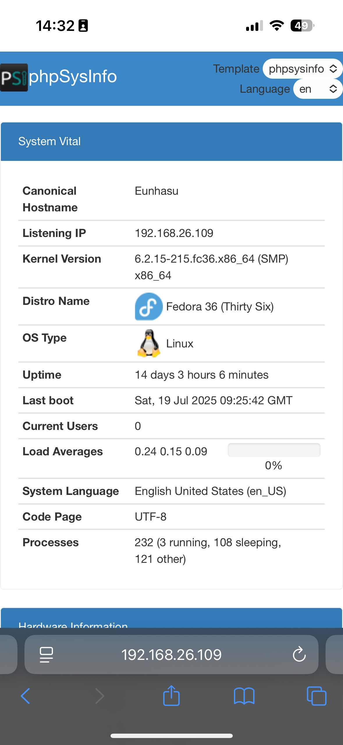

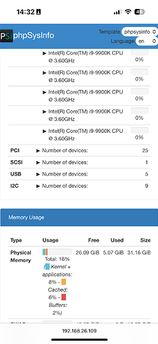

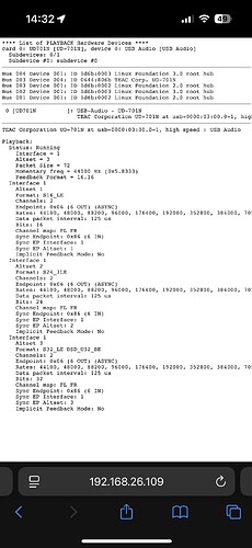

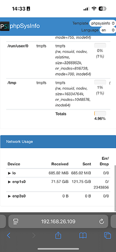

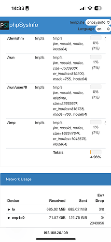

Would you kindly additionally attach the screenshots of “Detail system information” and “DAC information”
Hi again
Updated to latest version from sotm.
Last 2 pictures will follow.
Last two screenshots.
My Teac works via roon nocleus rev B. Via usb.
Sotm SMS 200 and sms 2000 does not work to gather with roon. On the other hand SOtM hardware works via qobus and DLNA.
So my conclusion is that there is a usb driver not working to gather with SOtM hardware.
Please se if you guys can solve this issue.

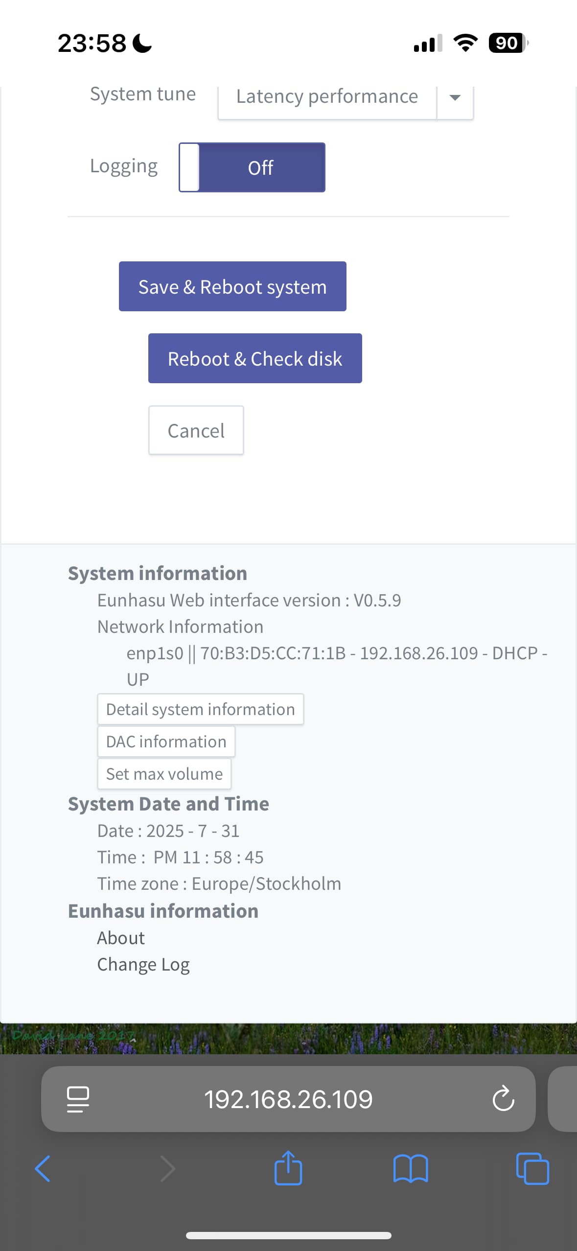

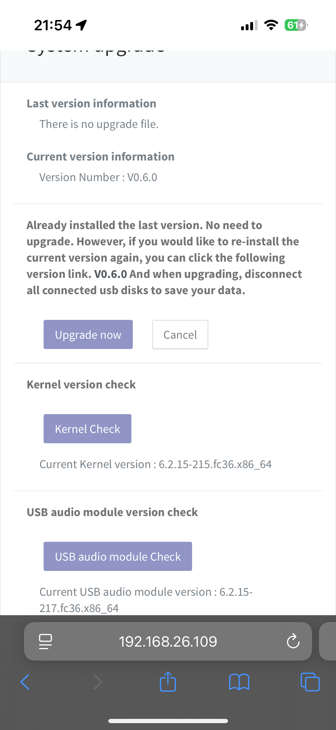

Hello @Andreas_Vingebro ,
Thank you for the update but we still do not see the firmware version, would you kindly try to access the sMS-2000’s web interface. Then, go to the System Setup section. If there’s a yellow upgrade icon, it indicates a newer version is available. You can also find the firmware version under the System Upgrade section or by clicking “Kernel Check”
Here is the version. No updates available.
Thank you @Andreas_Vingebro,
Our partners will continue investigating this issue, though it may take some time. The firmware version you’ve provided matches the version that should be working as expected. To help narrow things down, we’ll also be testing a minimal Linux build on our side to confirm.
