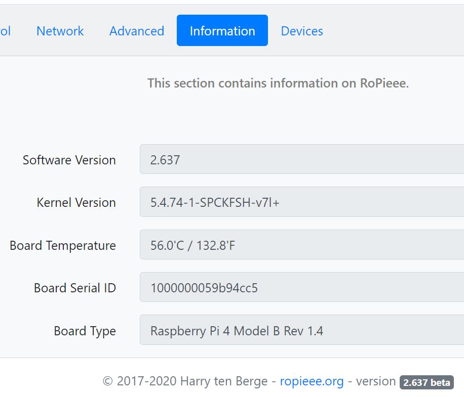

update 2.637 working on both Pi4 B rev 1.2 an rev 1.4. On the rev 1.4 it doesn’t show the USB FW Version under the information tab
Can you send feedback?
Logs have been sent to RoPieee HQ with unique identifier 0ea1287fcf1a2fd2
Ok, it seems your unit gives a faulty CPU revision code, hence it’s not detected as a Pi 4.
That’s why it’s not showing the firmware field.
Have you overclocked stuff or something like that or is this board very new?
it’s running stock with a HifiBerry Digi+ Pro HAT. I bought this Pi about one month ago from PiHut so might be ‘very new’.
Hmmm. weird. It’s CPU indicator is not known in Raspberry Pi’s database.
I’ll keep a close look, but only add it when it pops up in the Pi database.
