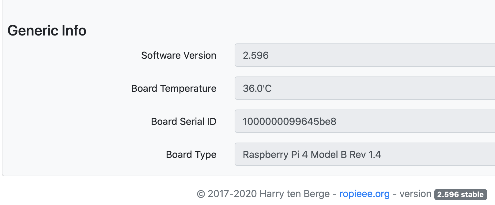

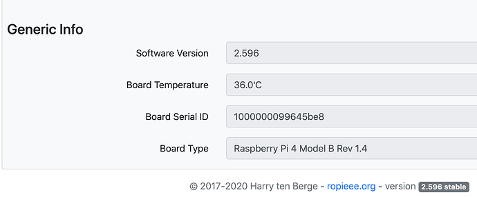

I’m sure I’m missing it, but where should I be seeing that an update is available?
(I have it set to update to new version on reboot.)
You’re on stable. (look at the version on the bottom line).
This is about the beta channel.
oh, duh.
Thanks.
