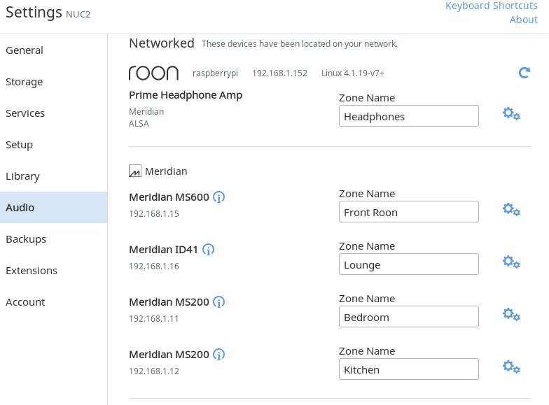

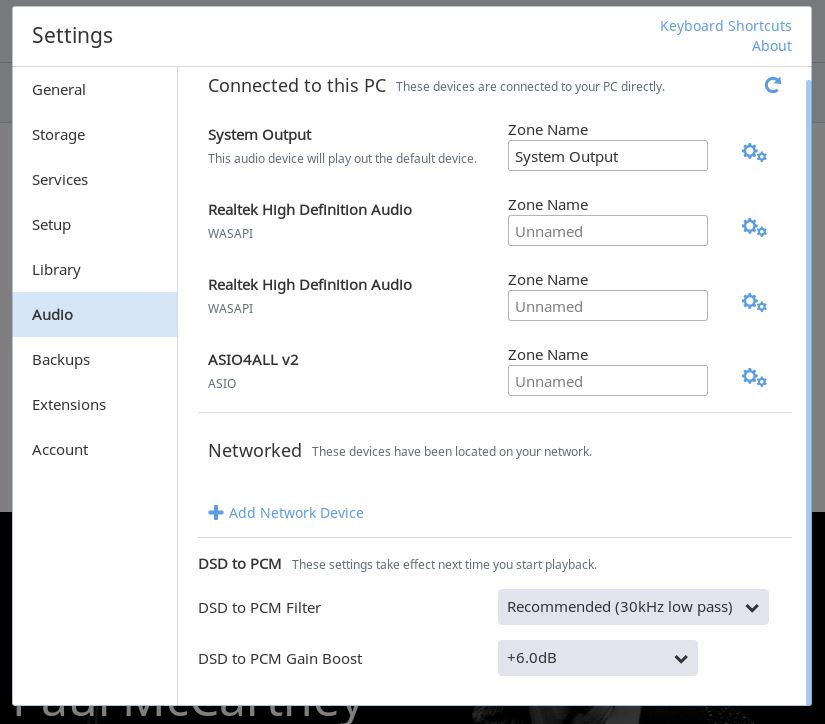

can you post a screen shot of your audio setup screen in Roon ?
Like this …
Just want to make sure you have enabled it (the 808) fully.
Gents, thank you, Carl- have asked the question to the original owner, will await a reply.
Tried the old switch off-switch on trick this morning, no change.

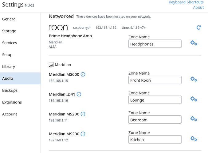

Nick- screen shot of what I see in Settings-Audio-

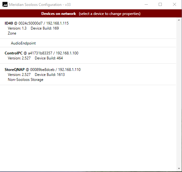

Which hopefully should display a screen a little like this:
Note the card’s IP address on this screen (mine is 192.168.1.115 but it will be different on your system).

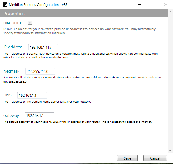

I have an ID40 card but you should see ID41 … double click that section, and if it is setup to use a static IP it will look like this:
Please take a screen shot of this,so you have a record of it (I use the snippet tool that comes with Windows).

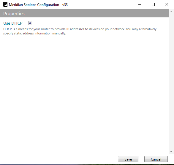

Now click on Use DHCP and the Save
Your ID41 card should now be using DHCP, so it will request an IP address from your router.

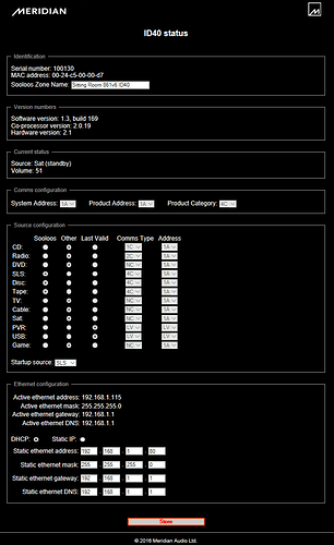

Also, once you have the new IP address of the ID41 card, you can point a web browser at that IP address and see that cards web config screen:
From me this is: http://192.168.1.115

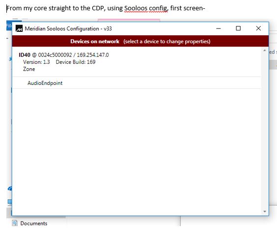

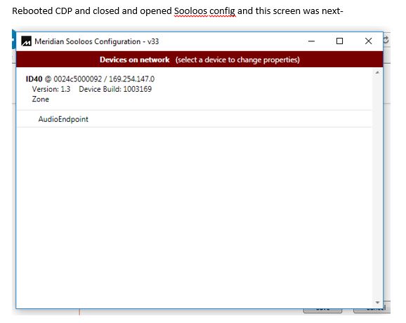

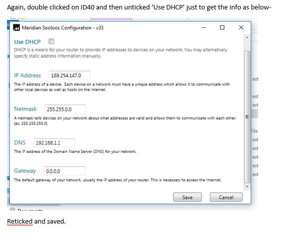

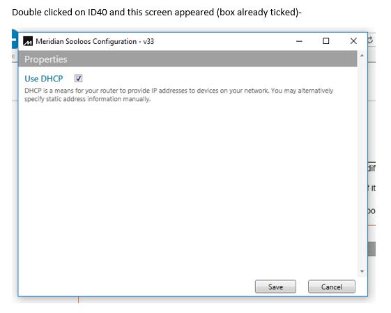

Okie Dokie, this morning I did all that Carl suggested above and all went well until plugging back into the router. Once I did that, Sooloos Config could no longer see anything. Putting the IP address into the address bar and hitting enter also did nothing.
Copy pasted the config screens and comments below, for info if it is useful-
