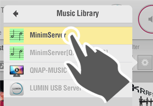

I plan on taking my S1 to a friendā€™s home tonight so we can listen to the S1 compared to the new Ayre QX-5 network player. I copied a bunch of songs to a USB drive to make it easy to listen to music so we donā€™t have to take the Synology NAS with me and set it up.
Boy do I feel stupid, where in the Lumin app do I tell the S1 to point to the USB drive as the source of music?
Thanks,
Brian ā€¦
In Lumin app settings, please choose the Music Library:
