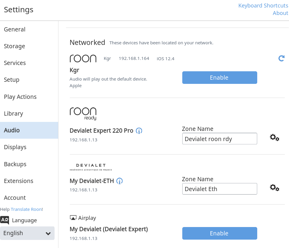

Hi,
Thank you for your swith reply. I think I have solved the issue (It didnt seem to be a network issue).
I looked through the Roon Audio Settings (See attached image). I had first selected the second option (Roon Ready Icon, “Devialet Expert 220 Pro” name) thinking this would be the best. This option gave me all the problems.
Next I selected the third (Devialet … Icon, “My Devialet-ETH” name). This worked!
Having tested an hour back and forth this third option consitently works well, the second (roon ready) option consistently gives me problems.
I wanted to give you this feedback.
Can I ask, Can you give some insight on how to understand the difference between option 2 (Roon Ready Devialet Expert 220 Pro ) and 3 (Devialet … )?
First is my phone & Fourth - Airplay I understand.
HI @Robert_Carlsson,
Devialet uses a few different protocols of communication, with Roon Ready, Devialet Air and Aiplay to facilitate communication.
As per our Devialet Air Documentation, seeing that -ETH part means you are using the Devialet Air driver while seeing the Roon Ready logo means that the device is using our RAAT Protocol.
Since the issue does not appear when using Devialet Air protocol, I suspect you may be affected by a known issue surrounding Devialet Expert devices. We have requested Devialet’s help with this and you can read the current status in the following thread for more information:
If the -ETH driver is working, I would suggest using it for the time being.
