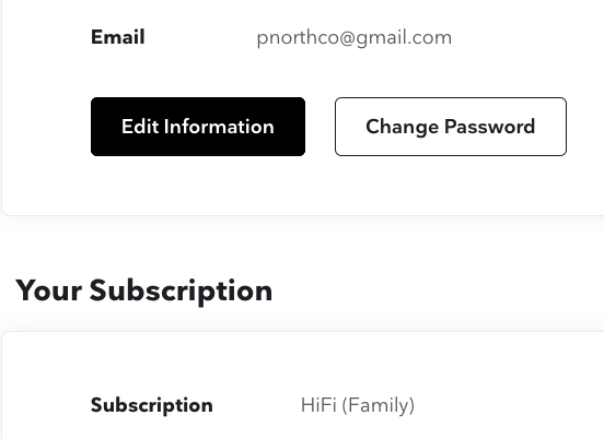

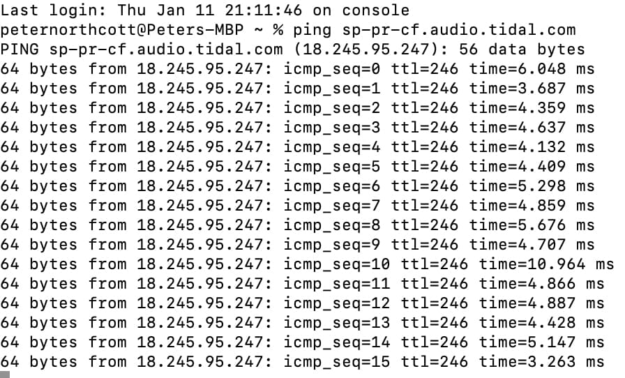

Sorry for the delayed response. Your issue is a bit complicated so I’ve had to work with the rest of the team on it. So it looks like you’re receiving a 403 or “forbidden” response from Tidal when requesting certain tracks. This may mean you are requesting tracks from Tidal Max. Can you check if your Tidal subscription includes Max? Another test is to open the terminal and type ping sp-pr-cf.audio.tidal.com followed by enter.
hey @daniel I have the HiFi subscription and have been unable to play the 16bit files. Those fail as well.
From terminal
