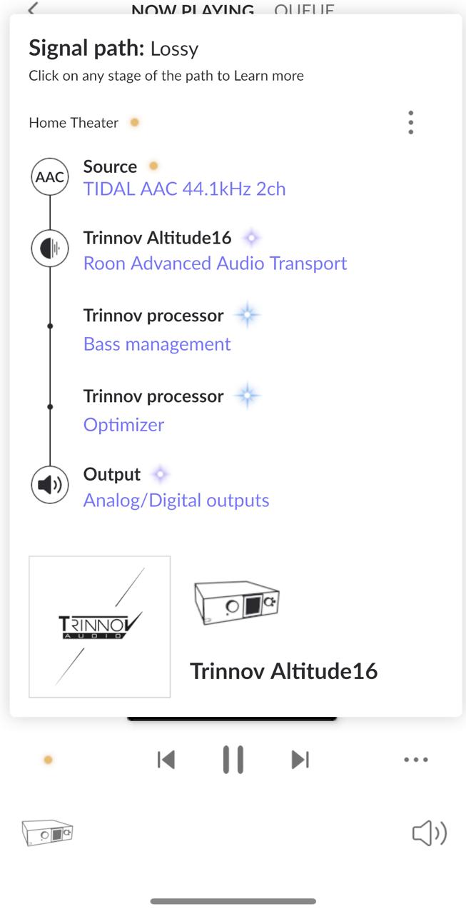

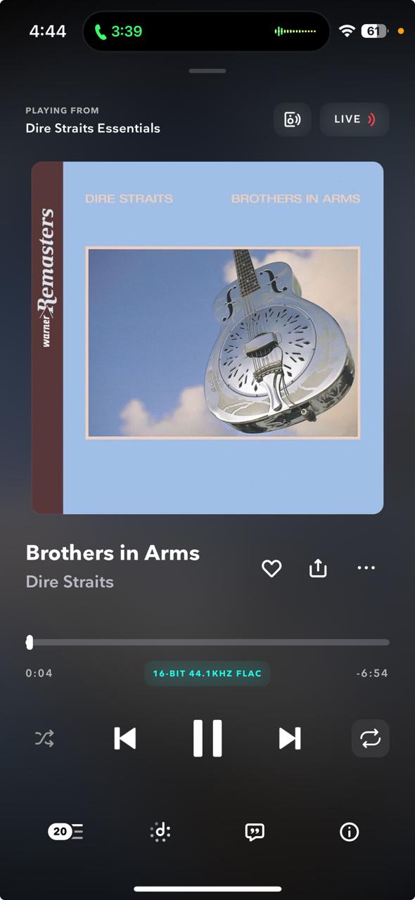

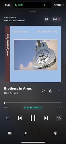

Hi… I recently renewed my Tidal subscription after a 6 month break. Roon shows the playback as Lossy, but the same song on the Tidal app is Lossless (Brothers in Arms by Dire Straits, and it says 16 bit 44.1kHz FLAC) . For the previous 6 years of my Tidal subscription, I’ve never had this problem. This is on the main Roon App and NOT the Roon Arc app.

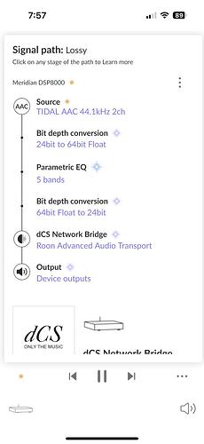

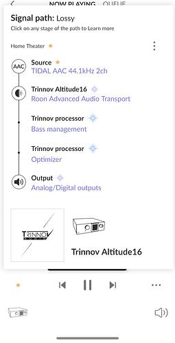

I’ve tried playing Roon on Meridian DSP 8000s through a dCS Network Bridge. I’ve also tried playing it through a Trinnov Altitude 16. Both show lossy.
Am attaching screenshots of the app, Roon through dCS and Roon through the Trinnov.
Need help in resolving this issue.

Just figured it out. It’s under Settings / Services / Tidal /Streaming Quality.
It was defaulted to 96kpbs😬. Probably since I let the subscription expire.
I’ve put it to Max and it’s streaming lossless again.
