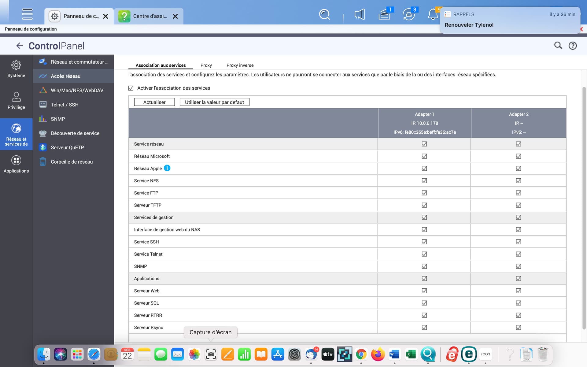

In QNAP, disable IPv6, set DNS to 8.8.8.8
Save it then reboot the QNAP.
Hi,
hank you for your reply.
I went to Acces Services page (see Screan Capture) but I do not know how to disable IPv6
and set DNS.
Could you provide more information to set the new options?
Best regards,
Gaëtan
Probably under settings → Network

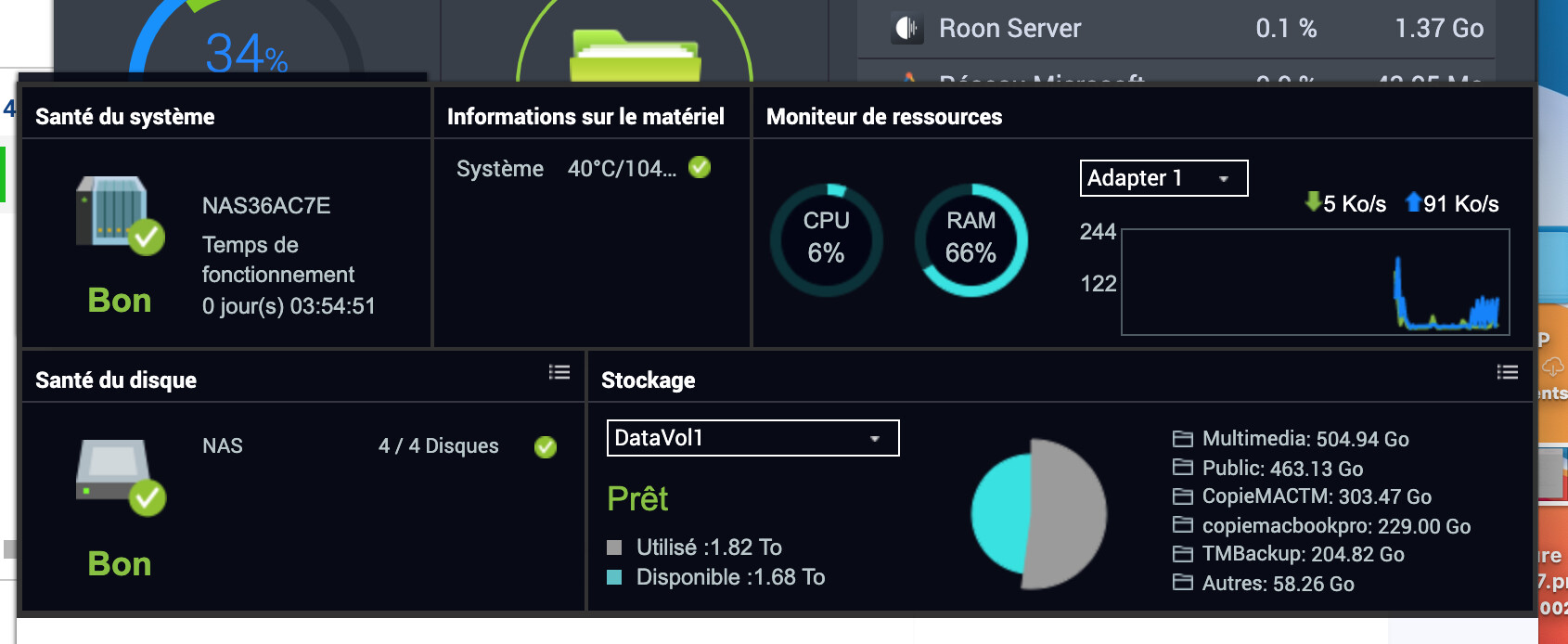

I thought that one of the source of the problem could be the available RAM to process the operating of Roon - it is 4 GB of RAM and it is used at 2,73%.
Since my QNAP NAS Is also used for other functions (Video - Photos - files) I need to manage the applications accordingly - meaning to stop them - while I am not using them.
On the ROON web site, it is recommenced that 4 GB of RAM be available - but do you think that in my case, 8 GM of RAM would be necessary to operate ROON app more smoothly?

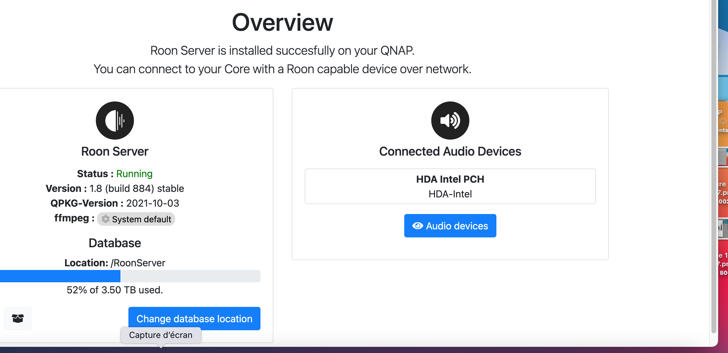

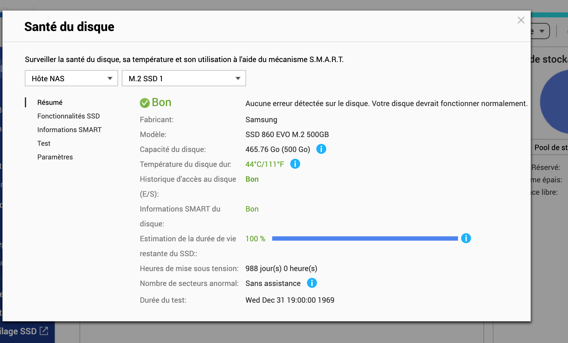

I need to provide some details about the hardware :
I am not sure that my QNAP NAS is lacking hardware capacity. The RAM is of 4 GB but the Roon Core and it Data Base are installed on a SSD Drive. I send to you screen picture to see my set up.
Gaëtan
