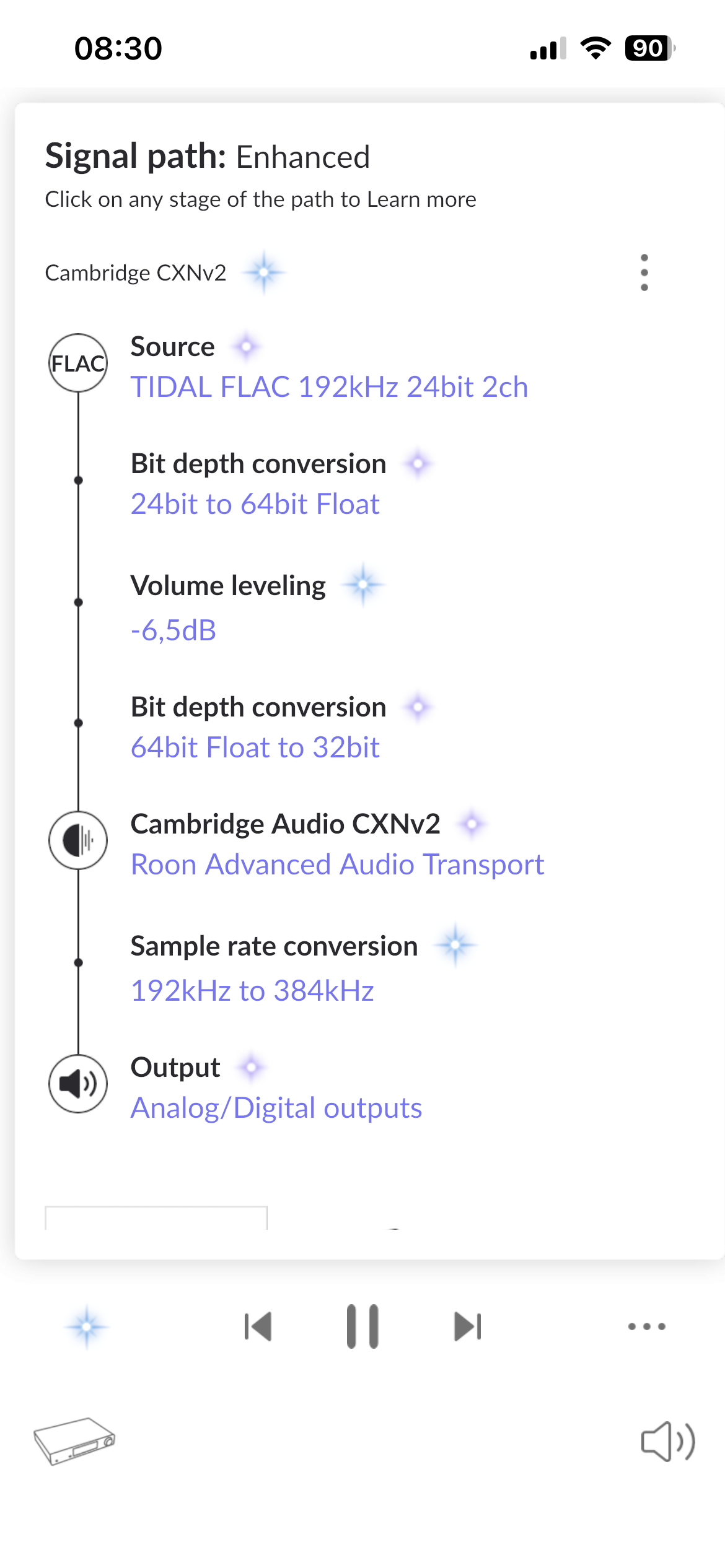

Certain TIDAL songs don't play on my CXNv2. I have the same issue when playing directly from TIDAL. My assumption was that this is related to MQA, which my streamer does not support. My understanding was also that roon would take care of transcoding these streams into something compatible with my streamer.

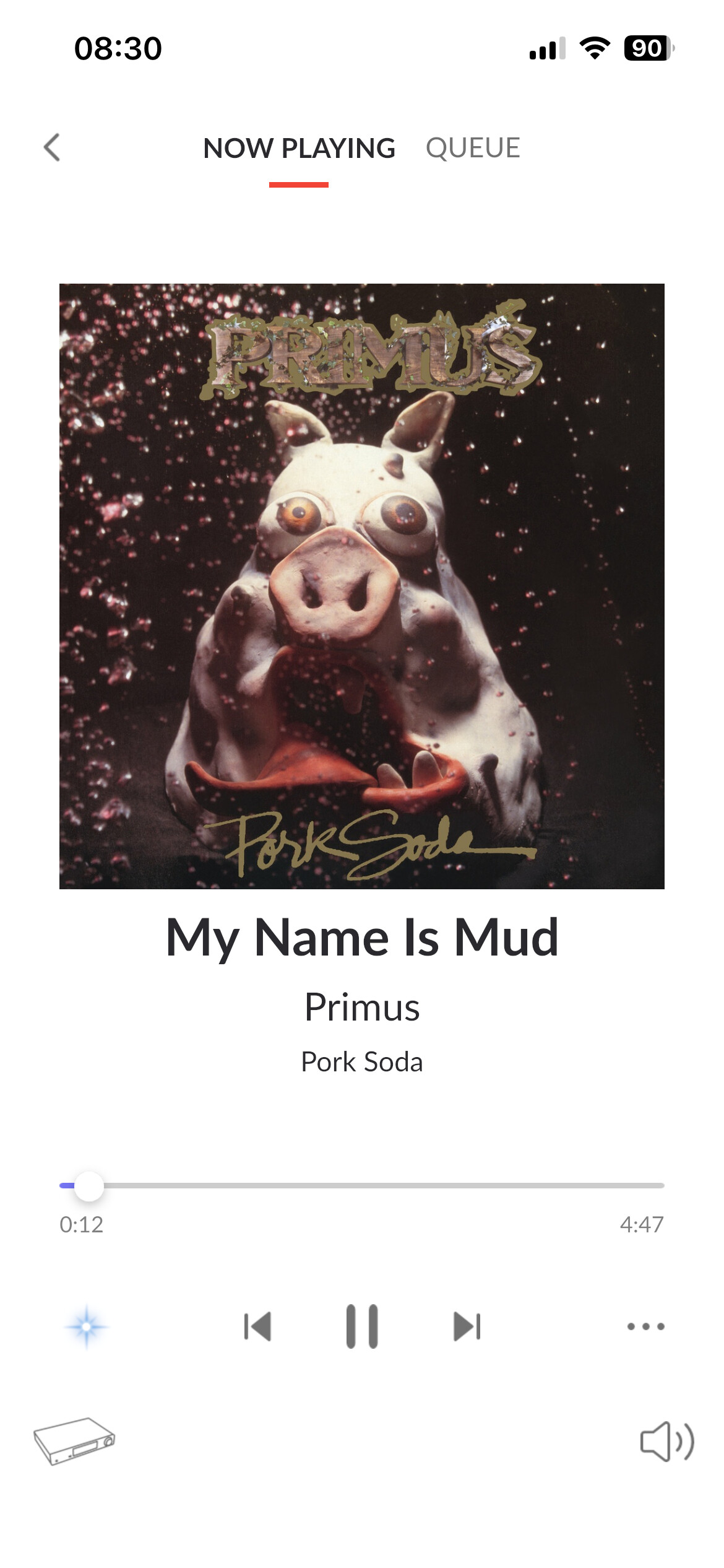

The version of the last song I've experienced this with was
Primus - My Name Is Mud
FLAC 192 khz, 24bit.
Best regards!
Wired connection via Netgear managed switch
MQA can be played by any player, the question is just at which resolution it plays. However, the example in your screenshot isn’t even MQA, it’s regular FLAC.
It’s strange, though. I tried playing the same track and the track as such works, at least in my region (Germany).
As you have the same problem when playing directly from Tidal, it doesn’t look to be a Roon issue.
You are trying to play a 192/24 Flac file, not MQA. You are also having Roon upsample to 384kHz. Turn off the Muse upsampling in Roon and see if it will play. I guess it’s possible you are upsampling somewhere else, IDK.

Same goes for Roon. It is a regular FLAC and doesn’t contain MQA.
Hi again!
I believe at this point it’s safe to say that my problem is unrelated to MQA. The interesting thing is that the above track plays neither from TIDAL nor from Qobuz in this quality.

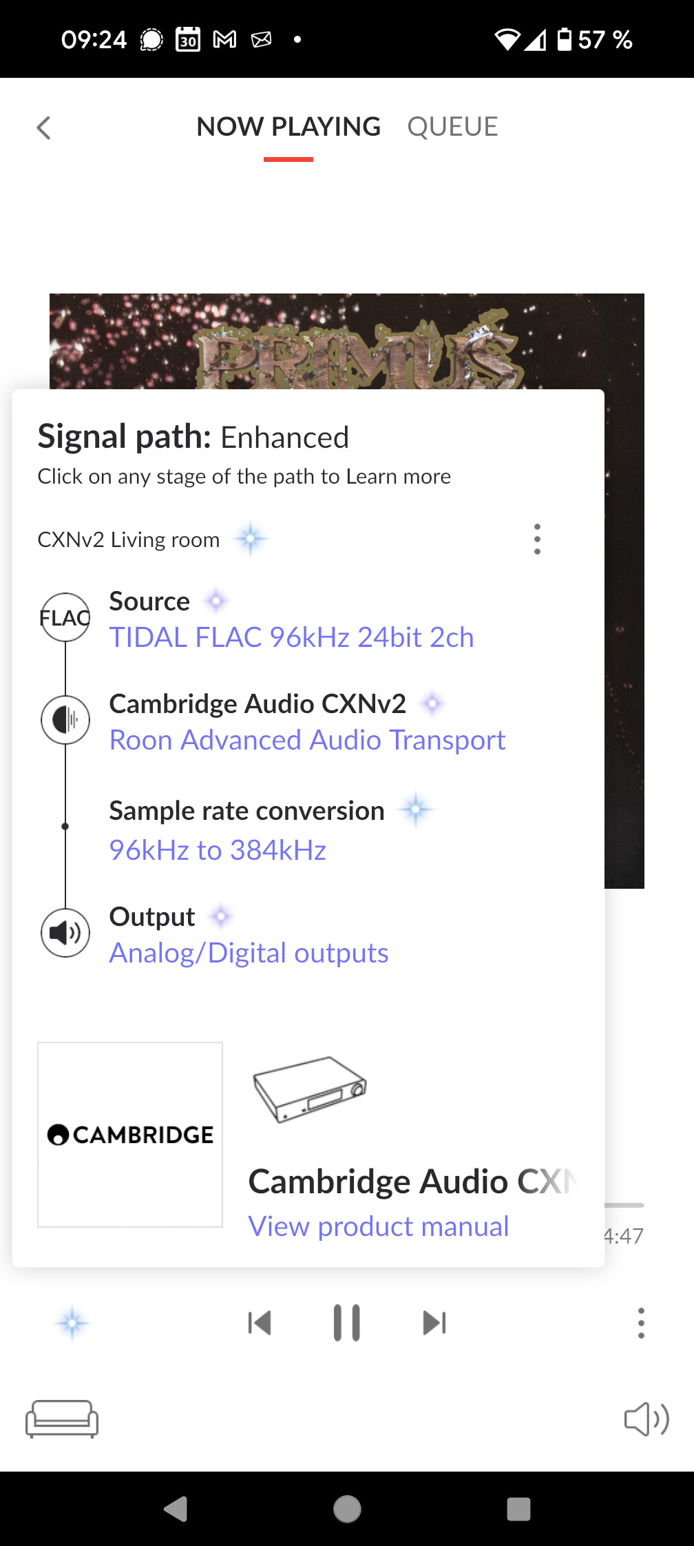

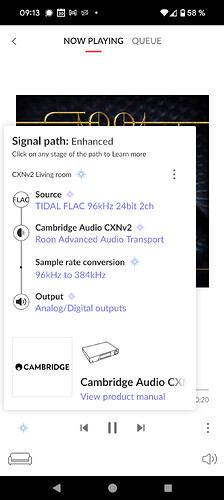

This does however:
Also this:
