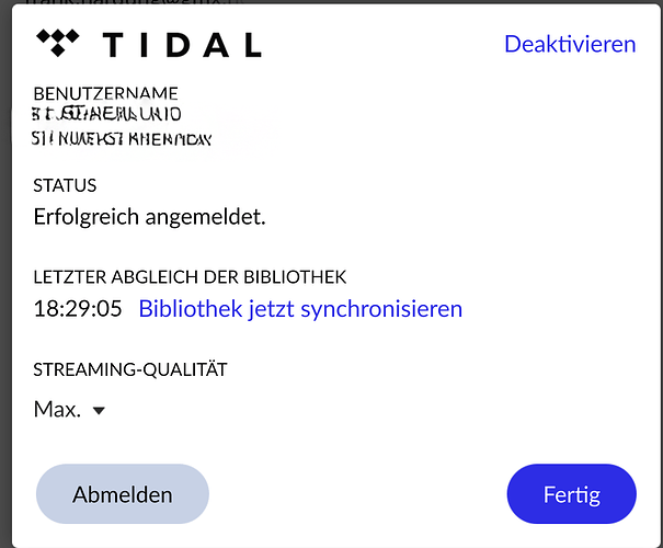

Tidal syncing issues and track skipping with error messages (ref#O41QUE)
· Tidal continuously in syncing mode and Tidal tracks are skipped sometimes and error messages that Tidal is slow
· FRITZ Box 6660 Cable, no extenders or switches installed; ISP Vodafone Germany, Cable, 1 Gbit
Additional information: Roon Core is ROCK on NUC13 i7 / 512 GB SSD and 16GB RAM, connected via Ethernet; Endpoints NAD C658 (ethernet), Bluesound Pulse mini 2i (wifi), and three Google Home Nest (wifi); All devices incl. ROCK on the latest OS and Sw versions; DNS Setup: using currently Google DNS, but also have used Cloudflare DNS; Problem still there.
I have tried some of the recommendations deleting several caches incl. logging in and out of Tidal account, but with out success. Can you provide me a step-by-step guide which steps I would have to do? Thanks.

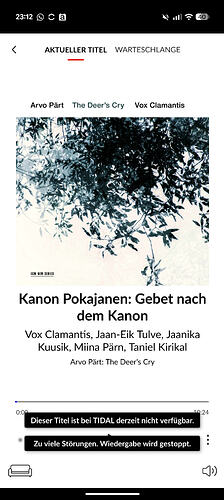

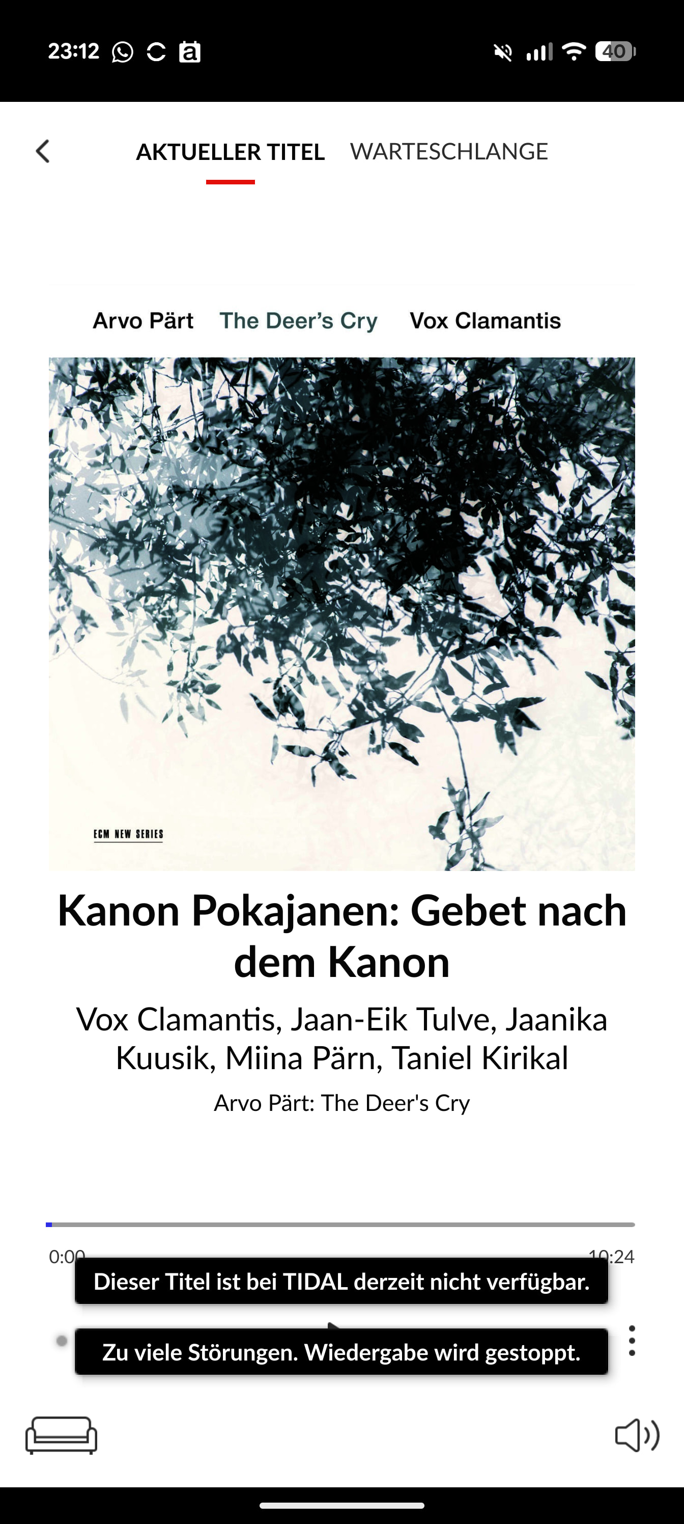

On top of the playback issues I also get the message that roon search is not available. When the search works again then also the playback works….and vice versa.
Here is one example of the error messages (in German)

Hello Alex,
Thank you for your detailed answer.
My feedback:
  1. I had already changed the DNS to Google DNS. This had not helped in the past.
  2. I don’t have the IPv6 tab: I use a “free” (not from Vodafone) Fritzbox 6660 model with the most current firmware 8.21, so I am wondering why the tab is not there.
  3. The layer 2 was unchecked already; layer 3 setting is not existing; The only active checkbox was Hardware acceleration. I disabled the packet accelration totally.
So the only change I could do was point 3, but that didn’t help. So I think point 2 would be the only option I could try out, but the IPv6 tab is not existing.
Thanks for any further help.
Another update: I have called Vodafone to switch my contract from DS-lite to full DS, which they have approved and already set up. I will test whether this resolves the issues and give feedback here.
With the full Dual stack in place the Tidal sync works. Also, at least so far, no dropouts anymore. Thanks for the support.
