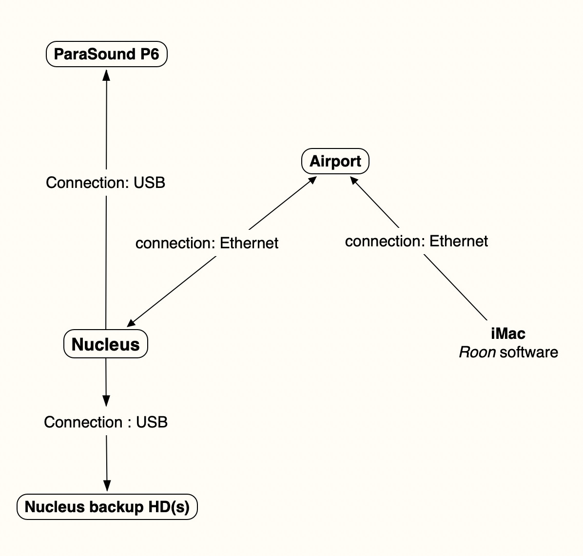

I typically get Purple diamonds all the time now. And have always believed that my Audio Setup is as close to the recommendations as it should be. But clearly shall revisit once I have everything in place
Are there any changes I should make to the latest configuration which I have posted here in view of that article’s/page’s Rule 5, viz:
## Rule 5: Use Ethernet between Roon Server and Output
Roon has comprehensive and robust support for WiFi, but the sound quality often isn’t the same. For your highest quality rooms, plan on using wired gigabit ethernet connections between the server and the Outputs.
Of course. Thx. So it’s this (assuming a Streamer):
isn’t it…
Now it looks right

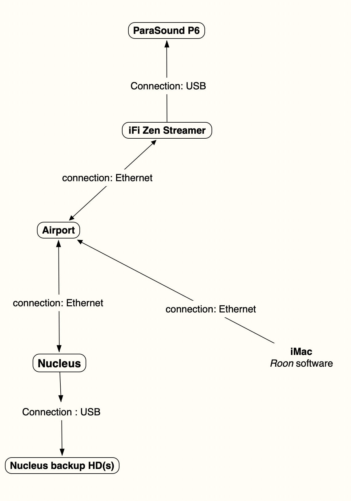

And if without the iFi Zen:
Looks good

Same with the streamer, it only has to reliably receive digital data and pass it on. They differ on features but all you need is Roon Ready. The quality of the wifi can also differ between models but with Ethernet it’s irrelevant. Finally, the quality and reliability of firmware updates can differ - but it’s hard to tell because one can find complaints about anything online. I think the Zen had a bit of a rough ride when it was new. I think it’s probably fine now but I know no details about the current state of things. There is a long thread here, but focus on the new posts and not the old ones:
It’s probably the cheapest plug-and-play option, at least as far as I know. There’s also the Bluesound Node in a similar price range. I used that for a few months to bridge a gap during system changes and it worked as well, but if you search the forum you will find the odd complaint about problems after updates as well. Hard to tell because like I said one can always find someone with complaints.

I mean if you buy the iFi Zen after all. The Zen will have to be on the same network as the Nucleus, and if you want to use Roon on the iMac to control the Nucleus then it will have to be as well. Roon only works if everything is on the same subnet.

Something like that, but I don’t thibk you need the USB connection between Nucleus and iMac. Both are USB hosts, so it will not do anything without some jumping through hoops.
