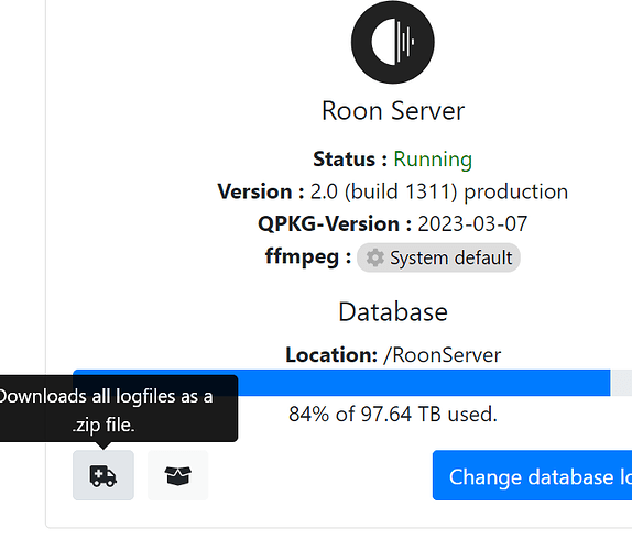

What is the build version of your Roon Core on the QNAP, as well as your iPhone Roon Remote and ARC?
It is the current build of the core and the client. Please see attached screenshot.

Also, it would help figuring out the issue if you download & look at the logs
(look for the time when you get these errors in the RoonServer_logXX.txt files)
