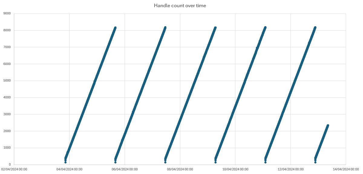

I extracted the handle count from the log, here is what it looks like over time…
The handles appear to relate to UDP sockets, based on output of lsof command.
The Roon Appliance process appears to be leaking 3 UDP sockets on a regular basis.

I can change the ulimit though I feel this would just delay the inevitable restart, probably due to UDP port exhaustion.
If I perform a netstat -ano I can see that the RoonAppliance process is leaving UDP listen session open - and this looks to be the main consumer of the handle.
Please let me know if there is any other information I can provide to assist.

Left the system overnight after re-enabling ipv6. Syslog much clearer.
Still same issue in RoonAppliance - currently 650 open UDP sockets after about 10 hours. So perhaps issue has slowed, but appears to still be leaking sockets.

I’ve decided to clean install Roon server on Debian 12. Looks like network reachability issues are Ubuntu specific as looks much quieter on Debian.
Suspect there is a handle / UDP socket leak in one of the events triggered by network reachability change on Ubuntu.
