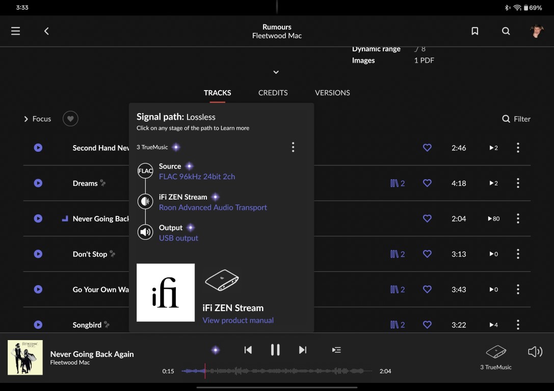

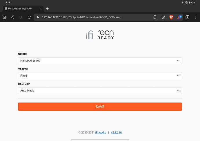

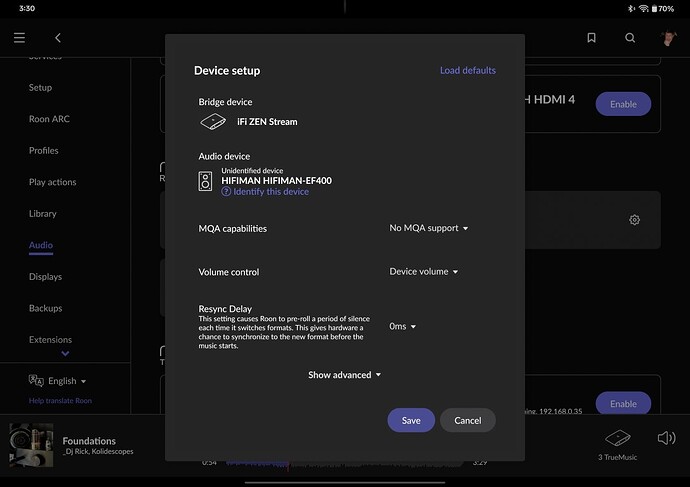

… screen shot of device setup and signal path, maybe?

Looking at your screenshots, that seems to be impossible, but I‘m out of ideas, unfortunately.
