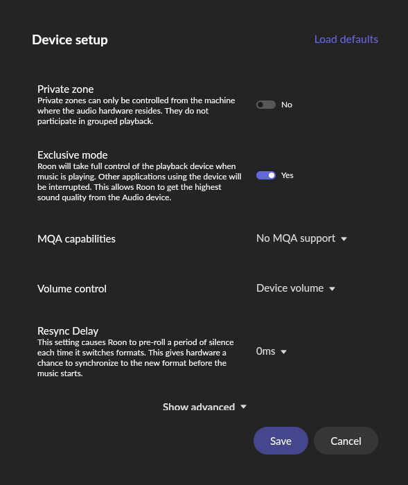

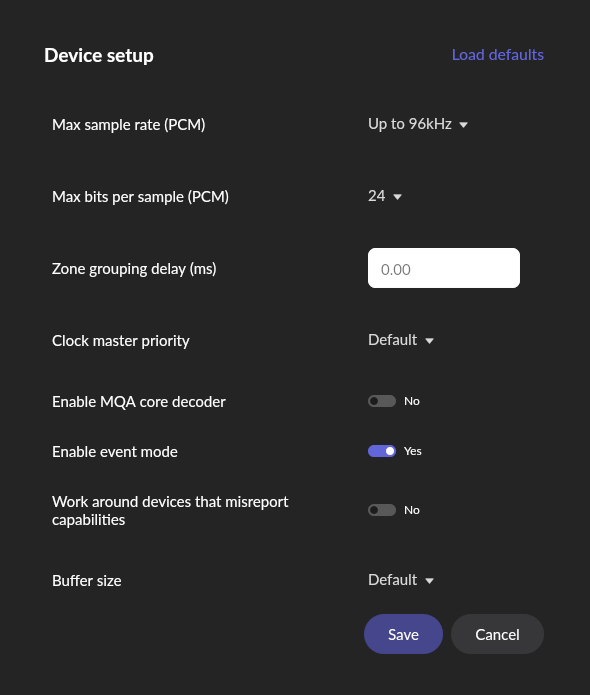

Can you show screenshots of the Roon device settings that you are using for the JDS Element?

24-bit, 48000 Hz (Studio Quality)
Exclusive mode boxes are ticked
