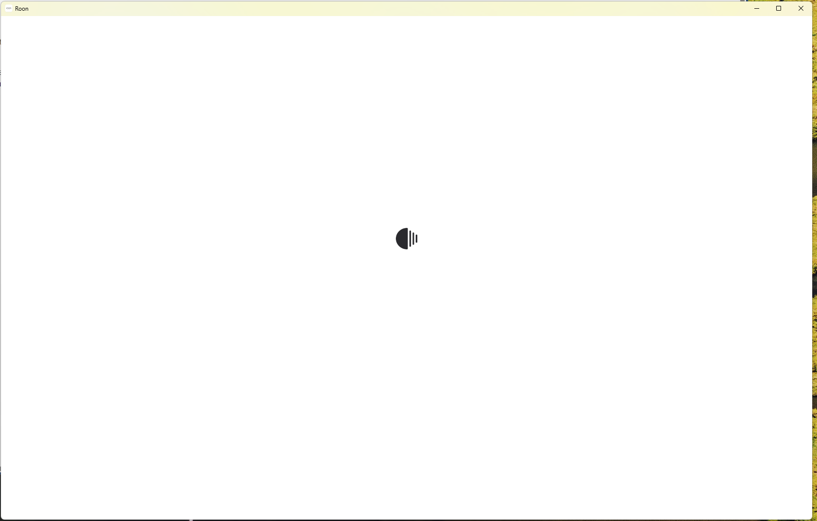

Transfer of Roon account/license to new Windows Server fails (ref#MT96DK)
· Transfer of Roon account/license to a new Srver (Win) fails
· LinkedIn Router and switches in place, all other nodes continue to work well. Actually I am typing this from the "new" Server to be
