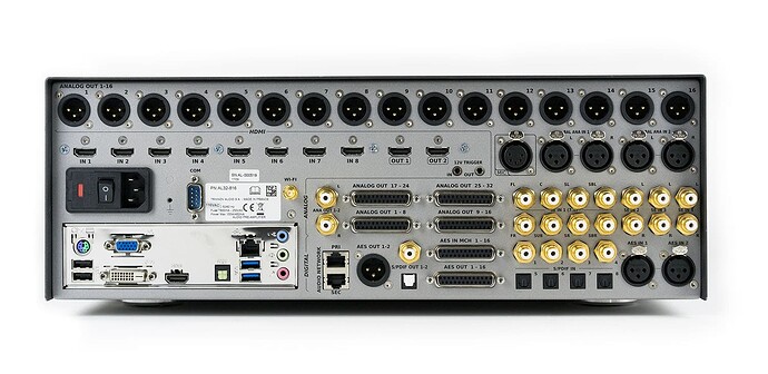

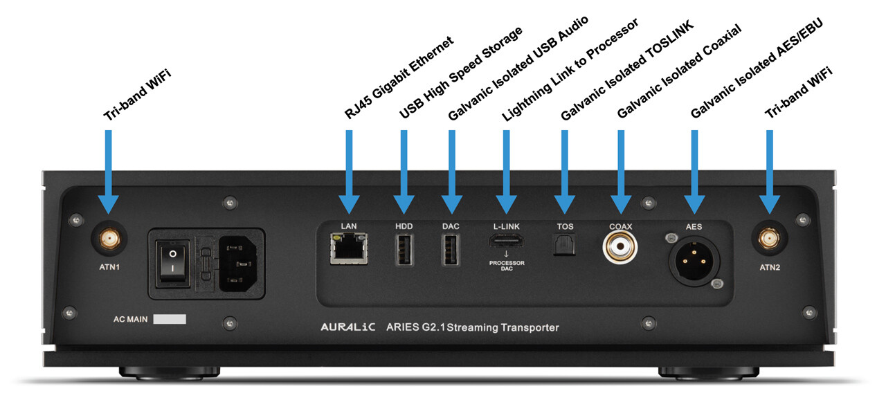

I already have a Roon account. I took a 3 month free trial to figure out if Roon would be what I need, but I still have some problems. Could you help me out? The point is that I would need Roon to stream from the Auralic Aries 2.1 to my Trinnov Altitude 32. I have to use the internal DAC of the Altitude, otherwise I cannot use the upsampling function anymore. Actually I am using my Macbook as the core, but the problem is that both are just 2 Roon endpoints, Aries and Altitude.
Nobody can help me out with that matter. Trinnov tells me YES, it’s possible, but at the end of the day I can’t make it work. Do I need to set up something special from the Roon side?

If you plan to use the Aries as the streamer (digital output) and the Altitude as your DAC (digital input), connect the devices using either AES or TOS (optical) cables.
In Roon, make sure the Aries is enabled under Settings > Audio.

:grinning: You are absolutly right Marin. What should I tell you? I like it complicated :grinning:. The point is that I started ripping all my CD’s with the Aries on it’s internal SSD. I had bought it for that reason. Some month later a friend of mine offered me his Trinnov for e REAL convenient price and so I didn’t think about it, but now I have a problem. :expressionless: I wouldn’t like to sell one of these two as they are both exellent and in ripping my CD’s in bit perfect the Aries is really fenomenal, so I am trying to let them function together.
Yes, actually I use the Aries AES/EBU output going directly to Trinnov’s AES digital input, but the upsampler of the Altitude does not work with that input. :cold_sweat:
Skimming the manual, it seems you can share the Auralic‘s internal storage over the network for Roon to access it and stream it to the Trinnov - anyone may prove me wrong, but worth a try!

I know you want to try this, and that’s fine, but with this setup the Aries from Roon’s PoV is just a shared file system. The rest of the Aries has no function in this use case.
