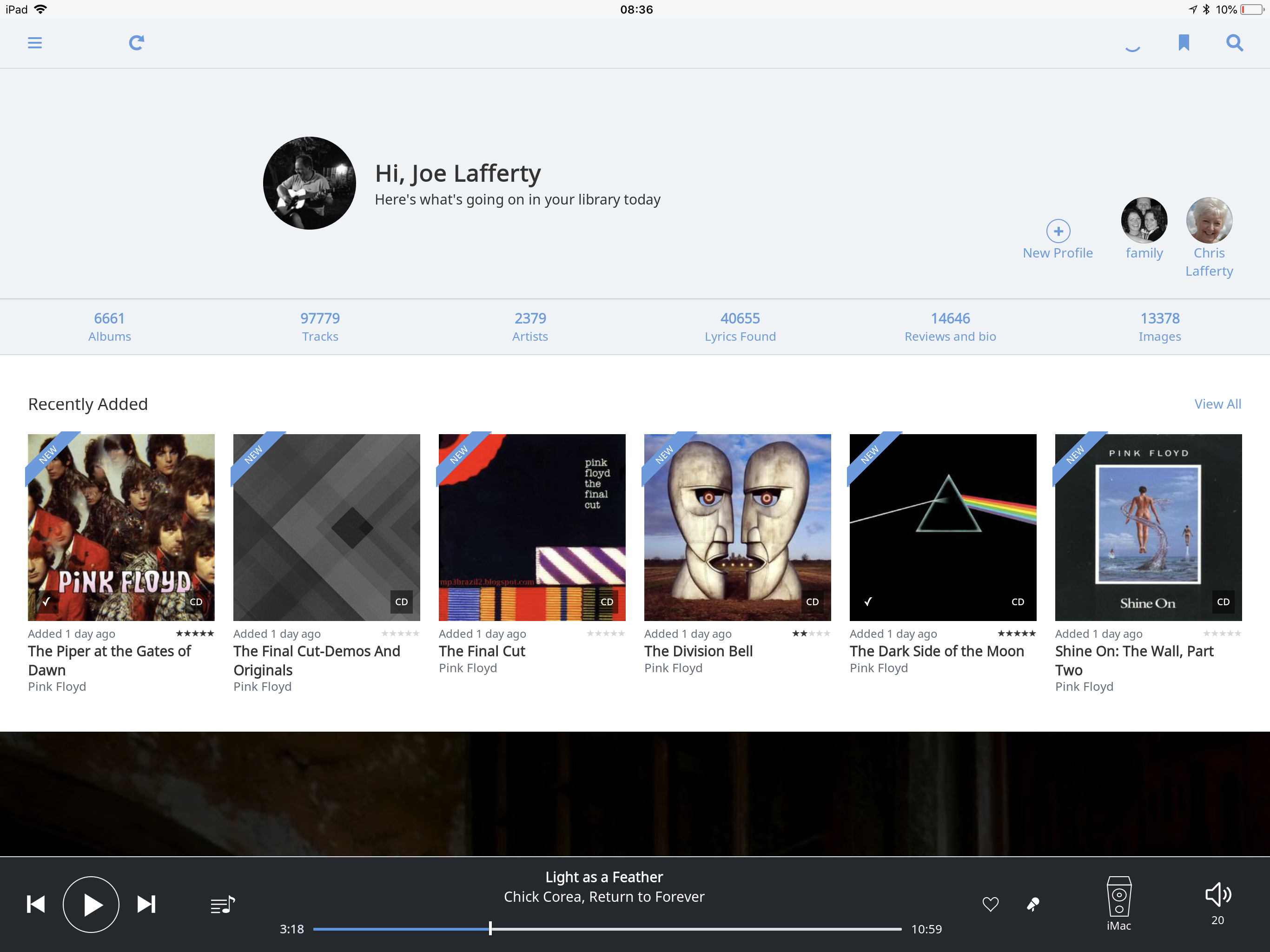

@support I cheked again this morning and there are definiatly TWO cores on my iMac. one the renamed one (which is showing 90,000+ tracks) and the Joes-5k-iMac one that i set up first on my mahcine-which seems complete. see screenshots.
so, how do I go about identifying and deleting the second core from my iMac? i need to be careful as I don’t wnat it to have to resynch all my music again!!

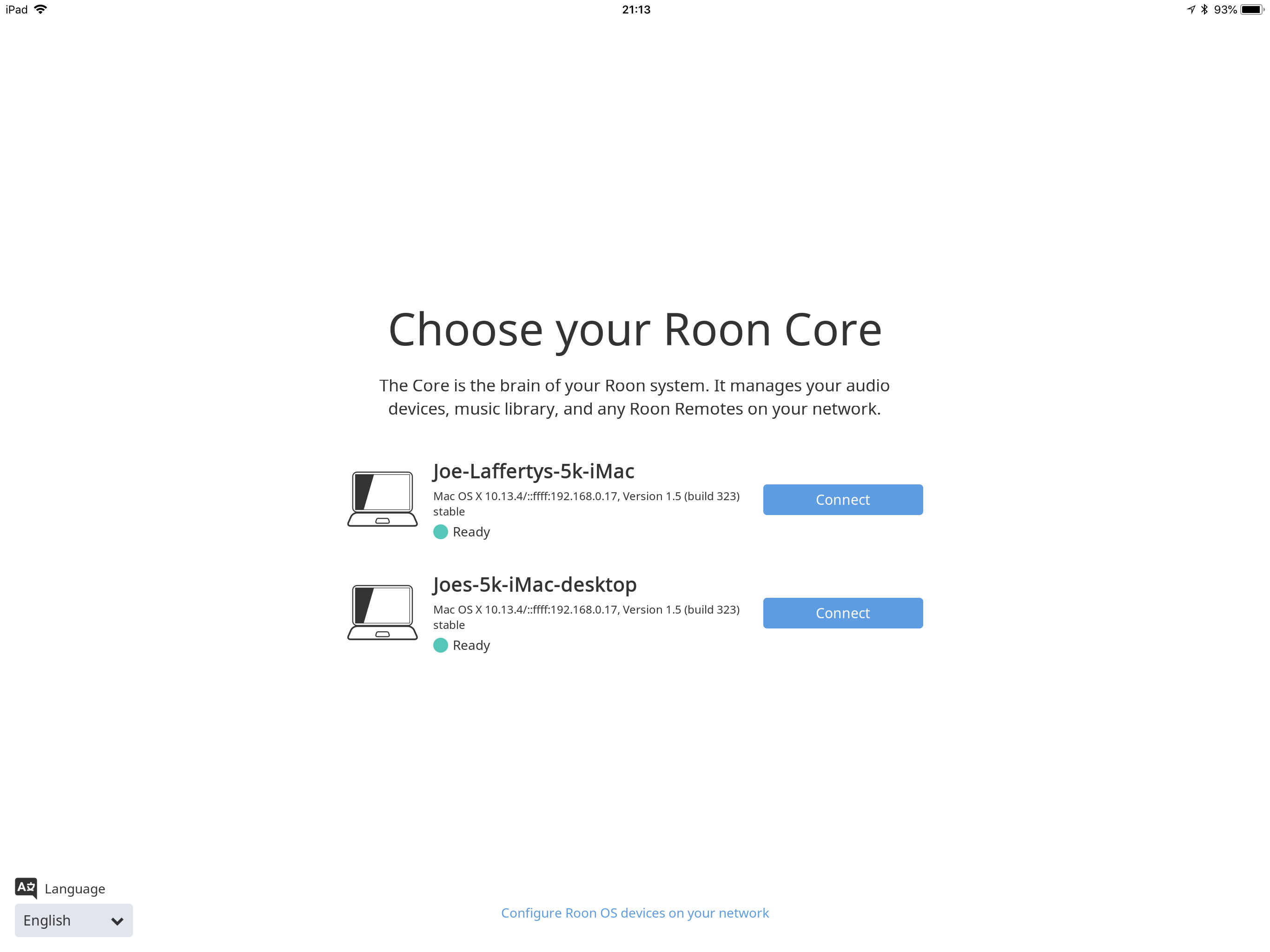

it seems like “Joe-Laffertys-5k-iMac” is the database which has indexed all my music. I don’t know what the “This Mac” is. I presumed it was a duplicate?
when I use my iPad as remote, and ask it to find core I get the choice of “Joe-Laffertys-5k-iMac” and “Joes-5k-iMac-desktop” which was the database I found duplicated and renamed…
see screenshot form iPad below
