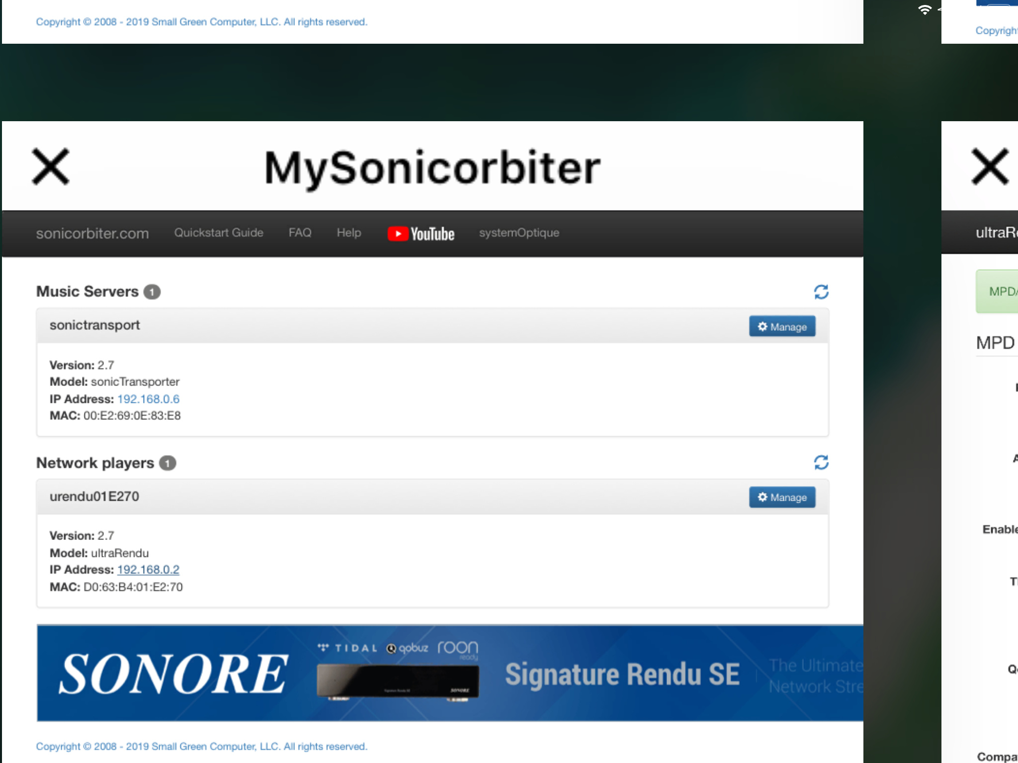

I run a SGC sonic transport i5 as roon core. It or the ultrarendu do not show up as audio source. What are the reconnection steps? All worked until power was upset by storms. I can see their IP address at mysonicorbiter.com. Just not showing up in roon as audio source. Stream by USB from ultrarendu to PS Audio DSD Sr. DAC. It all worked not a hitch initial set up for four days. Sonictransport still shows as core.

Norris,
I will attach screen shots i have rebooted core and diagnostic on core. Diagnostic on Ultrarendu hangs up. Also it identification of USB of my Direct Stream DAC is not happening through set up. I have reloade the Direct Stream firmware. Wondering if I should try USB direct to the DAC. i didnot reboot the network yet but the my sonic orbiter does communicate to the Transporter and Ultrarendu.
I also checked USB from Ultrarendu is in place and secure. I tried reboots of the Ultrarendu. Also DS DAC plays sources from coax and optical input. When I first noticed issue there was a digital stream coming into DS but no sound or at least roon had the moving equqlization five bands simulating a stream. Now all communication from Ultrarendu to DAc is absent after the slew of reboots.
