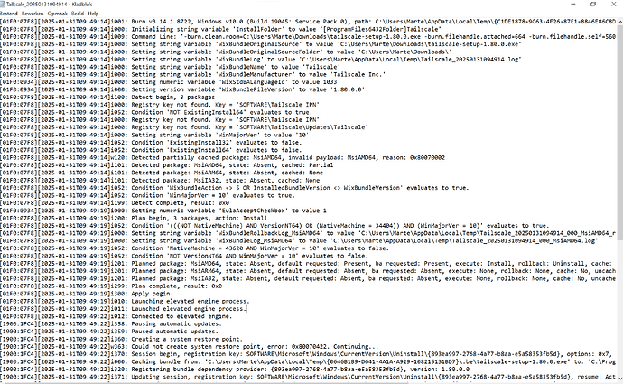

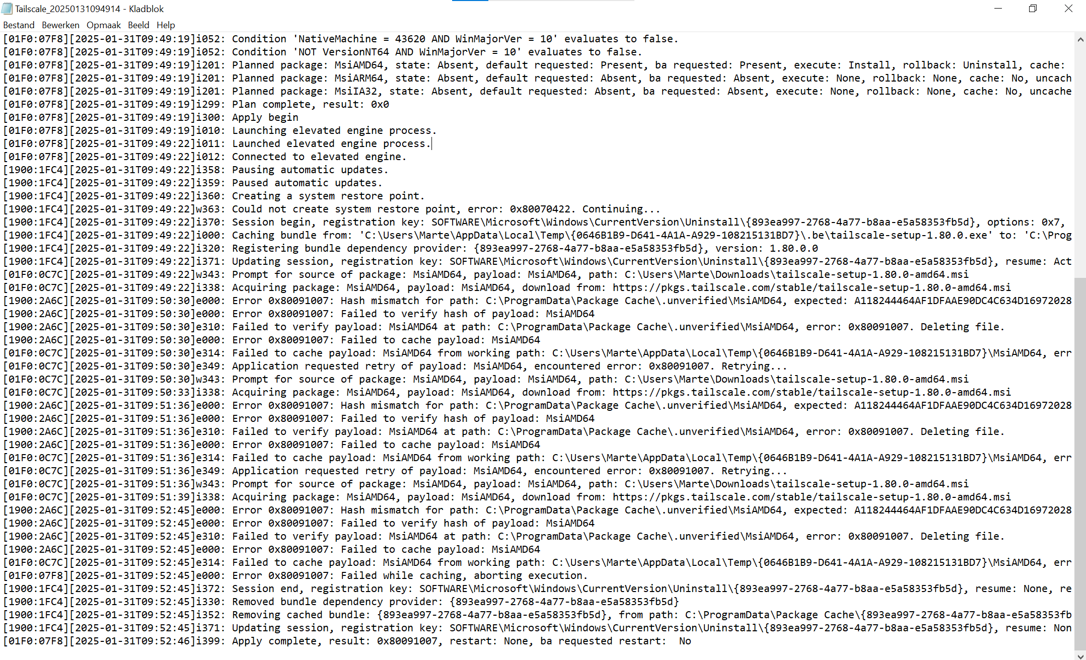

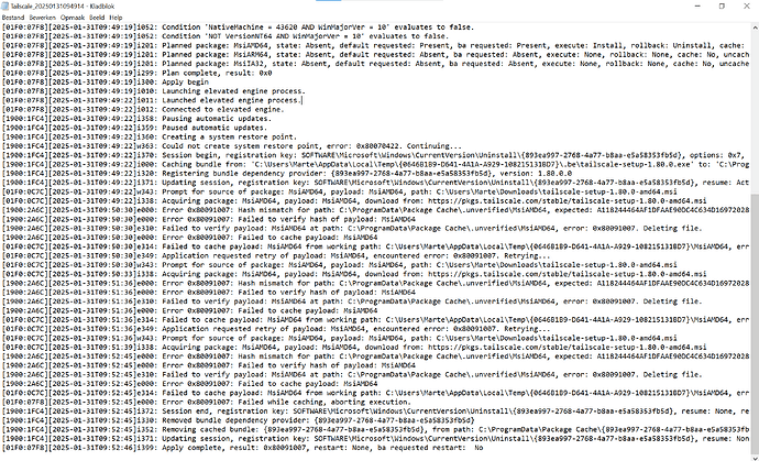

Tailscale is not installing on mij server/laptop. when starting installation I get error: 0x80091007 and a long log file which i can’t attach here as it doesn’t have the right extension.
to add to my previous update. I have no second router. I do have a wifi extender. But don’t expect that to be an issue. Secondly my ISP is not using CG-NAT. I checked that. So I do hope Tailscale will be the answer.
With Tailscale, the number of routers and CG-NAT don’t matter.
0x80091007 is a Windows installer error, bless Microsoft. You probably can open the log file in Notepad and copy-paste the contents here

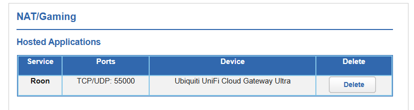

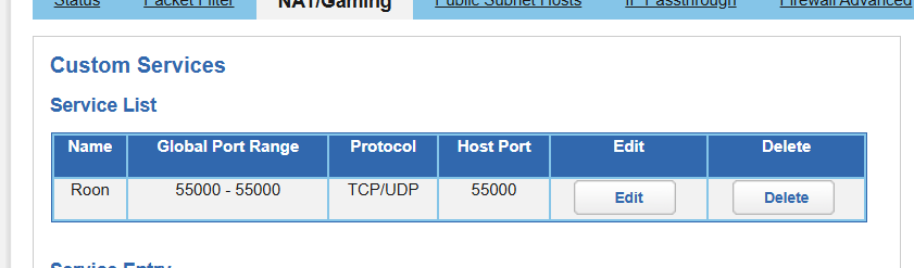

I had some challenges with getting ARC to work on my system as I have AT&T fiber optic internet couple with a Uniquiti Gateway. In order to get it to work in my setup I had to set up a custom service under GNAT/Gaming which is point TCP/UDP to port 55000:
After I set up the custom service, I told the moden to forward anything addressed to that port to my gateway. AT&T only set up the modem in my basement and everything from the house side of the modem I setup myself:
After that, I was able to open the port of my PC that is running the Roon server. I’ve had no issues with ARC in my car. For the car, CD quality is good enough for me. With using ARC in the car, I’m going to drop Apple Music when my current plan expires. Between my music collection and Tidal, I have enough options to listen to. My personal collection has about 970 albums but combined with Tidal I have over 2300 albums to listen to now. If I like something enough, I’ll purchase and download from Qobuz. I’m currently in my Roon trial subscription and am opting for lifetime subscription once my trial is up.
didn’t work on the original file unfortyunatly as it apparantly has more that two links. but made 2 screenshots. see attached
