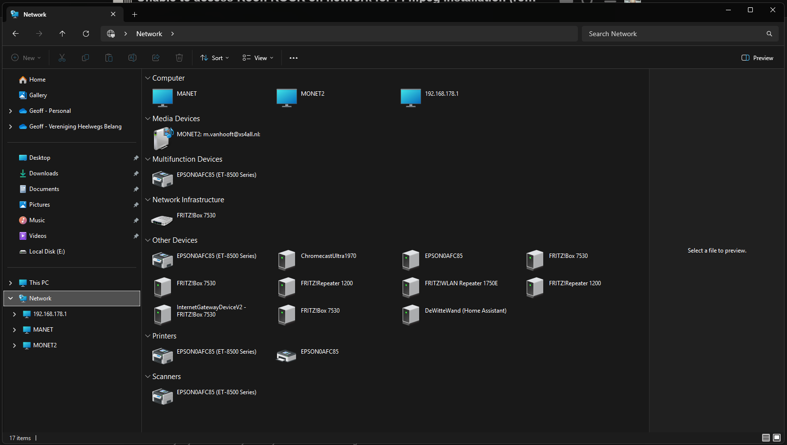

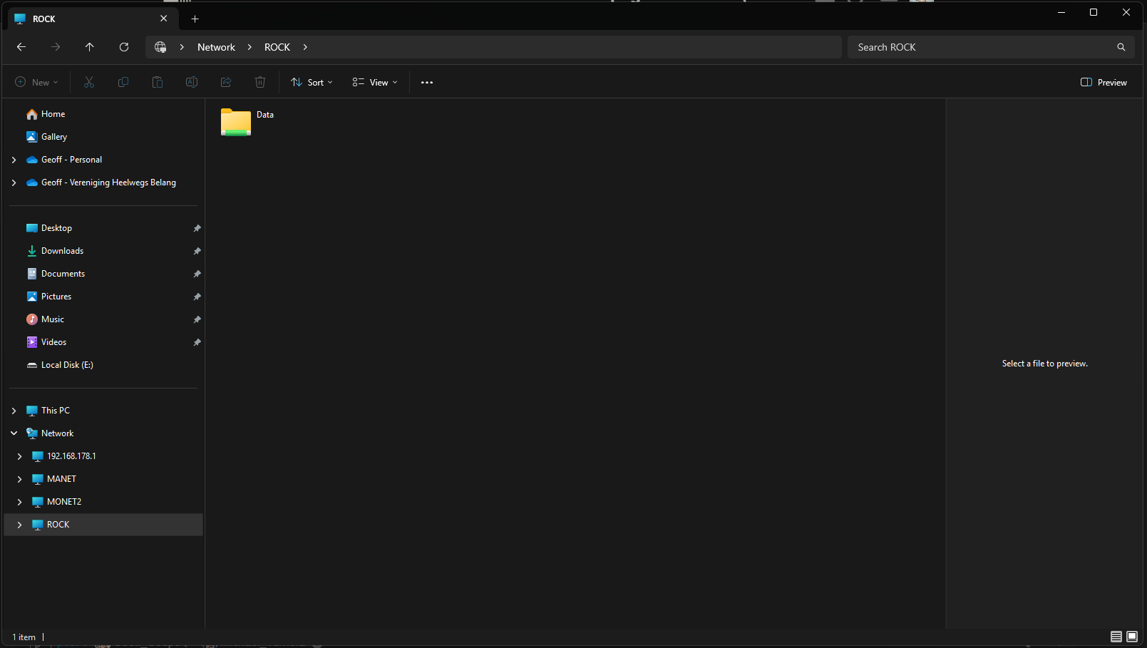

Do you mean that it is not visible in the Network section of Windows File Explorer? If so, see this post:
\ROCK\Data\ in “Add a network location” didn’t work; \ROCK\Data\ in “Map network drive” did. Being able to get help no matter where you are from people with the necessary expertise who are willing to share their time and knowledge no matter where they are is an extraordinary thing which should never be under-appreciated. Thank you very much.
There should be an error message giving more detail in it. Can you share that with us?
I don’t remember the error message (seen a lot of them today). I just tried to reproduce it but “Add a network location” worked this time. I’m guessing because either (a) there was a typo when I tried it earlier or (b) the location was successfully mapped earlier via “Map network drive”. Sorry I can’t be of more help
