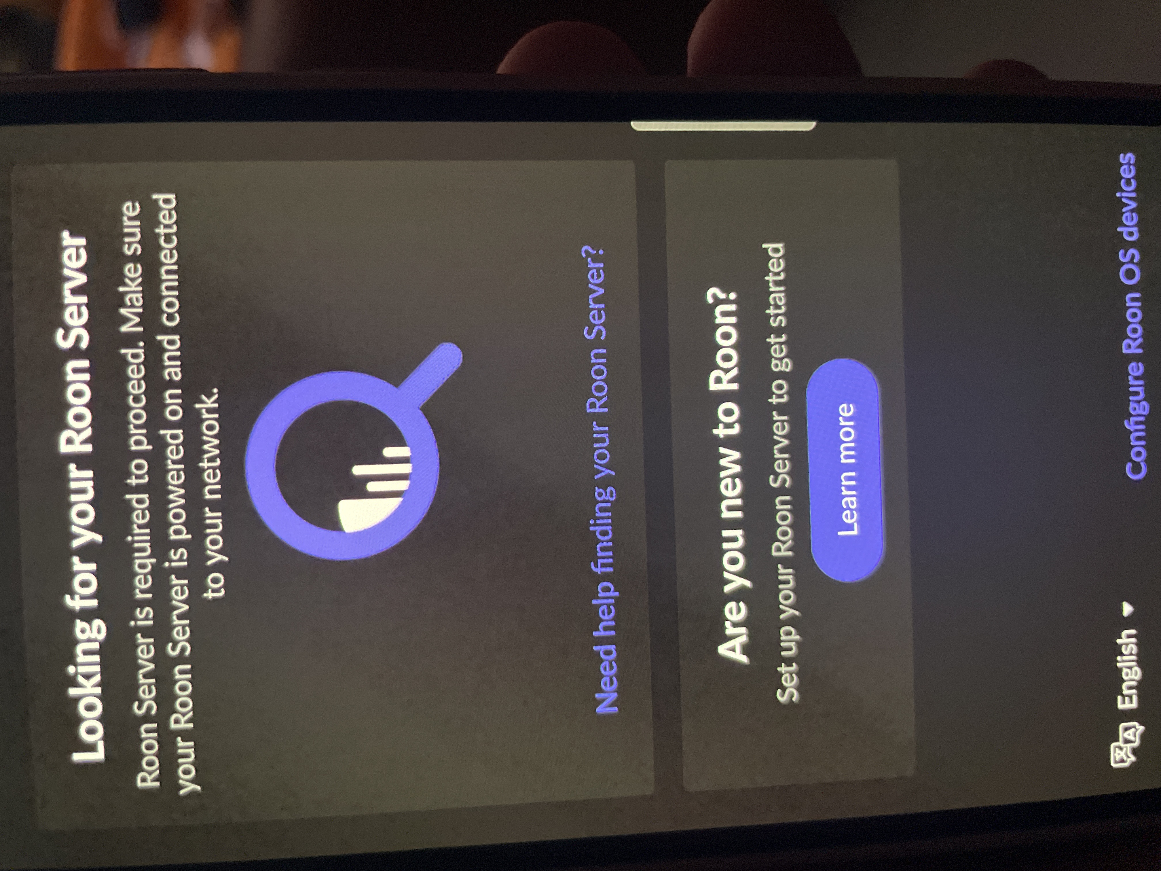

· I'm having trouble with my Nucleus hardware
Cannot access my Roon nucleus server

As a next step, lets reset the network settings on the Nucleus. Steps to follow below:
  1. Connect the Nucleus to a monitor or TV via HDMI.
  2. Connect a USB keyboard to the Nucleus.
  3. Power on the Nucleus and let it boot.
  4. Press ENTER
  5. Type resetnetwork
  6. Press ENTER
  7. Take a photo of what are you seeing on the screen and upload it here.
Let me know if you’re able to connect afterward. Thanks! :+1:
