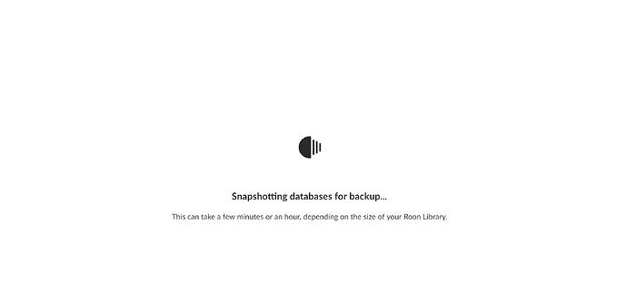

Thanks. It’s a bit baffling because I had no issues at all until the random airplay intervention. In other words, I’ve succesfully used the DAP as an endpoint until this issue. And now I have this ongoing issue with ‘Snapshotting Data bases’ which has been going on all day. I;m a very frustrated roon user after a very positive initial response. Roon is a convenient luxury and I’m now exasperated with it. It shouldn’t be costing time and effort for it to function and I am now just using Tidal so Roon is becoming redundant and I am not going to renew my subscription.

It doesn’t look like your database is all that large, so it certainly shouldn’t be taking that long. Before any next steps, do you have a recently saved Roon backup available?
If so, we can proceed with additional troubleshooting, I’d hate for you to lose your library edits and saved settings in the case of not having any backups available.
First, I’d close Roon and restart the Mac again - the backup attempting to be made will likely fail, but if you have one recently saved you should be fine.
From there, let us know if you’re able to access your Roon Settings>Audio and see if the M11 shows up under ‘Roon Ready’ and if so, select this as zone for playback.
We’ll be on standby for your results! :+1:
Hi - thanks for your reply. The database issue is now resolved and I can now access the roon start page on my Macbook pro. But I still have this weird airplay issue on the Macbook pro. Every time I click on a track to play, I get a screen that asks for an airplay code. I occasionally use my mac book pro speakers to play music but this is no longer possible due to this airplay code issue. See screen grab.

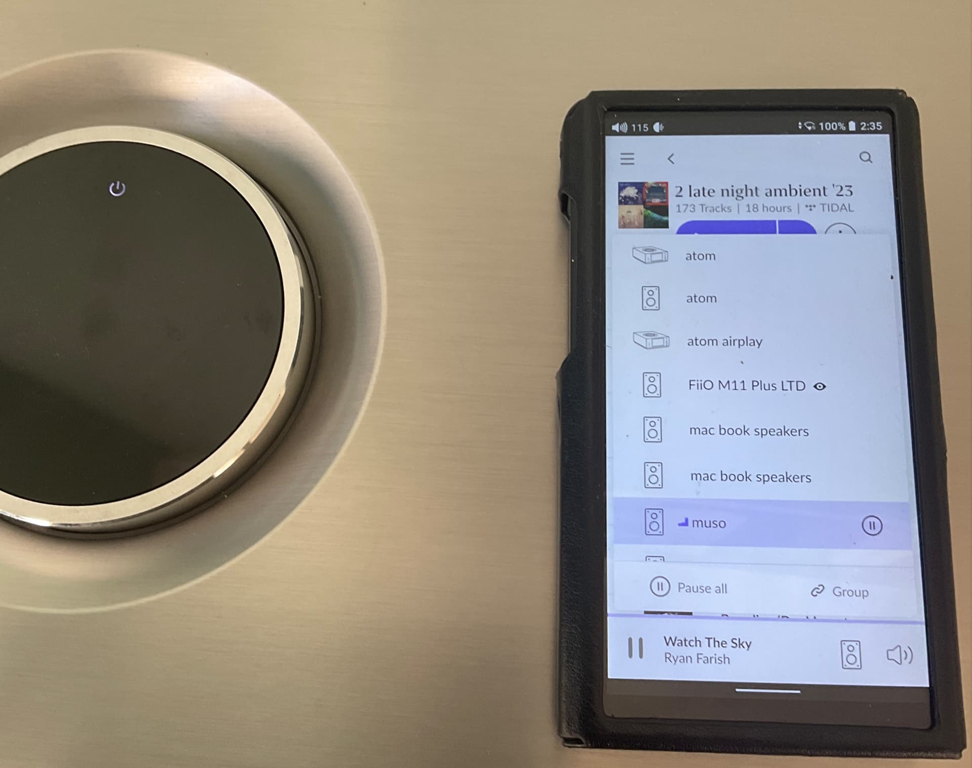

However, that has now stopped working as well. According to my Fiio, roon is playing the Muso but I hear nothing. Roon via the Fiio doesn’t activate or wake up the Muso either (it used to). See screen grab with Muso icon playing but Muso itself is not on. It makes no difference if I turn the Muso on. I still hear nothing.

Thanks again. It’s muso vs 1. But i also can’t use the fiio to operate the Naim Atom any more either which is roon ready. My main complaint here is that these are new, baffling problems. I successfully used the Muso and Atom via the Fiio Dap until recently. And then one day, it didn’t work and has never worked since. This weird airplay code issue on my MacBook is probably unrelated. But together they make Roon unusable for me.
