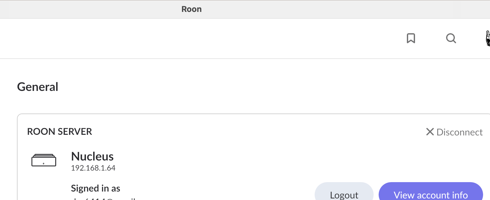

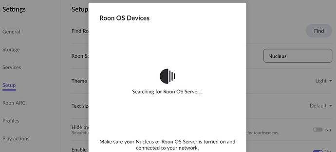

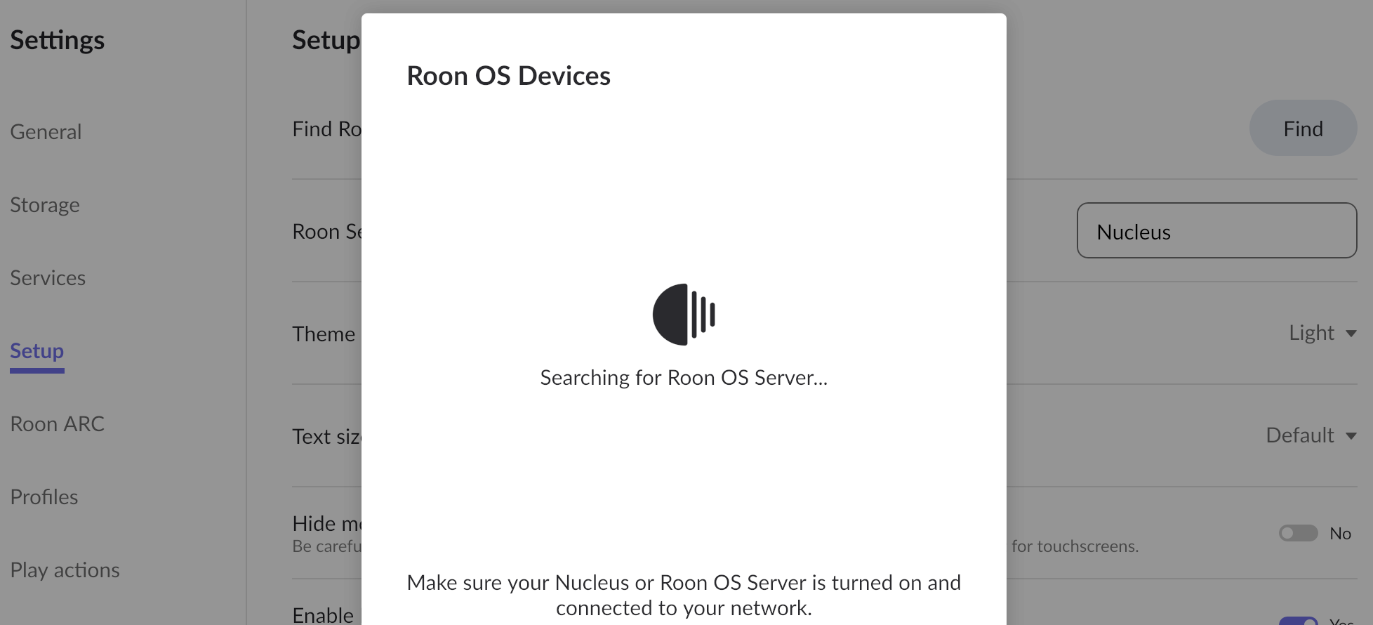

In Roon Remote under Settings - General - it shows the right address for the Nucleus. But if I go to Settings - Setup - and click Find Roon OS it does not find anything and just says it is continuing to search.

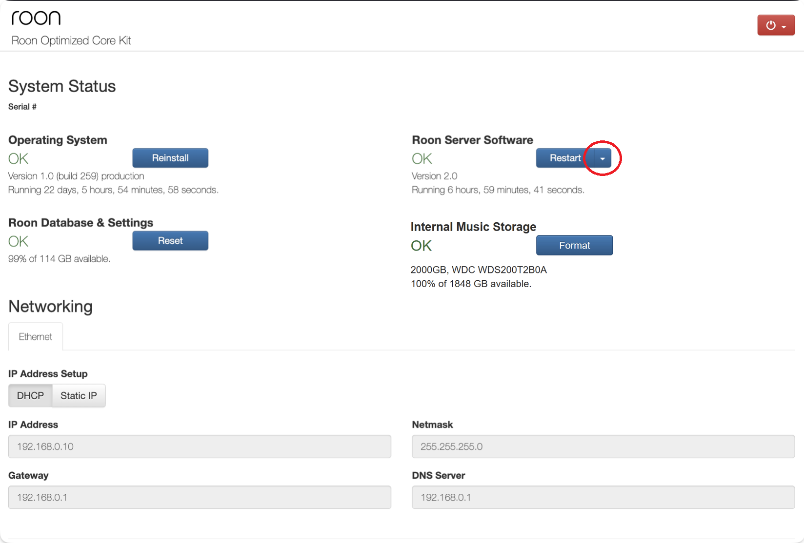

Are you sure you ‘stopped Roon Server’. That is different to ‘shutting down the NUC’.
To stop the Roon Server but leave the Nucleus powered on and working so that you can access the network share, you need to click on the little downward pointing triangle to the immediate right of the ‘Roon Server Software’ Restart button and then select ‘Stop’ from the menu that appears.
When you have finished your copy, you can restart the roon server by clicking on the ‘Roon Server Software’ Restart button.
In the meantime, if you shutdown the Nucleus, you will have to power it on using the Power Button.

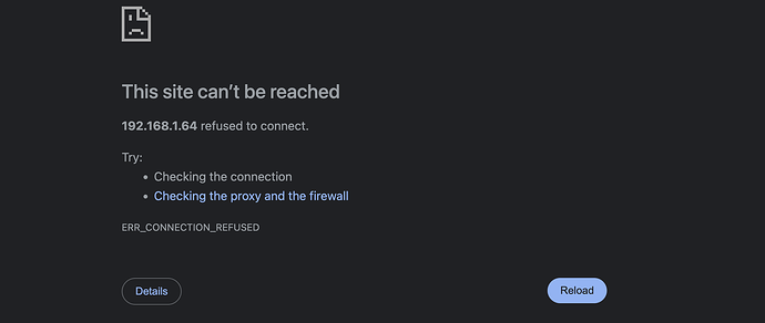

Thanks for the suggesting. I got the same message when I did http://nucleus.local.
I have not changed any firewall or proxy settings and I hesitate to change too much since the music is playing through the system and everything else looks like it is connected.
"# This site can’t be reached
192.168.1.64 refused to connect.
Try:
ERR_CONNECTION_REFUSED"
" This site can’t be reached
nucleus.local refused to connect.
Try:

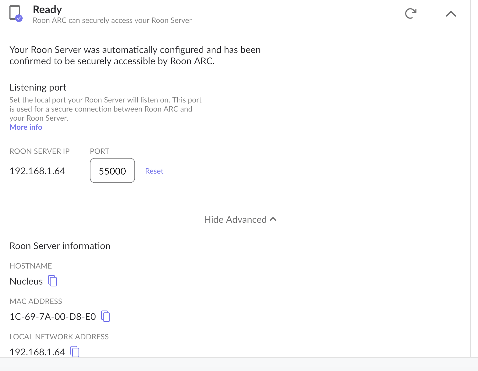

You sure your ip address for the server has not changed? If you can still use Roon what does it show as the ip address in about?
It has not changed. Under General it shows the same IP, under Roon ARC it shows it is connected to the same IP. But under Setup - Find it does not ever identify it and I can’t connect through a browser.
