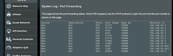

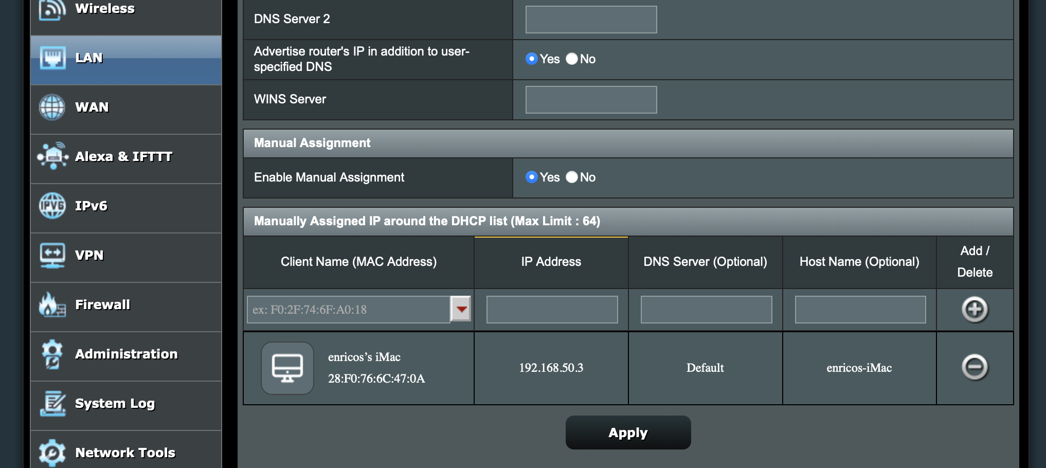

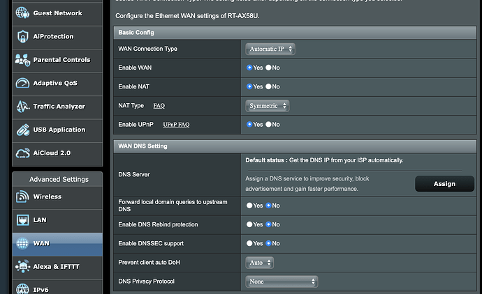

I have already switched “enable UPnP” on and off several times, unfortunately without success.
Here the error message and several screen shots:
“connectivity”: {“status”:“NetworkError”,“status_code”:504,“error”:“error: Error: ETIMEDOUT, response code: undefined, body: undefined connected? undefined”},
“external_ip”: {“actual_external_ip”:“212.aaa.bbb.ccc”,“actual_external_ipv6”:“null”,“router_external_ip”:“100.64.33.73”},
“status”: “status”: MultipleNatFound
“natpmp_autoconfig”: {“server_ip”:“192.168.50.1”,“found_natpmp”:true},
“upnp_autoconfig”: {“server_ip”:“192.168.50.1”,“found_upnp”:true}
Hi Enrico,
“MultipleNatfound” is the issue, there is more than one level of network address translation (“NAT”) going on, preventing ARC from working. Read Roon’s usual response on this below; based on what I see in your description it is most likely the second cause (Carrier-grade NAT) but I’ll copy the whole response to give the full picture:

Hi @Enrico_Solca,
Please see @Suedkiez comment above. The catch here is the MultipleNATFound line in the diagnostic message.
Do you have a modem/router in addition to the ASUS RT-AX58U you mention above? What about managed network switches?
If you don’t have two routers in your setup, then the second layer of NAT (network address translation) is quite likely at the level of your service provider. The questions posted above are worth passing on to their support team, as they may have an easy solution they can implement for your account to bypass or disable the carrier-grade NAT.
