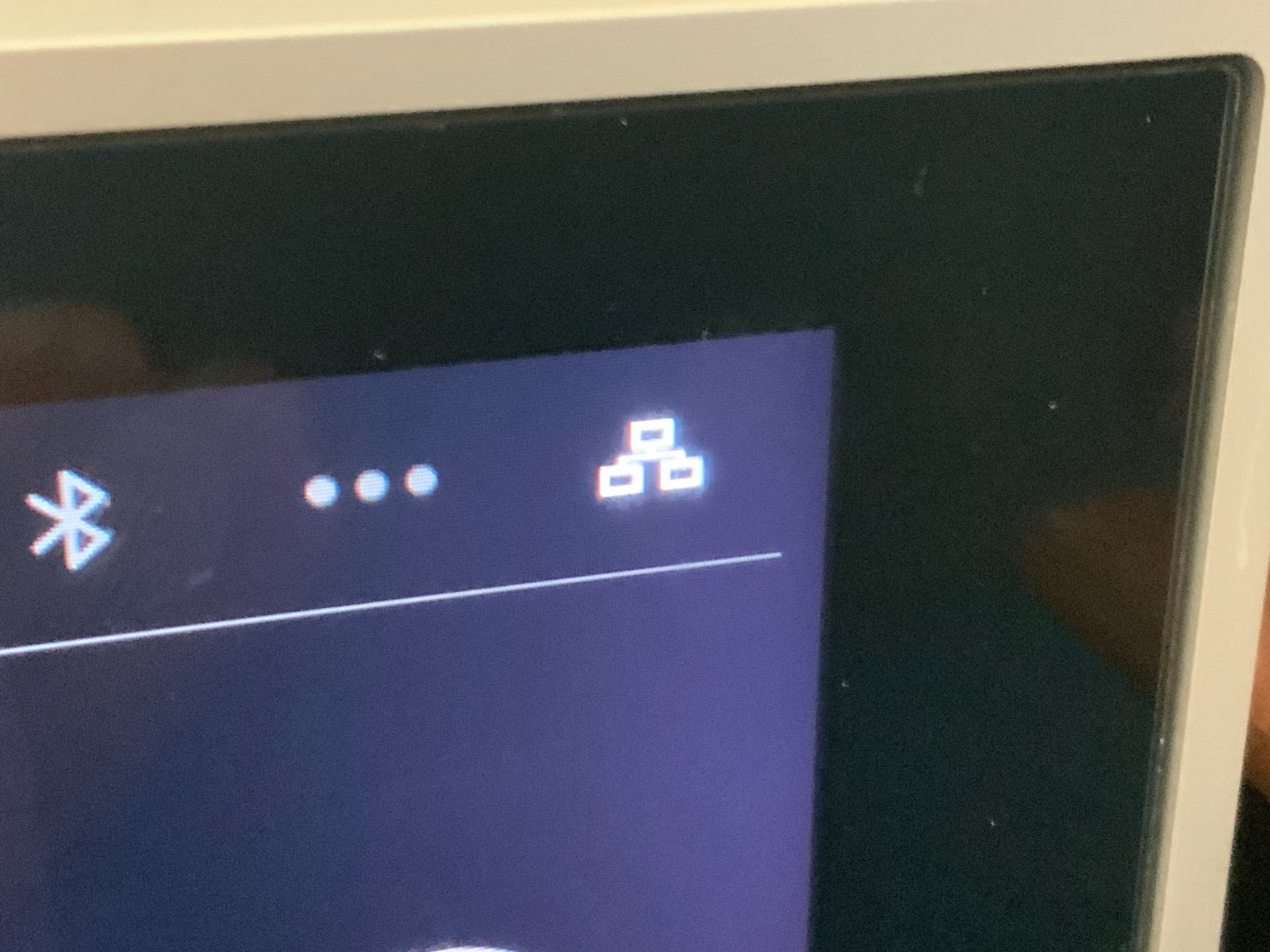

Dou you see the internet conection is on in de rose?
Yes, it is connected via the SFP connector
I ment on the rose screen you can see that there is an active internet connenction.
The 3 blocks

Checking in on this thread - can you confirm there is an active internet connection from the HiFi Rose?

Sorry for the delay in responding, but yes, the connection is active.
