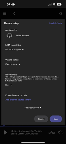

Please share a screenshot of the Device Setup for this Zone in Settings → Audio → :gear:. Is the maximum sample rate there restricted to 96KHz?

It was not set to fixed, and I did reset to defaults in roon for the device.
