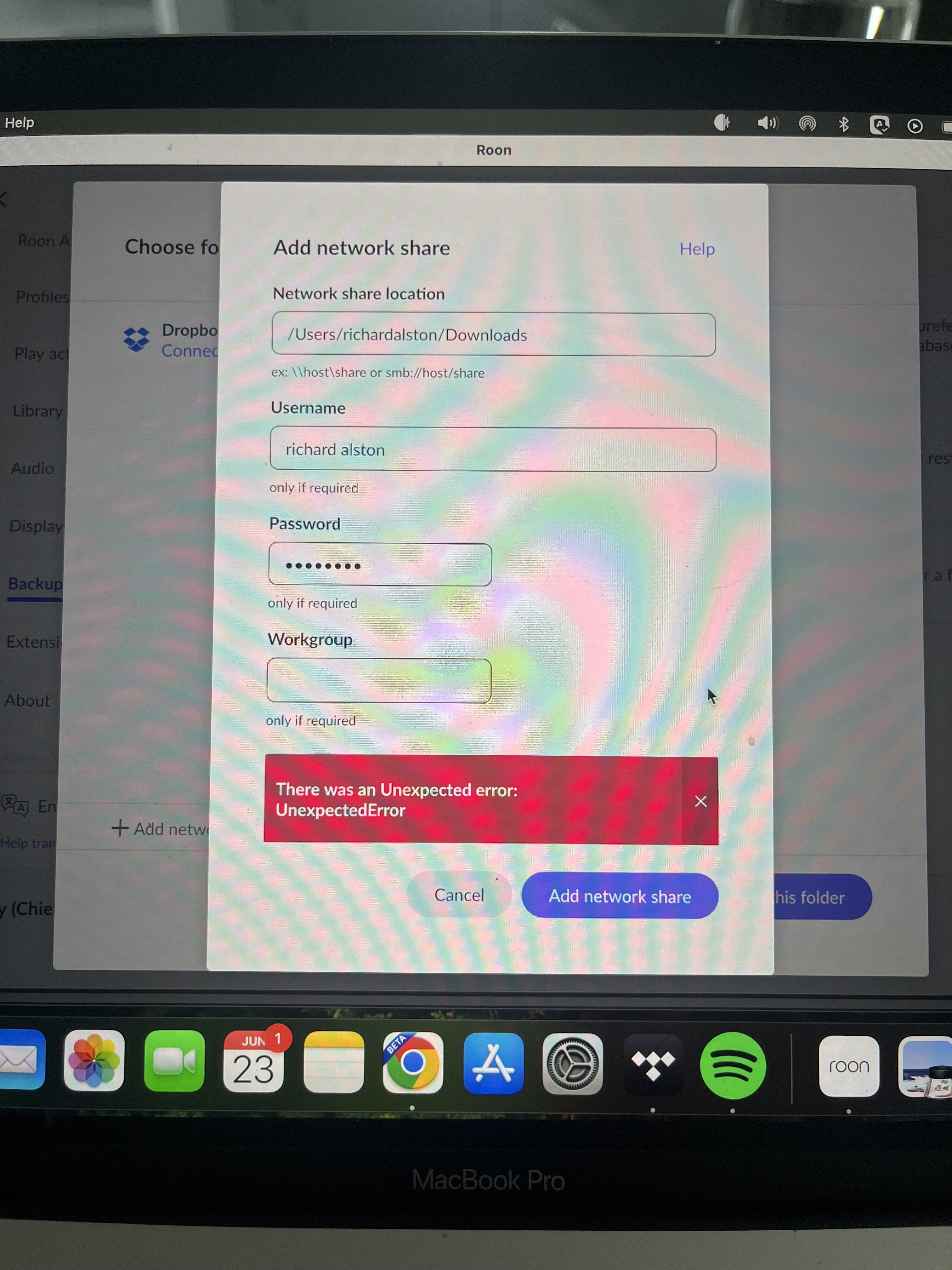

I am struggling to connect my backup and watched folders to my new Nucleus One. I have set up sharing and used Get Info to ensure the correct file name is selected. i have even tried my mac ip address.
i use a Netgear Orbi Mesh wifi that the Nucleus One is directly connected to. I previously ran my mac as the core and trying to instal the last back up to the Nucleus One as the core

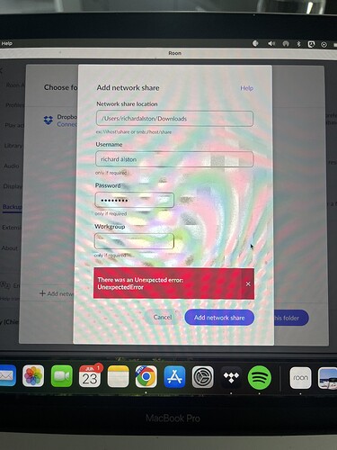

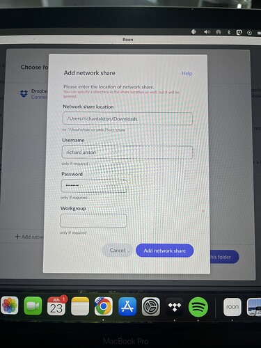

The backup is downloads not the music folder as mentioned in community threads on best practice. I have the same problem with watched folders.
Hi @richardalston,
Thanks for sharing those screenshots. They were very helpful.
It looks like the path you are using is in the wrong format and lacks the hostname or IP address. Check the example shown below

    So the path you want to use will look like this: smb://MacBook-Pro/Users/richardalston/Downloads. That said, we generally don’t recommend using your Downloads folder for music storage. Roon will scan everything in the folder, not just music files, which can lead to importing music taking much longer. Using a dedicated Music folder will provide a cleaner and more efficient setup.

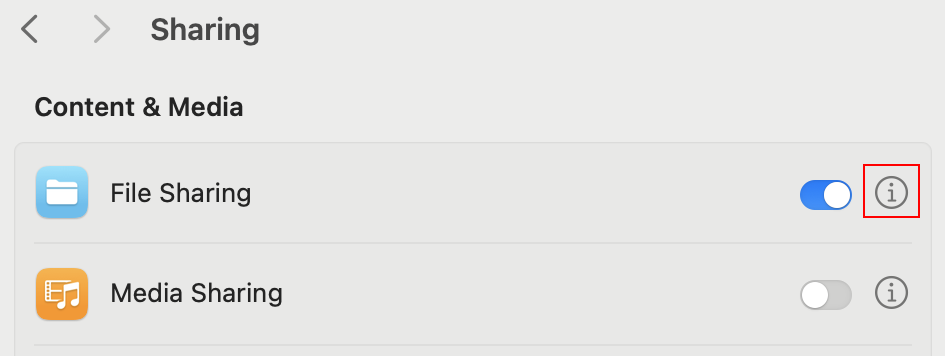

It would also be helpful to see the share settings on your Mac, just to make sure everything is configured correctly. You can find this by going into your Mac settings under System Settings → General → Sharing, then clicking the “i” icon next to File Sharing.
