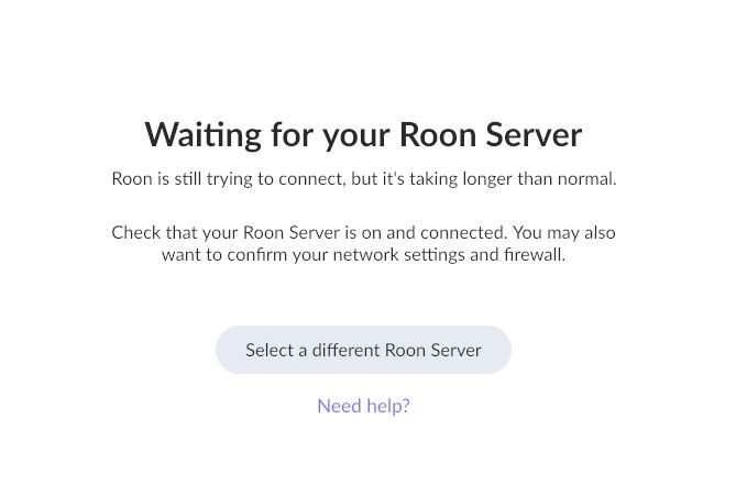

Unable to connect to Nucleus+ (ref#6JN7Q4)
Is Roon Server running?
· "Waiting for your Roon Server"
What happens if you press the "Select a different Roon Server" button?
· I see my Roon Server, but I still can't connect.
When you try to connect, what screen do you see?
· I see the Server but the Connect button is grayed out
Please try to restart your Roon Server by closing the Roon app in the taskbar or rebooting your Roon Server machine.

It looks like our servers were able to ping your Nucleus, are you still having issues? What happens if you select ‘Select a different Roon Server’? Do you see your Nucleus?

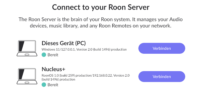

thanks for the reply. I have tried it later yesterday and roon starts again. Why – i do not know.

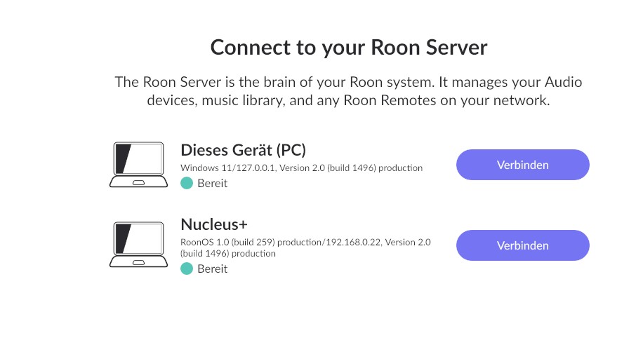

I alway saw my roon server in the strating process. First status „initilise“ and shortly after that „ready“. Pressing connect leads to the result you see on my screenshot.

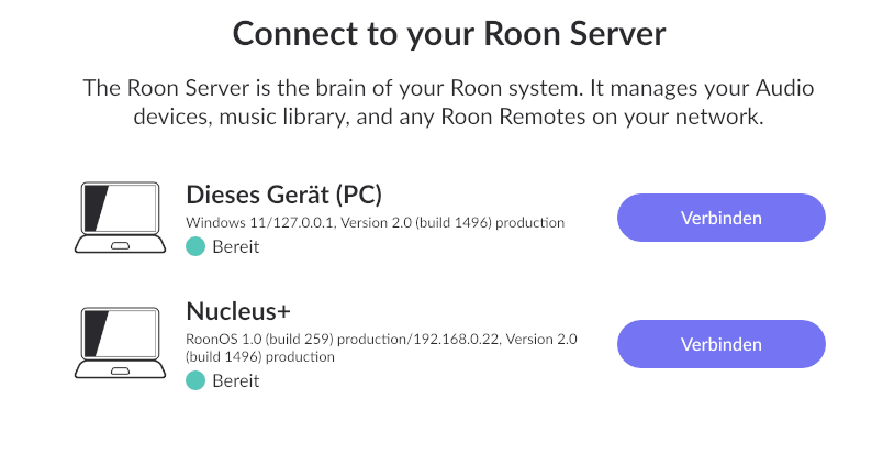

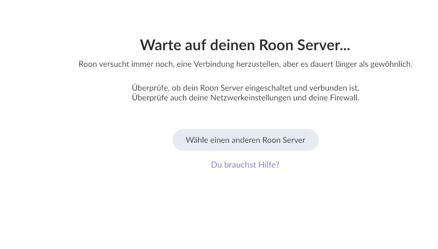

exactly the same problem todaay. at the beginning everything was fine, then i started to search for a tune. Connection lost and now impossible to get the connceting. First i pad worked, now connection via ipad also down. I got this:
and clicking “verbinden” (Connetion) i git this

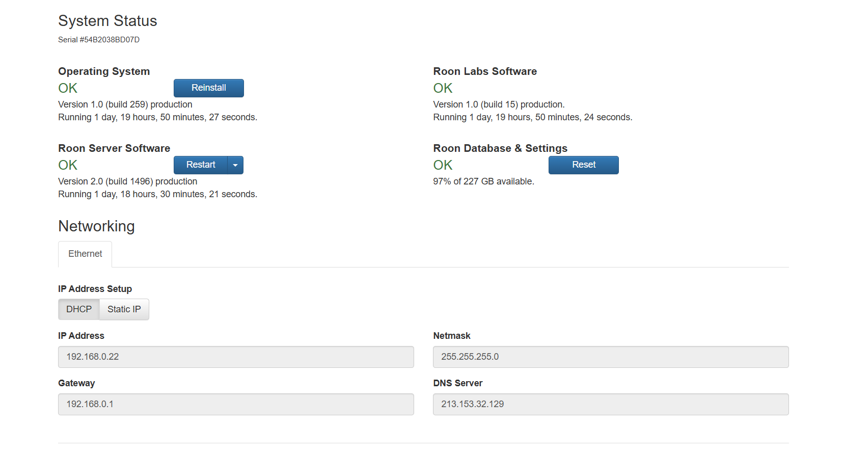

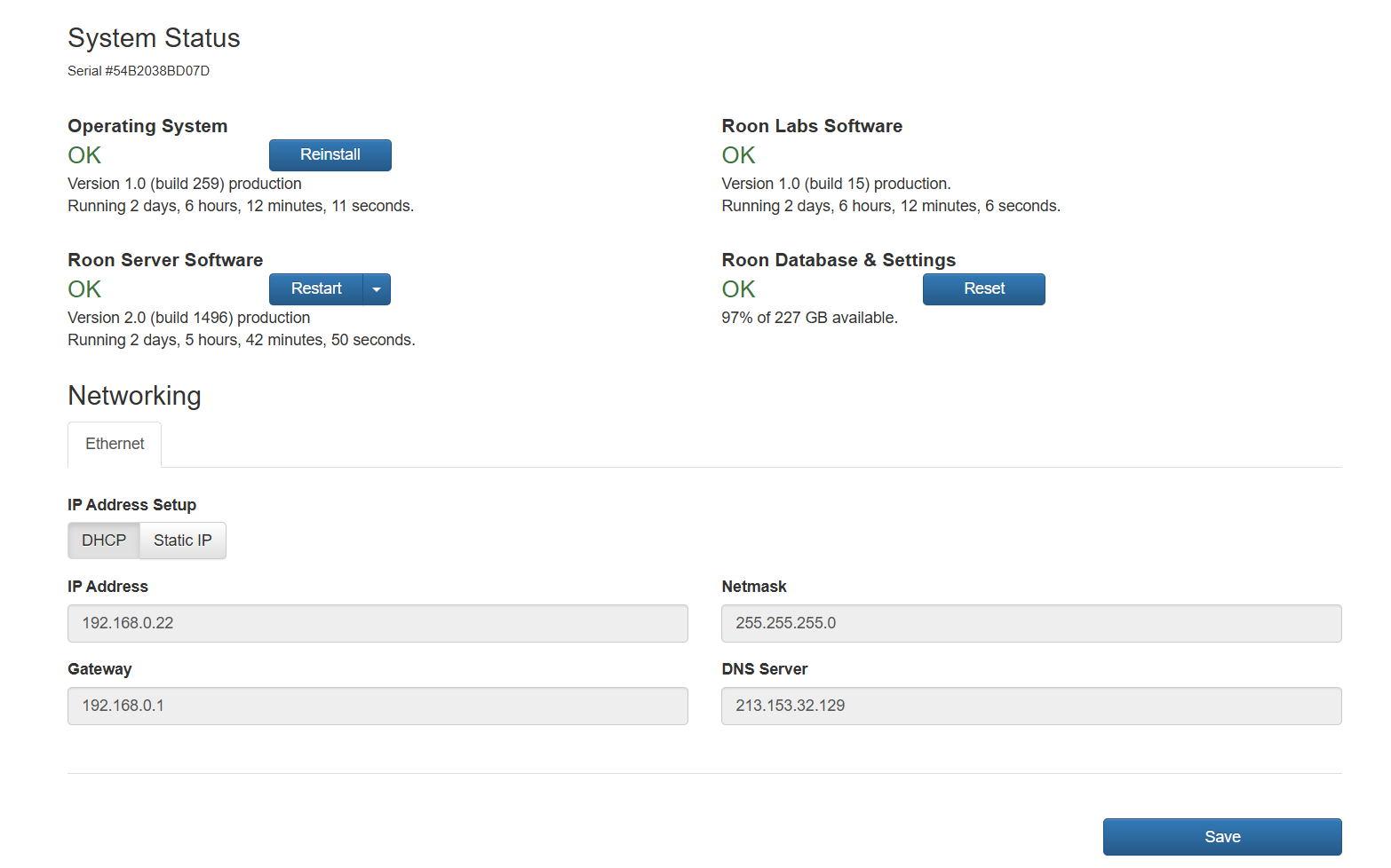

i do not know what is wrong, but in fact this is not what i expect form a pretty expensive nucleus+, The whole system is not working good anymore. i still think your software is great, but the nucleus+ and the connections are not good. I had also once a problem that there where different software versions on nuclues und on my pc. i solved this installing again. But i have installed the software on monday again on the nucleus, so this makes alos no sense. and i see the nucleus in my network:

Based on your webUI screenshot, Roon Server on your Nucleus has been running for 2 days straight, so your issue may not be related to the Nucleus, but to your remote devices failing to maintain a stable connection. Nucleus logs should help us better understand what might be going on. :slightly_smiling_face:

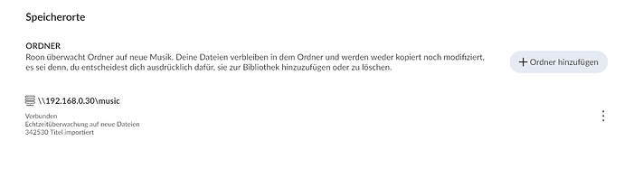

192.168.0.135 is a not valid adress for my NAS. It changed after restarting the NAS last year to 192.168.0.30. In Roon the 168 adress was shown as inactive, but it was listed, i have deleted this entry now, maybe that’s the solution for my problem.
It looks now like this:
before there was shown the other adress also, maybe roon try to reach this adress, although it was marked as invalid.

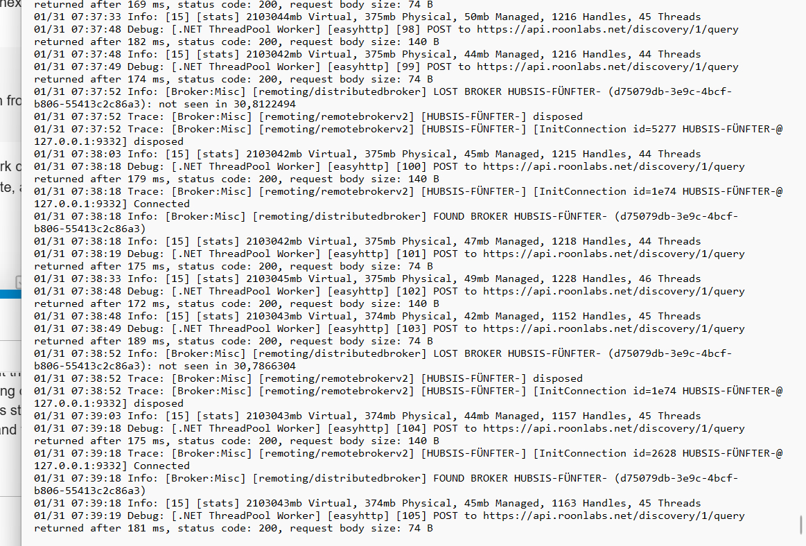

i am completly frustrated, this software was not cheap, also the nucleus+ was not cheap. i avoid using a mini-pc or whatever, becaus i thought buying the nucleus will cause no problems. i never ever had this problems before, i did not change the computer, nothing. The nucleus+ is simply not reachable. using roon arc leads to thsi message: “your roon server is online but there’s an issue that’s preveenting access”. roon and raat are allowed in norton firewall. looking on the log file (i only have one now) there is no error, i can see fail writing no rrat existing, let’s start one and than started. what i find is connect to Hubsis fünfter (my Pc), lsot connection and this is ongoing, so roon seems to run in circles, but i do nott know why:
i do not know how to find this on the ipad.
