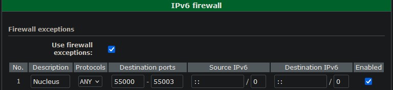

My Roon core is a Nucleus. I believe something might be wrong in my settings (especially IPv6 firewall), but not sure how to configure it. Screenshots below.

Additional pictures from the Roon remote as well as router configuration

Thanks for your message. Since you switched ISPs, it sounds like they may have installed an additional router in your setup. Are you by any chance able to set your ISP router in “Bridge Mode”? This effectively turns it into modem-only mode and let your Icotera router handle all the routing.

I actually called my ISP and we found the problem. Fastspeed automatically sets up CGNAT. They immediately offered to switch to fix IP address (for an additional 19 DKK/month), and that fixed the issue.
My former provider (Norlys + TDC fiber) did not require such option, so I suppose they still use fixed IP as a standard. Might be worth for other Danish users.
