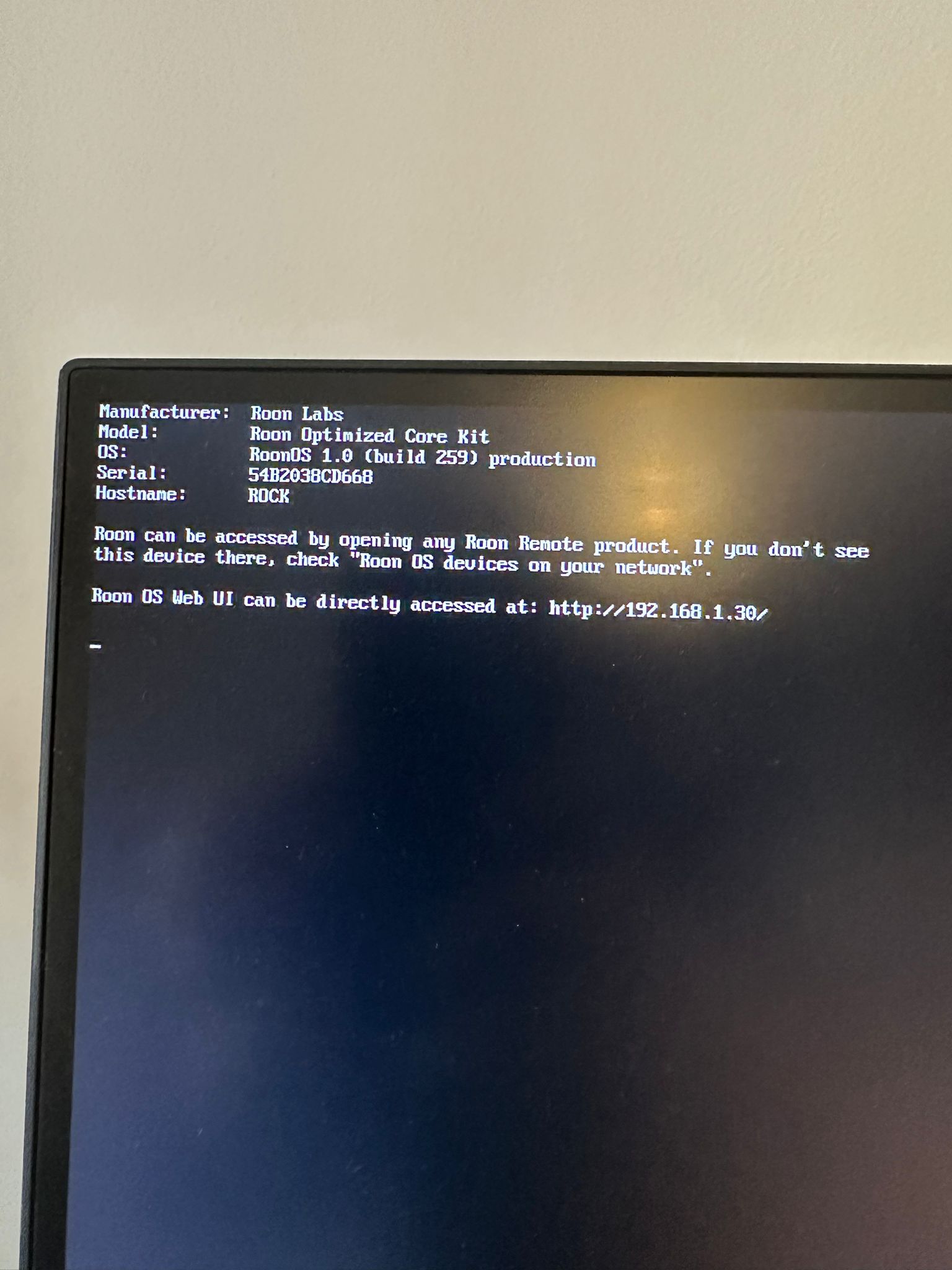

  1. Next, connect the HDMI output of the Nucleus+ to any monitor or display directly. This will automatically display a BIOS-level diagnostic report. Please take a photo of the screen and share it here.
Here is the photo. I can’t access 192.168.1.10. The connection is refused. Please advise.
Hi @Andre_Zilio,
When the connection was refused what did the message say? There are a few things that could cause your connection to be refused. Usually there be an error message that should point us in the right direction.
