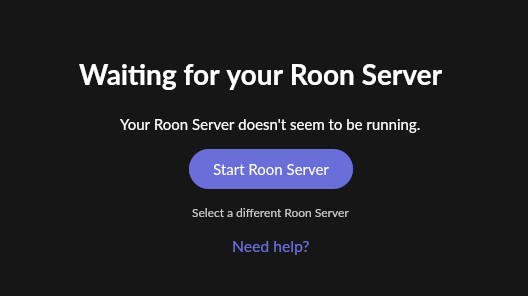

Is Roon Server running?
Roon server is not running after multiple reboots. It is set up as a start-up app. Cannot connect from any device

Sorry to hear about your connectivity issues! Based on your account admin, it looks like your Roon Server may be connecting to another subnet within your local network, which could be preventing it from being discoverable from your Roon remote.
If you bypass the extender and get a direct ethernet connection from your server to your router, does the same issue occur?
It may be good to reboot your router and see if that clears any issues up as well. Let us know the results! :raised_hands:

Sorry for the delay, I have rebooted router and modem multiple times with the same result. I am using an ethernet connection from the server to the router. I do not understand what has happened. The setup has been stable for years and now all of a sudden it does not connect???
What happens if you click on the “Select a different Roon Server” link?

Please let us know if you see the server under the “Select a different Roon Server” as mentioned by @Geoff_Coupe
Based on the diagnostic data enabled on your account, it appears that the Roon Server was last active more than six days ago. We haven’t received any activity traces since then.

Could you kindly confirm whether the Roon Server is currently up and running? Here are a few ways you can check:
  1. System Tray Icon (Windows): Look for the Roon icon near the clock in the bottom-right corner. If it’s running, the icon should be present.
  2. Task Manager (Windows): Press Ctrl+Shift+Esc to open Task Manager and look for RoonServer.exe under the Processes tab.

Hello and apologies, I have been offline due to travel. This issue is not resolved. When I click on the Roon app, it launches and the icon appears in the system tray. Task manager also shows that it is running however the server does not start. When clicking on the option to connect to a different Roon server, I selected “find my Roon server” and it just keeps looking, no result.
