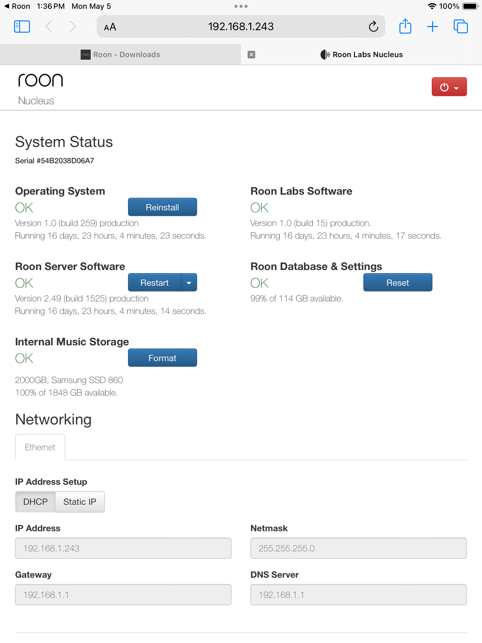

Please share a screenshot of the web administration page for this Nucleus - this should display some network information that we can use to further pinpoint any possible issue with DHCP and address assignment on this network.

Attached is the screen shot.
Hi @tatsotsos ,
Thanks for the screenshot, that looks as expected. Is it just the iPad that is having issues with connecting? I noticed that in your screenshot, the Nucleus has been running for 16 days. Can you please try to click the red power button and perform a restart/reboot of the Nucleus, and let us know if this helps re-establish the connectivity?
