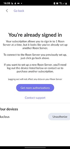

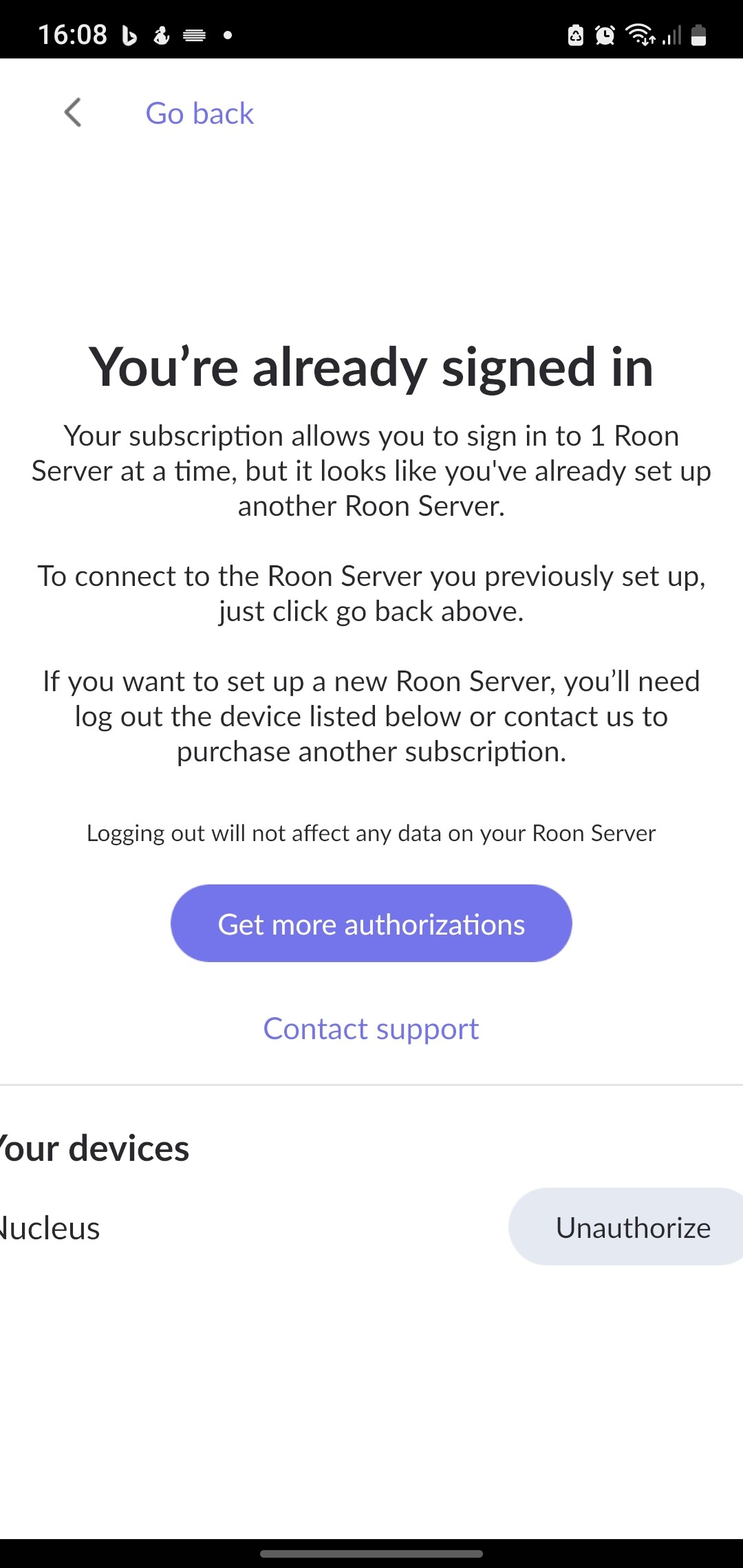

I have reset the database and settings once more to accomplish your insistent suggestion, I’ve reset again. The same way I reported before, what followed was the information that I’m already signed in and asks me either to get more authorizations or unauthorise Nucleus. Ive told you that I also had done the unauthorization, so that’s why I reported I was using the Huawei Matebook as a server.

A clear evidence of what I described
And you’ve tried clicking/touching the Unauthorize button? What happens when you do this?
Of course I did!
And I expained before that, by doing so, the PC was kept as the server…
One more time it’s clear you don’t read what is described by the customer!

So if clicking Unauthorize connected you to the Roon Server on the PC, you need to disconnect the Roon client from that server (:gear:> General > Disconnect) and then you should see both servers available on your network. Choose the Nucleus this time and let us know what happens.
