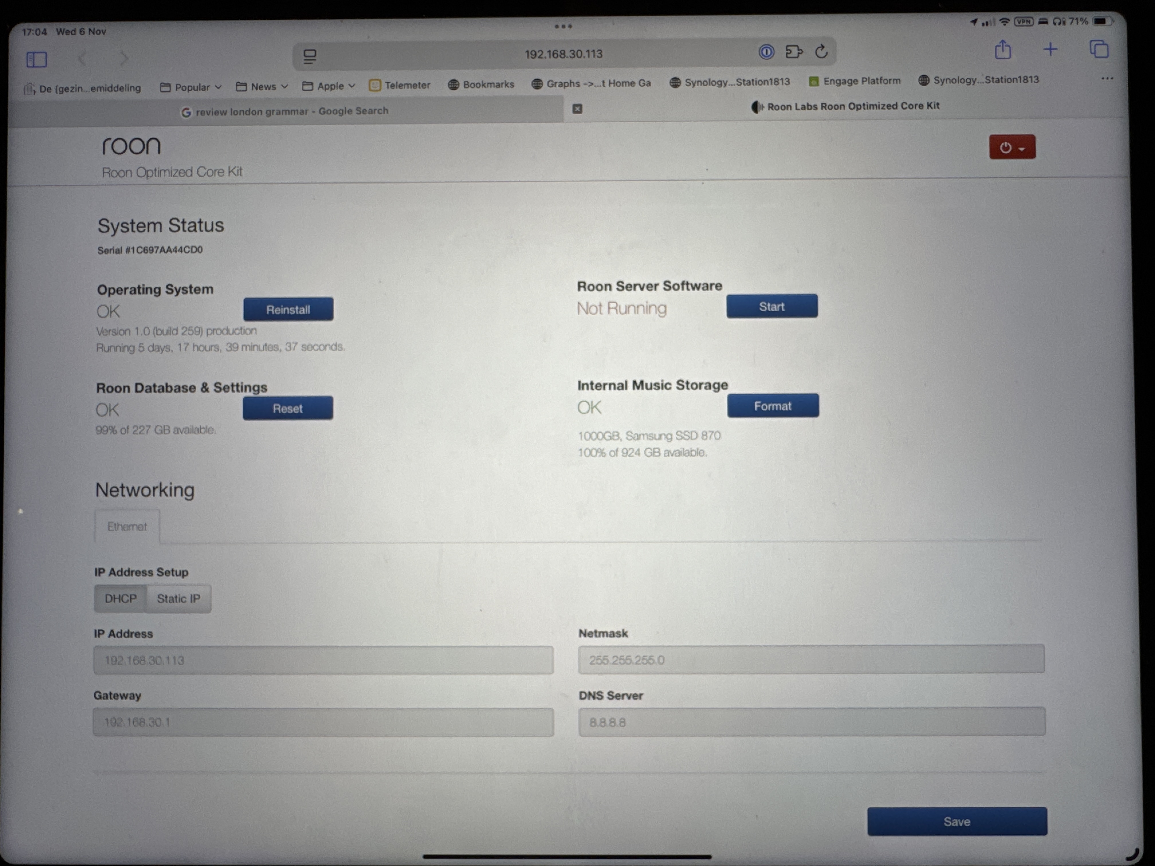

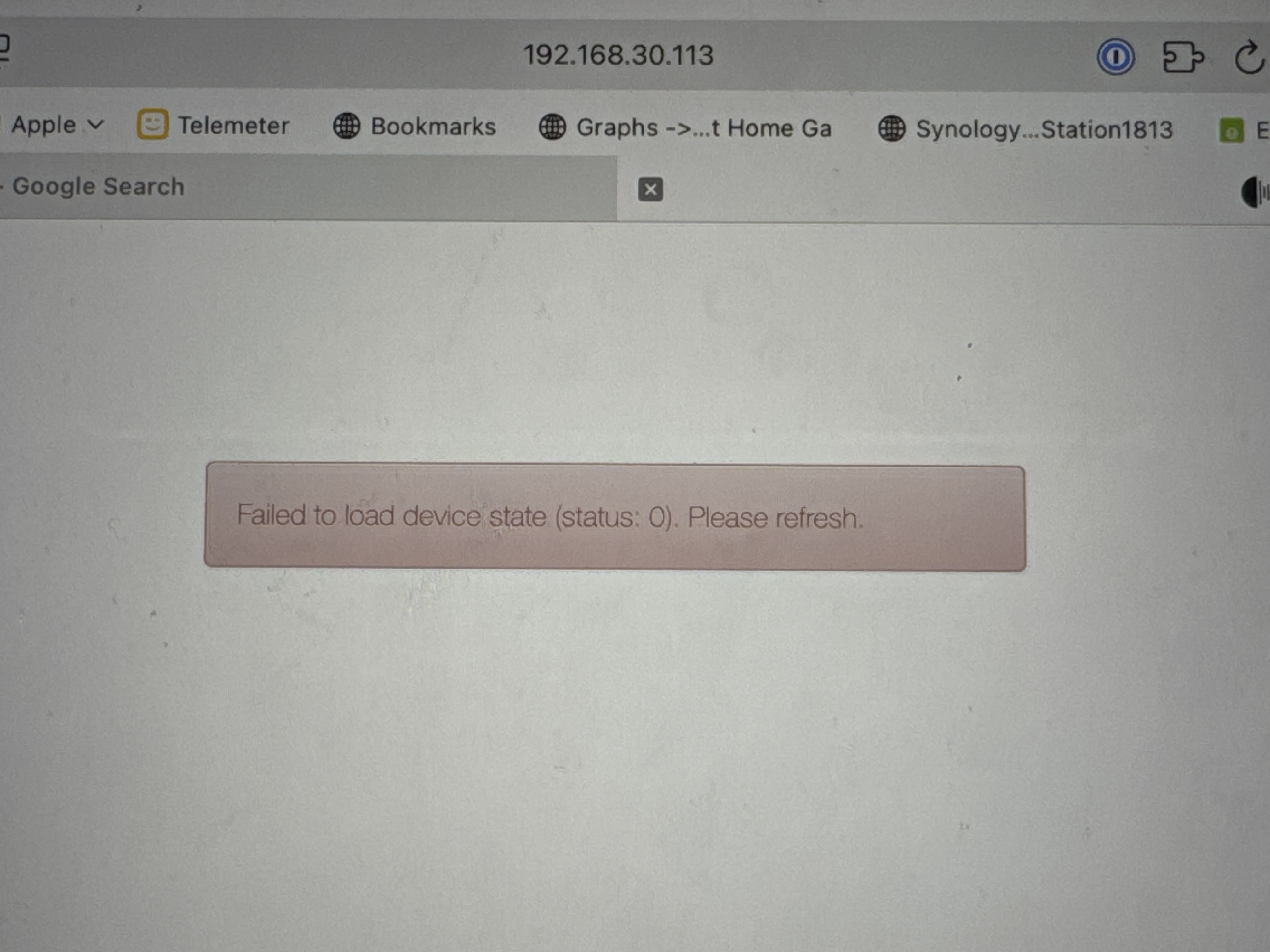

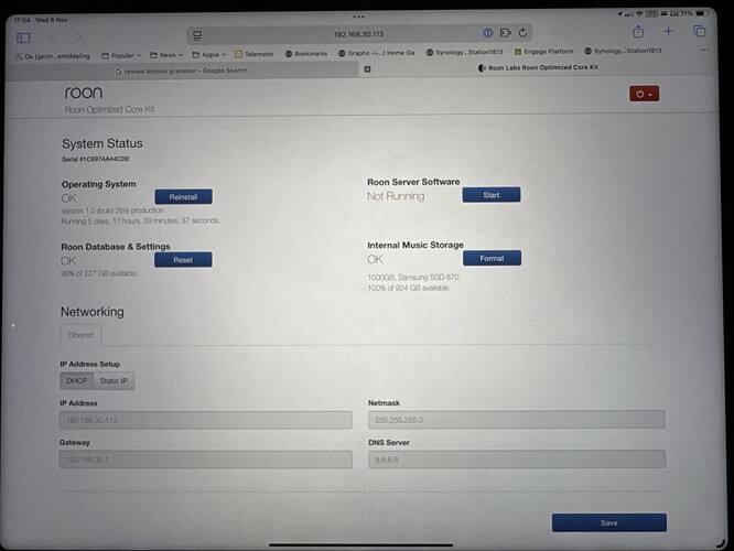

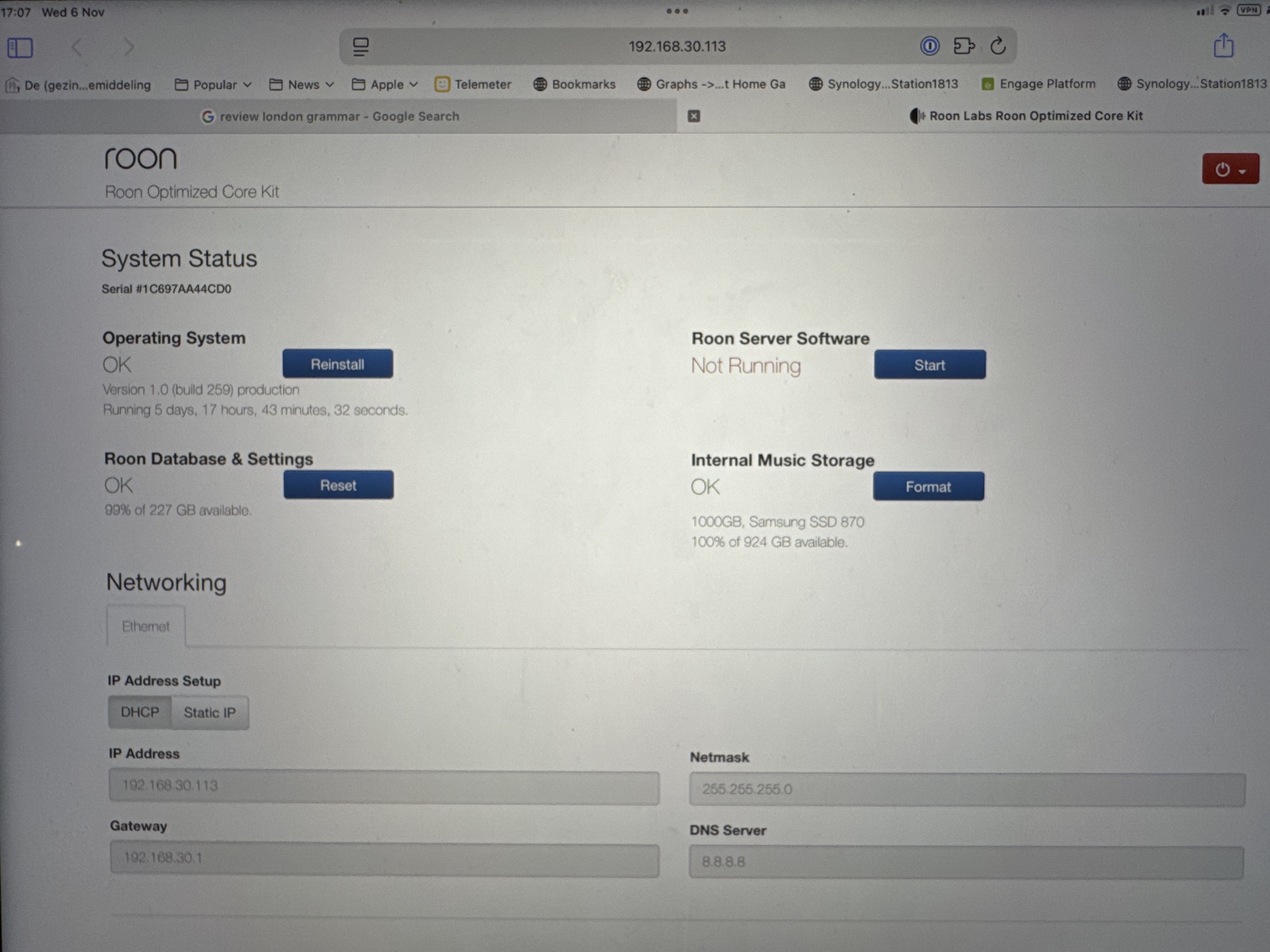

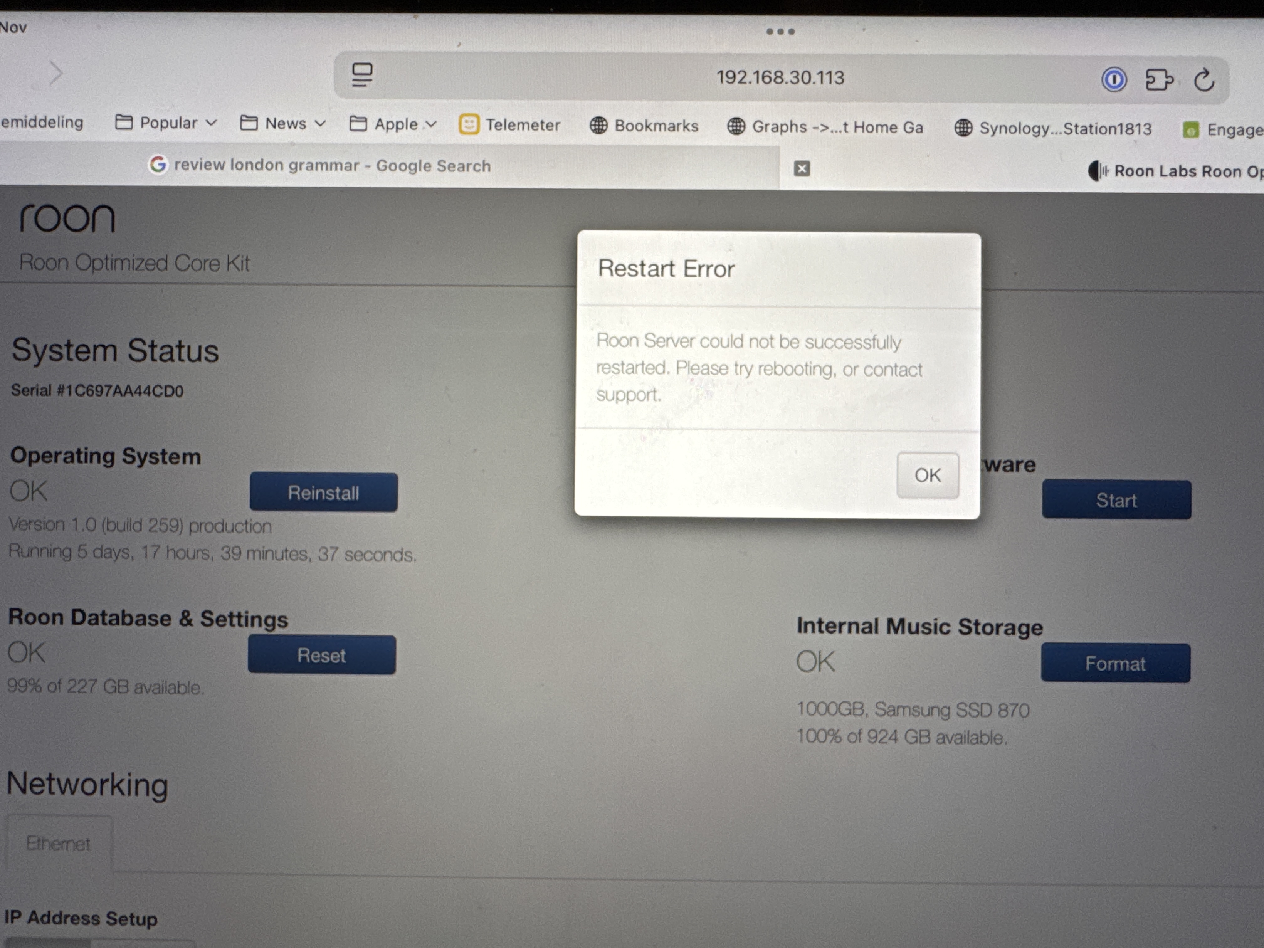

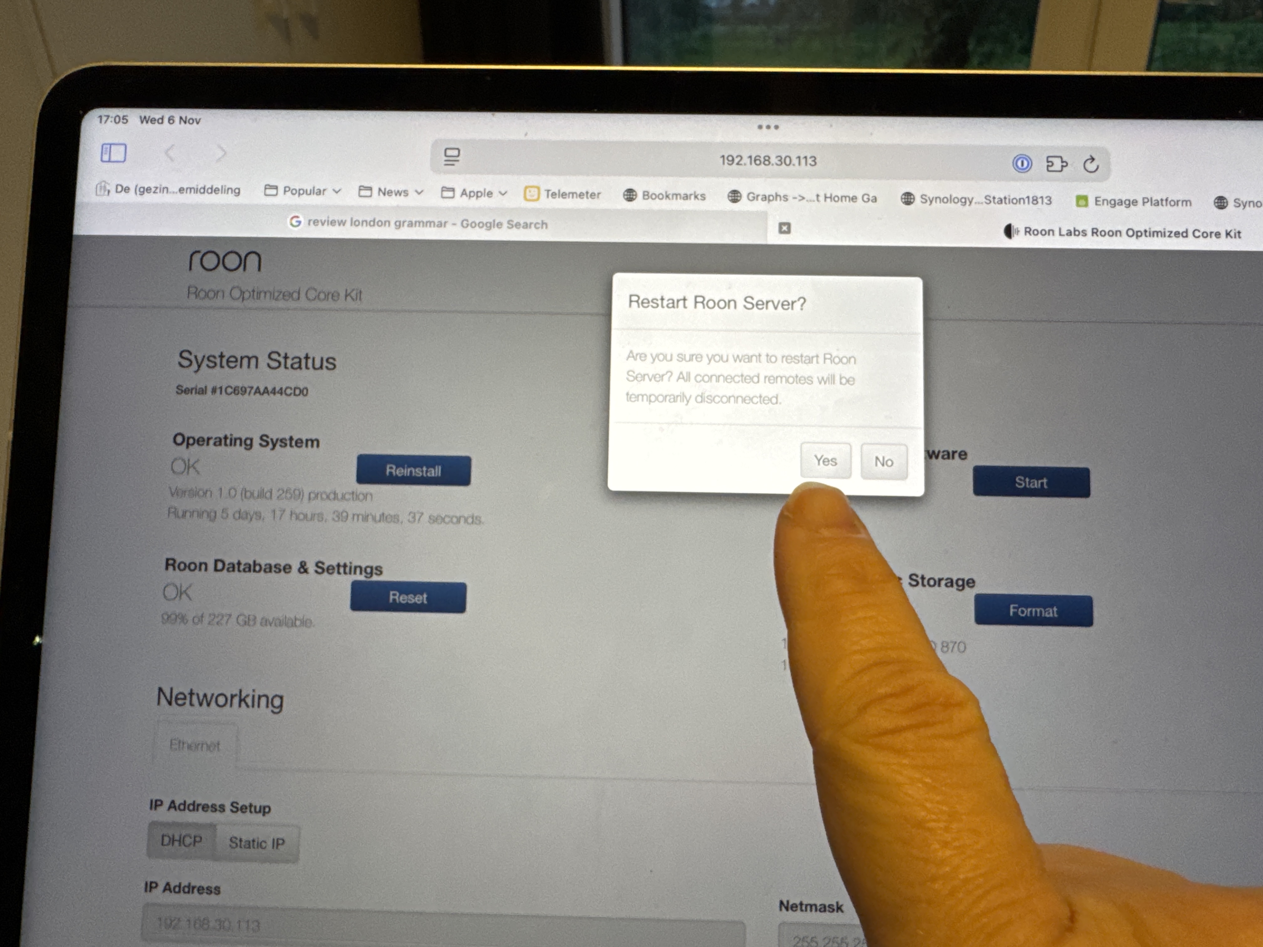

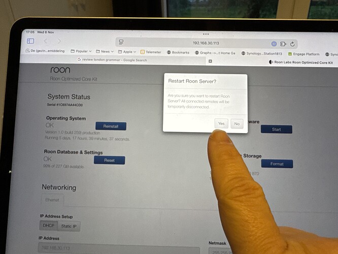

Sorry, but we’re deviating from the core problem, root cause.
I don’t have an issue with my clients to connect to the ROCK because of client issues, but because of server issues. The Roon Sever Software gives status Not Running
Below you see the sequence of observations/expériences when trying to start the Roon Server Software
Hey @Vic_Dewulf,
Thanks for the clarity here! Unfortunately, we’re still not able to review a diagnostic report from your ROCK, so we can’t see if you’re experiencing any hardware-related issues.
