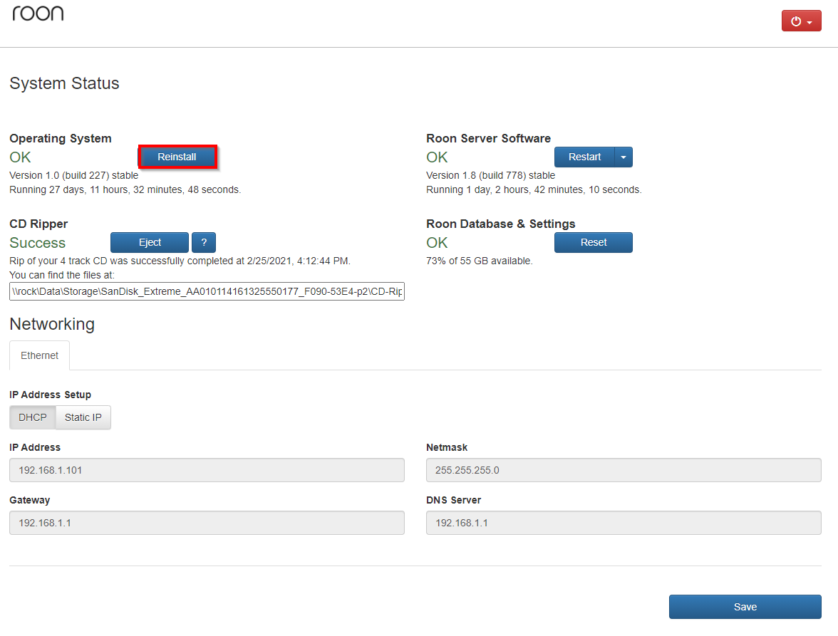

Thanks for reaching out. I’ve activated diagnostics mode for your account and what this does is upload a log set to our servers for review. Looking over this log, I do see your Roon Server is crashing unexpectedly with no errors, and the library seems to be small as well. I would suggest trying an operating system reinstall for the ROCK from the Web UI:
If this doesn’t help then you can try to create a Backup and then perform a database + settings reset and restore from the backup. Let us know how this goes!

By reinstalling Rock the problem did solved. But i don’t know what triggered the Roon server to stop. This happened after the update in the Roon app as requested at that time. I hope this will not occure again with the next update! It was something that I can’t find on the web regarding this issue from other people, so I guess it was just bad luck.
