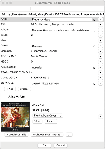

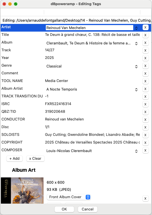

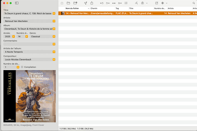

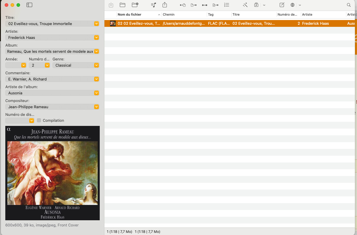

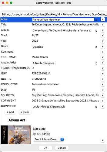

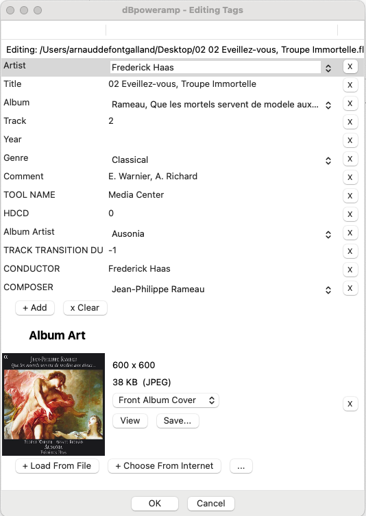

Hi, I’ve tried removing the tag from JRiver and adding it on Roon which doesn’t change anything. The files I sent did include tags, I just sent another 2 files using the same link and here are the screenshots using both mp3 Tag and dbPoweramp showing the tags that are embedded. I’m surprised how long this is taking…
