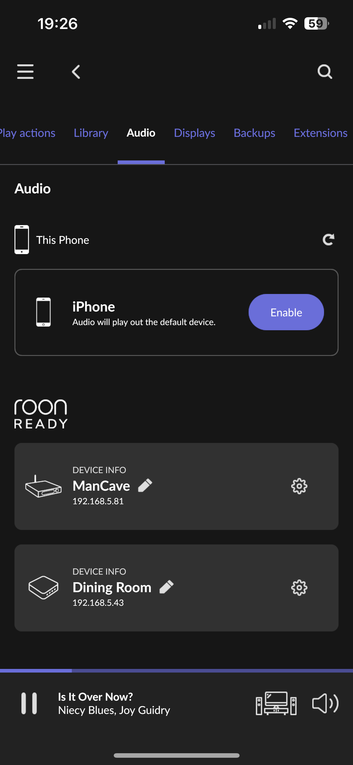

Have you checked in the audio section of settings? You have to enable Roon devices first before you can play to them?
Should show up under the Roon Ready section like my Roon Ready devices shown below

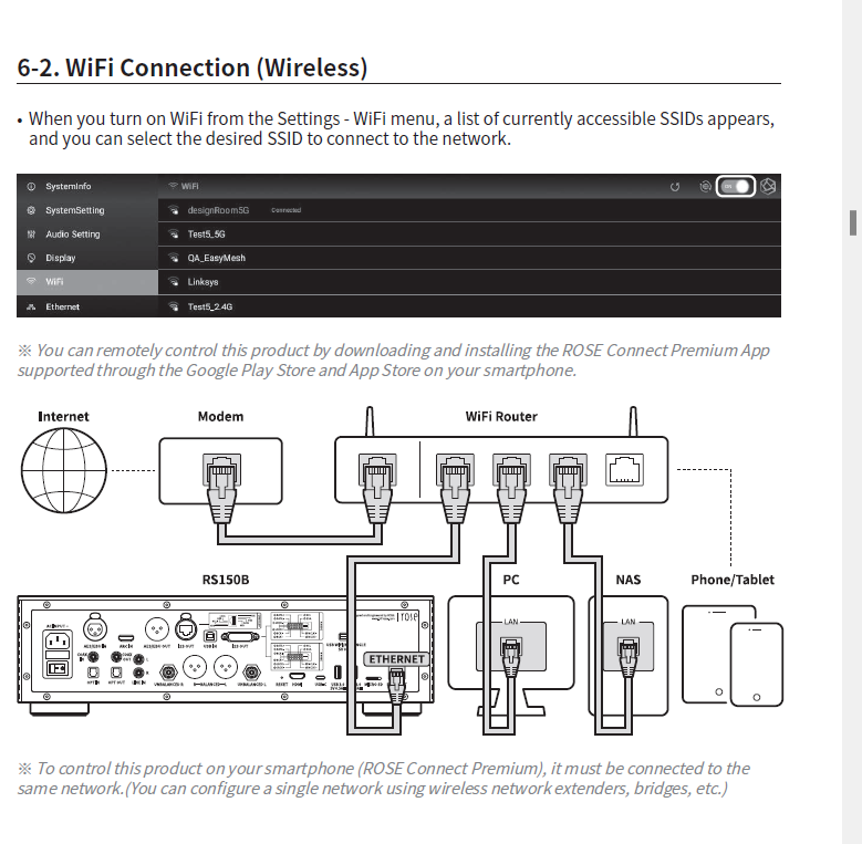

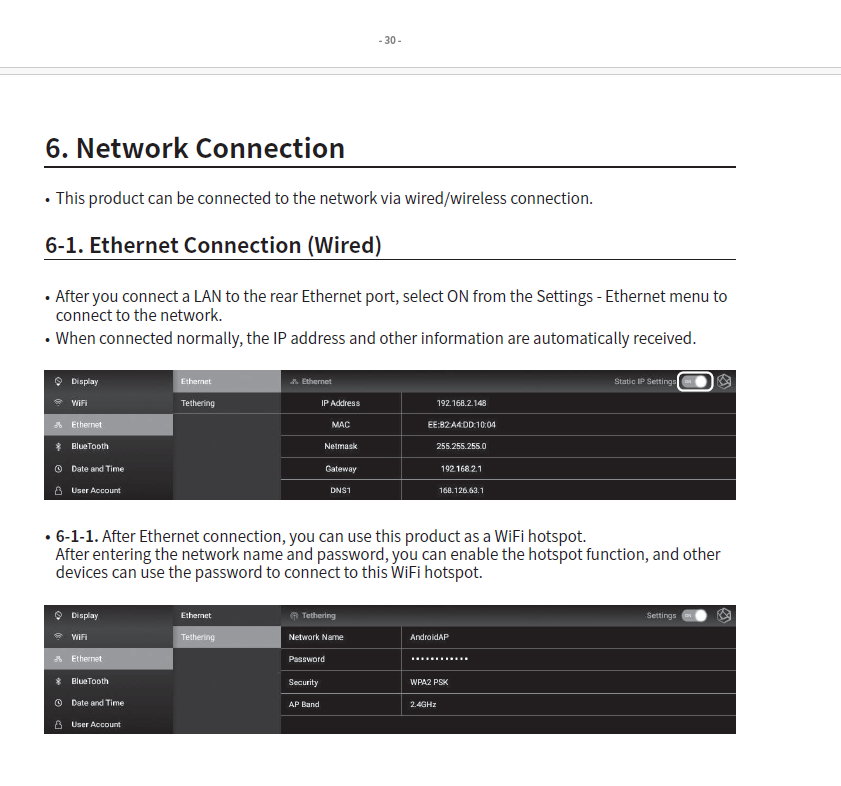

Have you enabled ethernet and/or wifi on the Rose?

Can you confirm you have enabled ethernet on the Rose as above? You do not say.

Yes Ethernet is enabled. This shouldn’t be so hard to set up. I have done everything that I can think of and the Roon app on my iPad does not recognize my rose rs150b streamer. I deleted the app and reinstalled it and still nothing. Am I the only person having these problems? Somebody somewhere please help. Thanks
