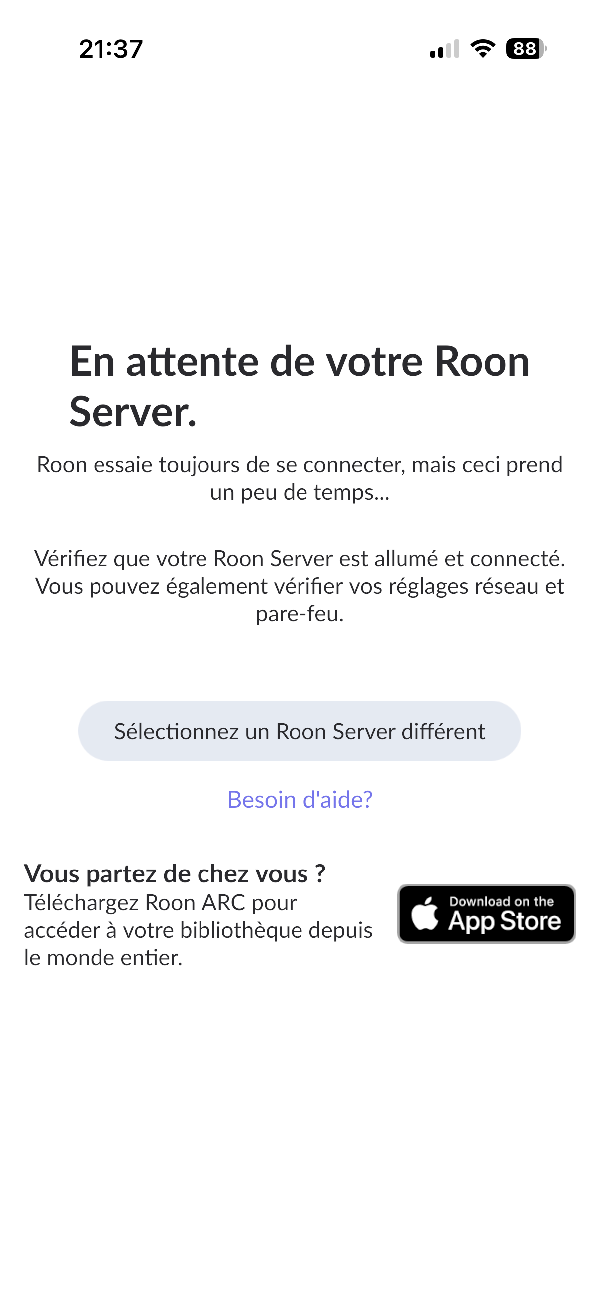

On our K30 connected to an EERA DAC, we can no longer find the server for this app via the Roon app. I've been trying to update the K30 for over an hour now, but so far without success. Is there another way to do this? Many thanks from France
On our Antipodes K30 connected to an EERA DAC, we can no longer find the server for this app via the Roon app.

What happens if you select a different server from the button visible in your screenshot? Do you see your Roon Server listed there, or nothing at all?

I haven’t tried switching ROON servers; however, I was able to listen to music using the Spotify connector. The problem is therefore clearly with the connection between the ROON app and the K30 Antipodes / EERA DAC. These two devices are connected via Ethernet.
If I understand correctly, the Roon server is installed on the Antipodes; I don’t remember exactly how I installed Roon years ago.
