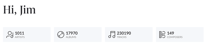

In the Roon App it shows that I have 17,970 albums. That is not correct. I would be surprised if I have 2,000 albums. Is there a way to force the system to re-read the albums?
