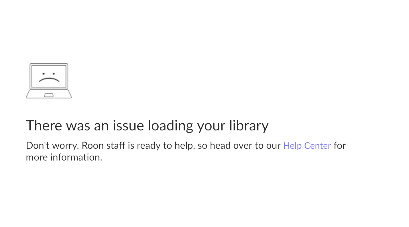

I initially got this message:
Followed by this:

The logs indicate an out of memory error being reported:
11/12 21:50:50 Critical: Library.EndMutation: System.OutOfMemoryException: Exception of type ‘System.OutOfMemoryException’ was thrown.
at System.Runtime.CompilerServices.RuntimeHelpers.AllocateUninitializedClone(Object obj)
at System.Object.MemberwiseClone()
at Sooloos.Concurrency.IdObject.MemberwiseClone()
at Sooloos.Broker.Music.LibraryTrack.Copy()
at Sooloos.Concurrency.SharedObject`2.WriteBarrier(Boolean debug)
at Sooloos.Broker.Music.LibraryTrack.OnCompute(LibraryMutationEnv env)
at Sooloos.Broker.Music.LibraryMutationEnv.Finish()
at Sooloos.Broker.Music.Library.EndMutation()

  • 10:44:32 in logs it’s queueing initial load of 469674 tracks
  • Roon endpoint shows spinner, until
  • 10:54:26 when out of memory error is listed
  • Roon endpoint shows there was an issue loading your library
    Restarted roonserver
  • Repeat of above.
